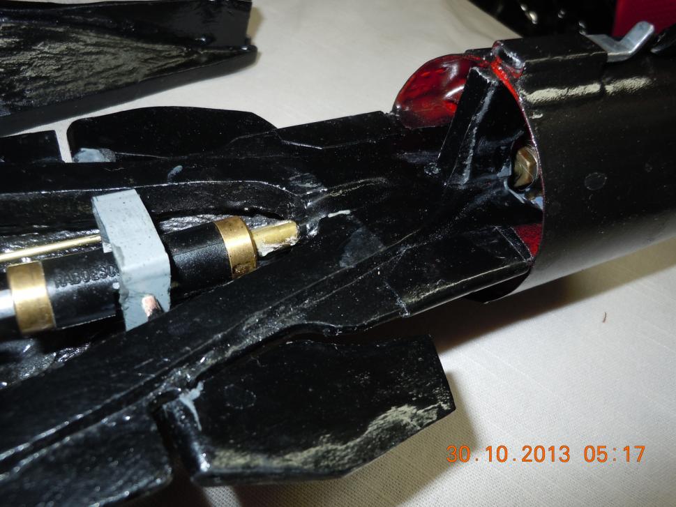

    Can you show the stern plane controls?

        yes. I will post picture. basically, the stern diving planes are on each's shaft, linked by a u shaped crank. the servo push rod is on a hole just above the pivot holes.

            Aft diving planes system
ID:	93477 The crank is aluminum sheet metal bent into a u shape. on this version, the servo rod is attached below the pivot axis. the shafts are brass tubes with studs glued at the inboard ends to use a pair of nuts to cinch the crank.
