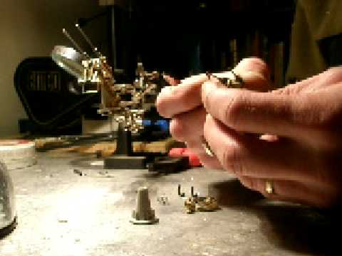

    This vid shows how I've built up the flakzwilling AA guns of my type VII, both guns still can be taken apart for maintenance or replacing parts.
    If you guys have more requests about the type VII vids, just let me know, if needed i can post more.

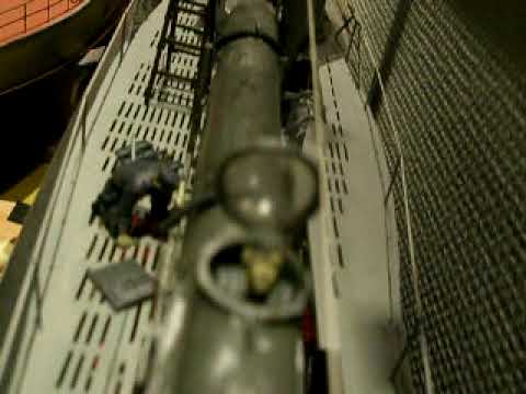

      You know what, i'll post all the vids i have about the type VII, no matter which part i was working on, i suppose it's better to group them here instead scattered on Youtube
      This one is a oldy, one of the first i posted on the Tube, i was a bit shy at that period, so no comment.
        Can't wait to see more. More stuff for me to steal! Love the anchor and snorkel mast action. This is top-of-the-line stuff, Manfred. And makes us appreciate the HD quality cameras out there now as well.

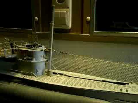

            You want motivation Von?, watch this one.

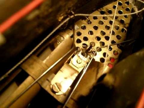

                To please the mechanical mind of you, i'll have this one, it shows what is needed to get the working shutters, it's all the same principal for all four front doors, the single rear one has a other mechanic solution.
