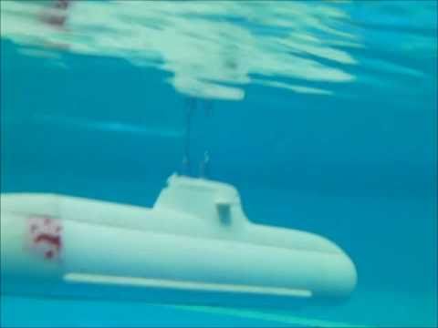

    Ramesh's new Engel 212, sans paint.

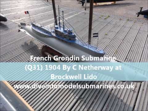

    Chris Netherways scratch built Grondin, including DIY R/C.

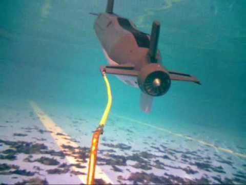

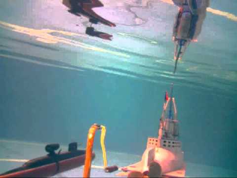

    Couple more, this time by Chris Netherway filmed from his Grondin and Vanguard class.
      Very good, i wondered how that video would look. would be good to make the trailing system more invisible
        • 2641
        I agree, although by using a thinner cord, you run the risk of it getting caught up in the prop.
          Try some 20-50lb test fishing line - almost invisible and if you attached it from the sail and on the other end attach it slightly offcenter, I think you'd fix the problem. Imagine a horse pulling a barge on the canal. They never put the line on the bow, it was set back alongside a few feet, so it steered itself away from the bank.
