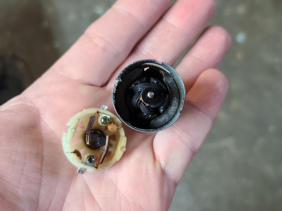

                    Looks like the winding to me.. Upon further inspection there may have been more drag on the drive shaft bushings than I realized which contributed to this failure although it wasn't like that when I put it together so still puzzled on that on that one.

                      OK. Thanks for the look-see, Steve. Yeah, carbonized armature wire insulation. seized motor no doubt. Where was the fuse, ahead or behind the ESC, and what was it rated for (and was it quick or slow pop)?

                        No shaming here. I don't use them myself.
                        But it's good practice to put a quick-acting fuse between the ESC and motor. The idea is to open the circuit before a seized motor (bad running gear or fowled propeller) pulls enough current to either fry the ESC or itself.
                        Not a bad idea at all. I will consider installing one. Is there a method for determining what size to go with? Measure the current and multiply by 1.35 for a slo-blo?
