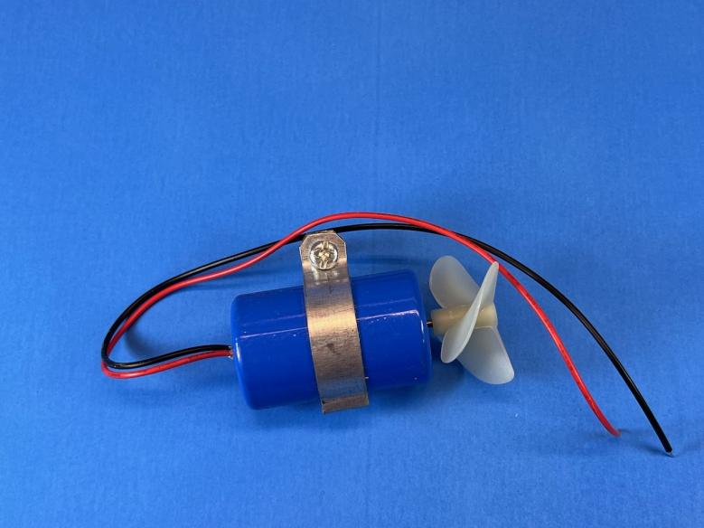

    ITEM #3 Some kind of water proof motor?

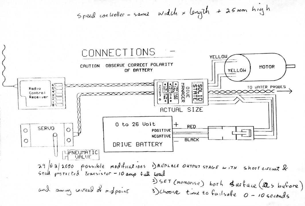

    Item 4 is a Dive Manager. These were built by Mike Stothers, who later built esc’s and levellers under the Microgyros brand name. The unit you have is designed to be used with a closed cycle compressed air ballast system of the type first developed by Nick Burge and later commercialised by Craycraft. The unit can control a compressor to draw air out of a ballast tank and compress it, and also controls a servo to operate a valve to release the compressed air back into the tank. A pair of additional wires connects to some metal probes in the tank which sense the water level and shut down the compressor before it starts ingesting water. There’s also a failsafe built in which will blow the tank if you lose the signal.
    I do have an instruction sheet for this unit.

      Item 3- you've already described it.

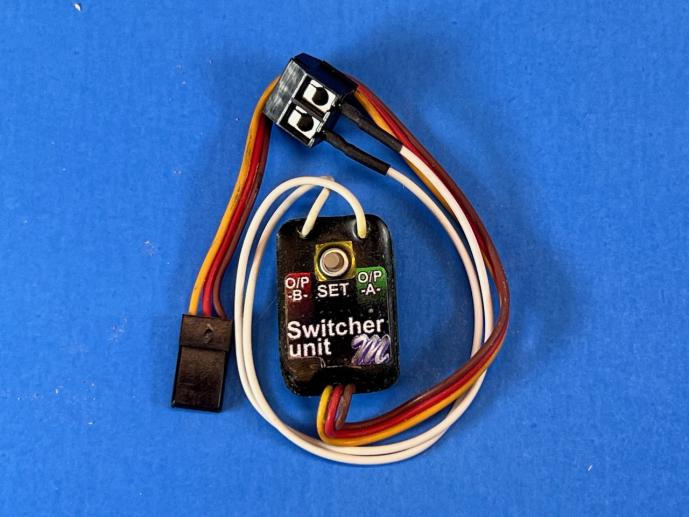

      item 5- Mtroniks switcher https://www.mtroniks.net/prod/RC-Acc...roSwitcher.htm

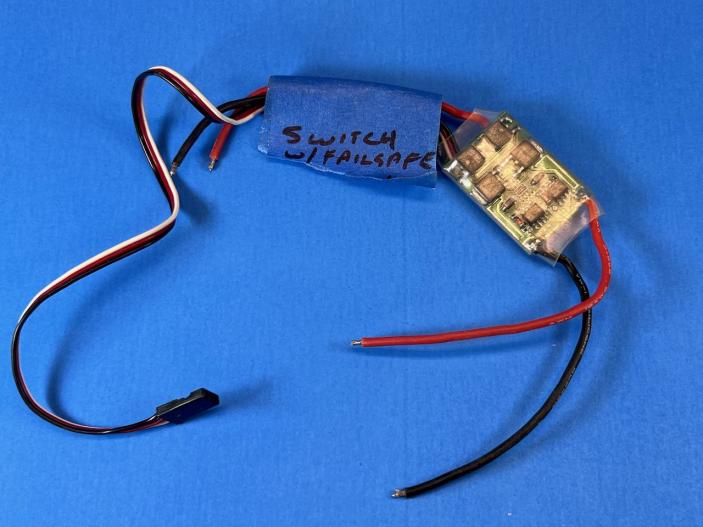

      item 7- probably an R/C switch using a relay.

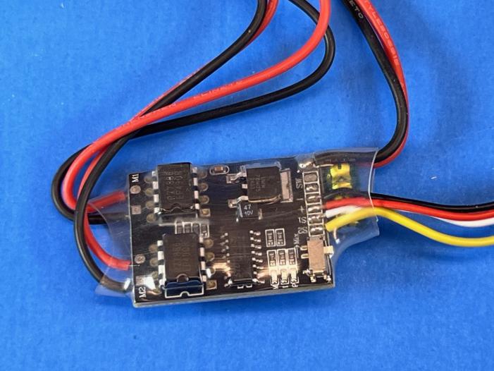

      item 8- Looks like a dual ESC most likely for a tank or a boat with twin screws.

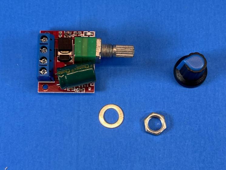

      item 9- Small manual brushed motor controller.

        #8 dual brushed motor esc Click image for larger version
