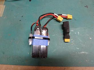

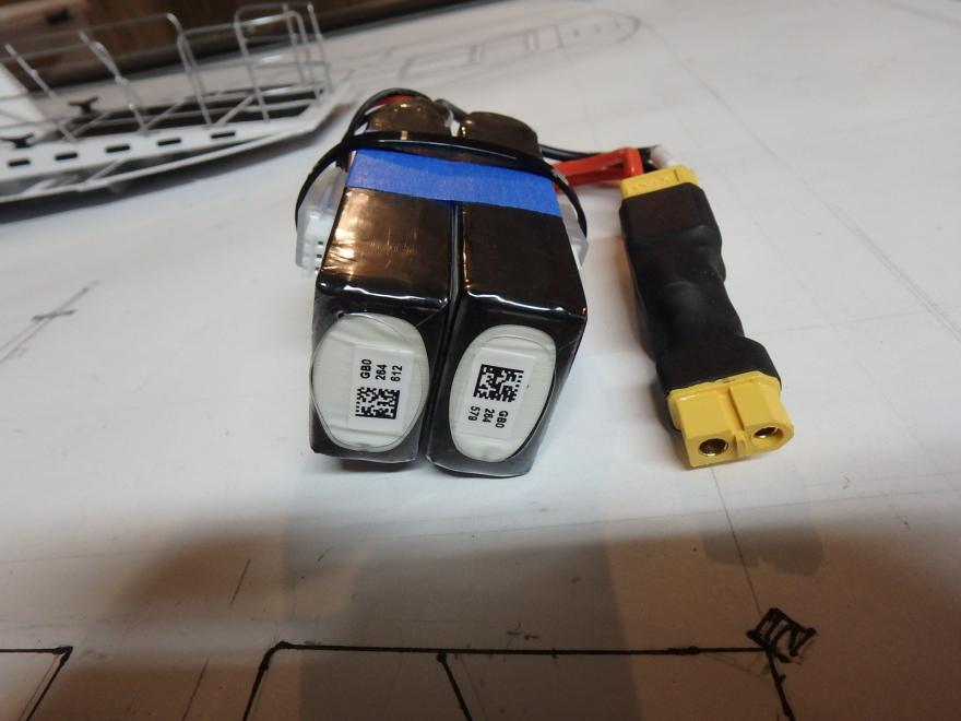

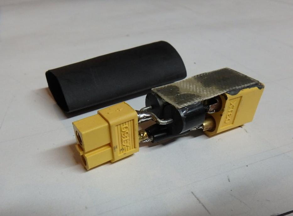

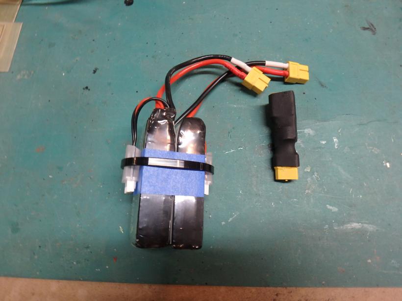

        -It will fit in the dry compartment so I am going with two parallel 2200mah lipos protected against back charging by two 15 amp Schottky diodes.
