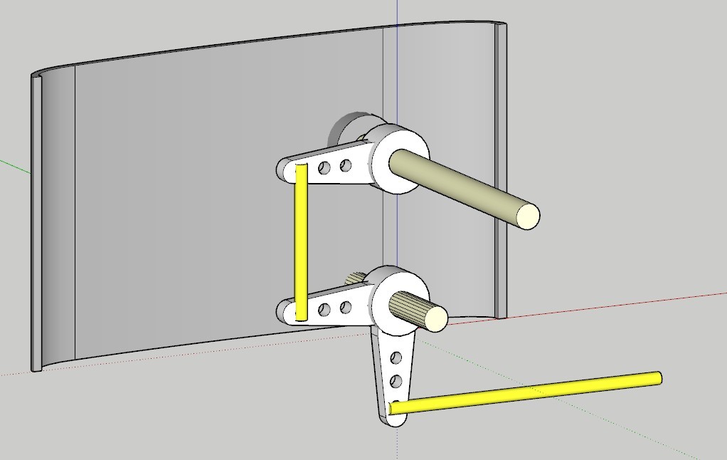

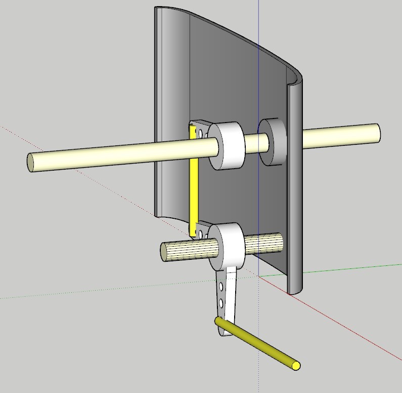

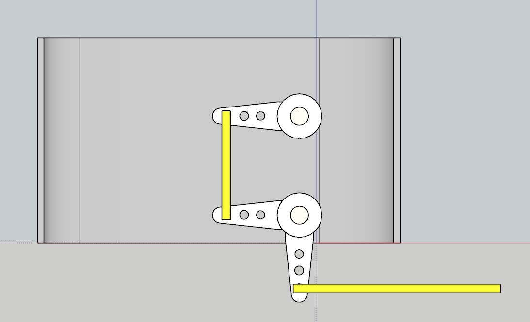

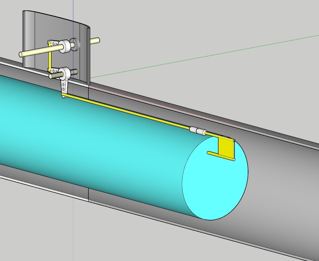

    It seems that I get repeated questions about actuating fairwater planes. I took a minute to write up a blog article about it and posted it to my site. If you have fairwaters, maybe worth reading!
