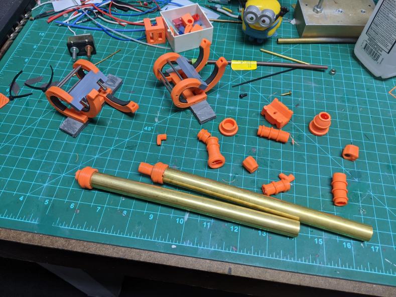

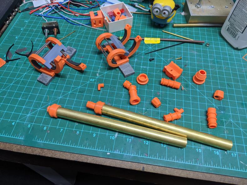

    Needless to say my first attempt at "annealing" 3D ABS prints lead to some rather "interesting" but useless pieces of art. Object's better suited for a Dr. Seuss book or movie.
    Click image for larger version  Name:	IMG_20200112_094544.jpg Views:	0 Size:	94.5 KB ID:	136393
    I set the oven for 210° (Convection as suggested), waited an hour where it stabilized exactly to 210° per the thermometer.
    Placed the parts in it, saw it had dropped to 200° in opening the door. Walked away for 3-4 minutes to prep for today's build, came back to verify the oven returning to 210° and saw it had risen to 250°, and saw the "art" pieces. I think the oven shot up to compensate for the drop in temp when I opened the door. Funny that the Nozzles which became Noodles reminded me of the eponymous hat in "Cat in the hat". Those beautiful engine mounts are warped beyond repair lol
    6 months of prints...sigh.
    AT least the designs are still in the printer.
    IMNSHO there is NO way you can control an ordinary kitchen oven this way. Maybe you can, but I'm going a different route.

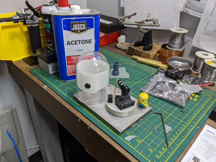

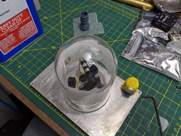

    Acetone Vapor Bath.
    Not getting in depth, so Ii you're interested to learn more about it, and the process involved, I used THIS article: Acetone Polishing (Smoothing) of ABS and ASA – a step-by-step guide

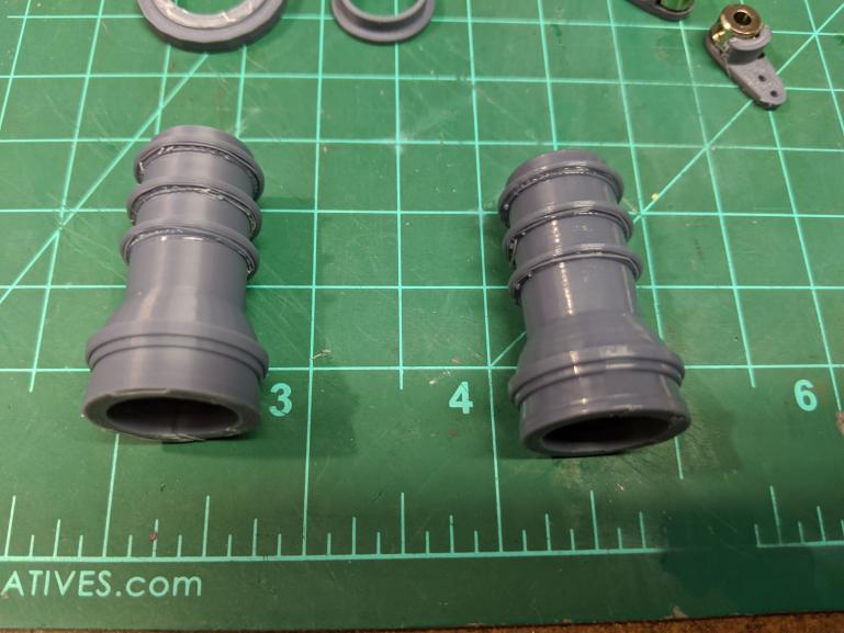

    It did make them look good, and while it may not make them as strong as if I anneal them, any strength benefit is a plus from the original, they didn't shrink, and they looked good!
    I bathed them for 17m30s and left alone for an hour.
    Sticking with this!

    So since your oven shoots up in temperature maybe try starting at 150°F and once it shoots up to 180° then set the dial to 200° and don't turn your back on it.
    You could practice this on the orange art you created.
