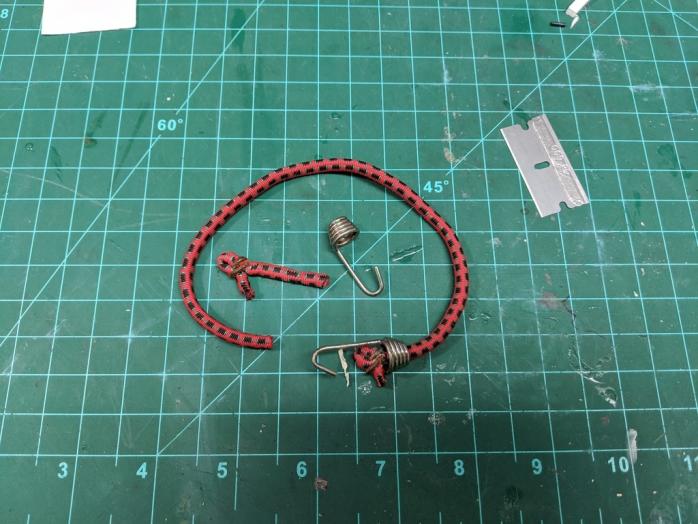

    First, I remove the hooks from old, small, fabric bungees. Then all you need is the appropriately sized Silicone tubing (can fit into the retaining end of the hook), in this case ¼ ID. Two short piece of rigid plastic rod/tube with an OD between the ID and OD of silicone tube to act as a stop. I this example a 3/16” od x 1/8” blue PVC tube (repurposed from a 16AWG Butt connector). Finally for “belt and suspenders”, good old GE silly-cone.
    Tools needed: a simple razor blade, and for the accident prone like myself you can opt for a tubing cutter if the stop is a plastic, or even brass tube. Another nice thing to have to insert the stop is a set of small, round nose pliers if it’s a tube. But you can grunt it in with your fingers if needed.

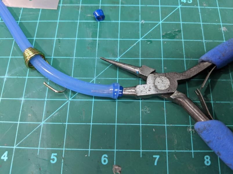

    Here I am inserting the stop. Just watch your “Order of Operations”. In my enthusiasm to take notes and photgraph doing this, I accidently put the sop in FIRST before sliding on the hook. Lucky only one side was done. But they can be worked out if needed.
    That’s why a squirt of GE filling past the stop (if it’s a tube) is a good “belt and suspenders” idea. Silicone adheres quite well to itself lol. Be patient and let it cure!

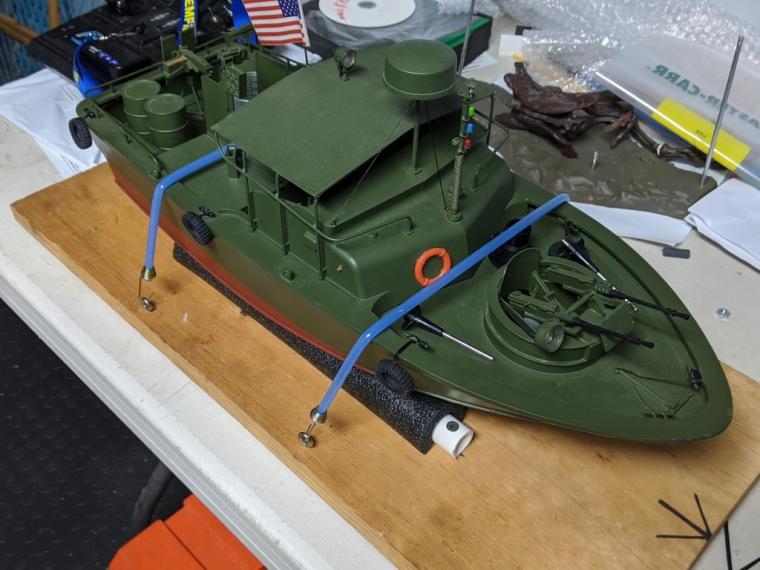

    So here it is on holding my ALPHA 21 on its transport board. Easy-peasy-lemon squeezy. And it won’t hurt the finish like the standard fabric shock cord ones began to do.
