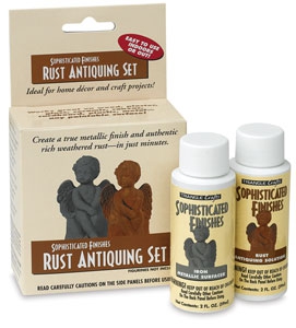

      Thanks! I did see another rusting effects product. It is sophisticated effects rusting. I am ordering this along with fine iron filings. To do some more tests.Click image for larger version
