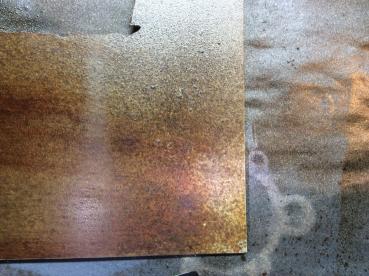

        Here is the first shot after it dried. This is about 15 hours later. The Oxidation on 2 was premature. I added some VHS prior to this picture.

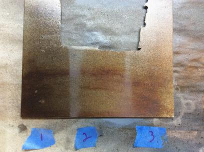

          Here is a shot right after I added VHS to each except 1. You can see the oxidation process start right off with the foaming.

            Here are some closer shots.

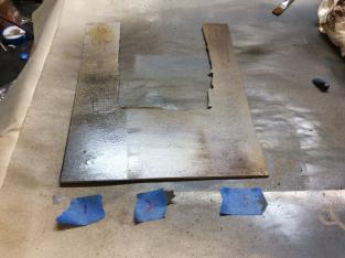

                      I think I might be onto something here. I washed the rust sludge with a sodium bicarbonate solution (water and baking soda) as David mentioned. I was being a bit impatient and brought some of the paste into the house. I had some more extra garbage plastic that I was not going to use, so it became a "Victim". I have added some descriptions to the photos. Let me know what you think. Granted, this is an early experiment. I want to get the process down before using it on the real thing. I want all opinions please. 2.) Here I have sprayed the flat chestnut metallic paint. I let it dry. I then mixed a bit of flat black and gunship gray from model masters and painted a line on top. (This would simulate the spayed rivet lines). I then applied the rust paste and let it dry a bit and wiped off. Yes I touched it earlier with my darn finger to see if it was dry. My bad. 3.) Here is the Dark Steel rustoleum paint with some of the rust paste applied. 1.) Here is rustoleum flat chestnut which is a metallic paint. I applied some of the rust past and let it dry a bit and wiped off. It still does have metal effects to it which this photograph does not totally pick up.

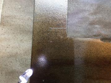

                        Here I was holding an LED light to show some of the metal effects. I have to go get a satin or semigloss spray to lightly dust the tea subjects.
