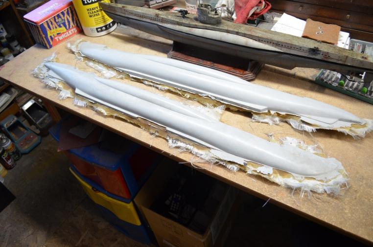

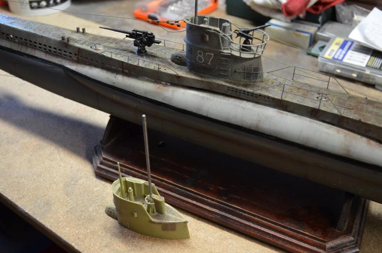

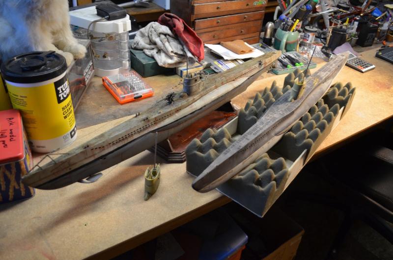

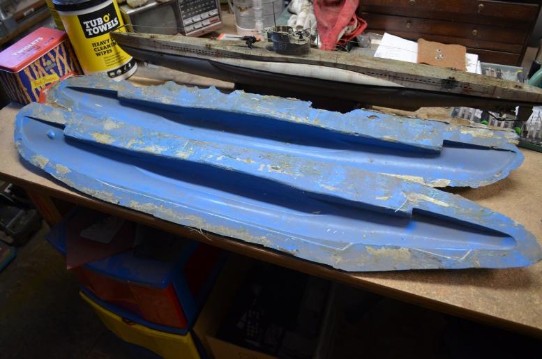

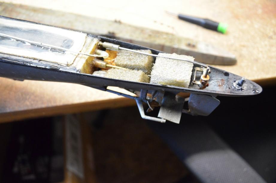

      I have a lot of experience with this kit. It came out around 1995, long before the Revell 1/72 plastic kit. It was fantastic for its time and still a very nice model today. The photoetch is beautiful and there is lots of it. Most of the limber holes including the sides of the hull are photoetch so you don't need to cut those out. The Resin parts are also very nicely cast but not strong enough for RC use. I made several of these as RC models by doing exactly as Goshawk suggested. I made a mold off of the kits resin hull and then made fiberglass hollow hulls. I still have one finished working model (I sold a couple) although it hasn't been in the water in at least a decade. I have another partially built and I still have the molds I made and was surprised to find there was another hull still in them in raw untrimmed form.
      I had also made several more hulls for other people in the subcommittee but I don't know if anybody else ever actually finished one. My RC version split at the waterline and was a dry hull with a gas ballast system. I made all my own parts from brass including the vent valve, propellers, planes, rudders, guards etc. The ones in the kit are nice but not strong enough for RC.
      So why would anyone want this kit today when you can buy the more detailed Revell kit for less money? I think it's still worth it. The kit was about $299 when it was new. It's the less commonly modeled variant of a VIIb. The photoetch is amazing. I love plastic models and I am in no way knocking plastic model conversions but having something made of metal and fiberglass seems more substantial to me but that might just be an old guy thing. I also think a dry hull works well for a model in this size where weight isn't an issue. If anybody wants a hull I do still have those molds, But be warned making them into an RC model is a lot of work.
