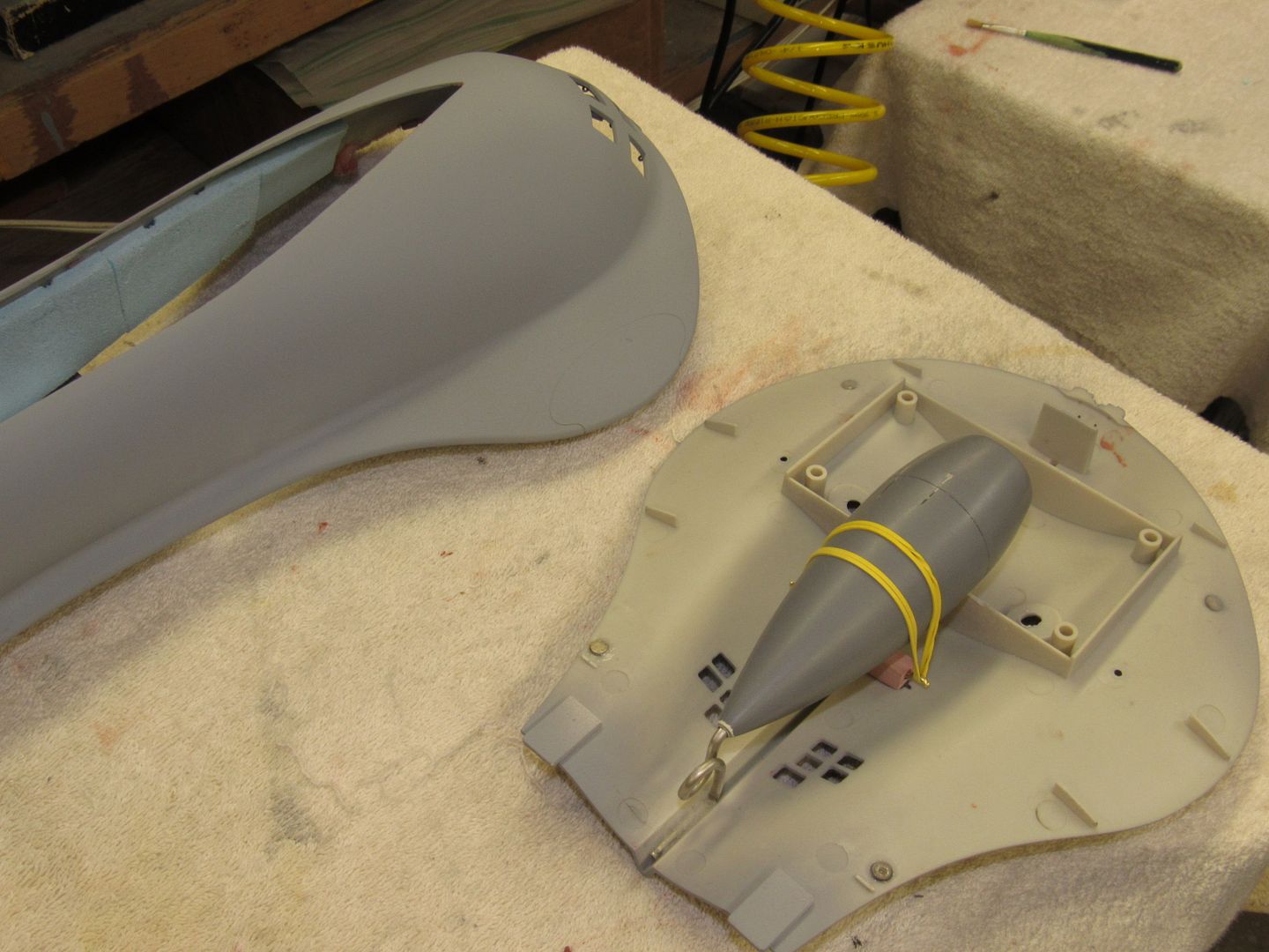

    I also see a couple of stitches in your thumb, ouch. Any great story to that? Like fighting a bear or disabling a bomb thus saving the world? or is it a ritual you do when building to truly put your blood, sweat, and tears into this hobby?
    Three of 'em. An offering to the great SEAVIEW God. Not much to this pagan ritual: just get sloppy with the X-Acto knife when slicing off the superstructure.

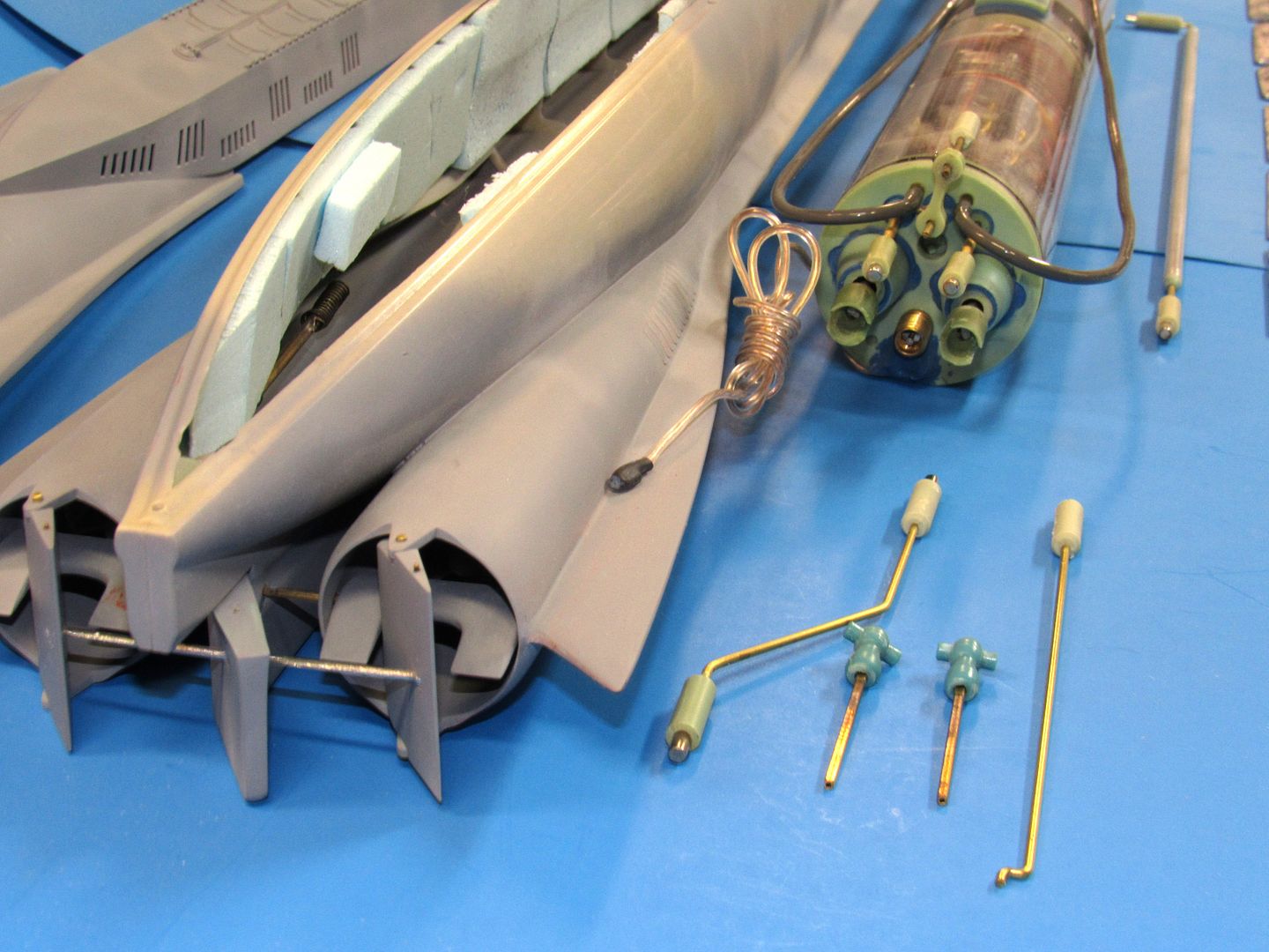

          I do not see bow planes like you have used in the past. Are you planing on adding some in?
            I'm doing the maiden run of this model this morning at the local diver training pool. No, I won't make the bow planes on this 'movie' SEAVIEW practical. I'm counting on the low pressure at the bottom of the stern to solve the 'pitch down' problem encountered on this design. So, only stern planes and sail planes as active means of pitch and depth control. Film at eleven!

                This first pool run was without auxillery vanes in the nozzels. I was hoping the pressure differential across the stern would push the nose up when cruising in submerged trim. Nope: the same dive-of-death each and every SEAVIEW I've assembled and operated has done without the vanes. So, on they go. Otherwise excellent turning radius, and the SD came back bone-dry. I could hold depth (barely) at a high bell, but when I slowed, it started to look like the first reel of the movie, 'Flight'. And I ain't rolling out of this.

                        David, how effective are the sail planes on Seaview? I would assume they are necessary given the size/configuration of the stern planes.
                          Originally posted by PaulC
                          David, how effective are the sail planes on Seaview -- are they necessary given the size/configuration of the stern planes?
                          Providing the boat is in perfect submerged trim and a pair of vanes (angled to direct the thrust 'up' in order to produce a nose 'up' moment -- to counteract the natural nose-down tendency of the design) are set into the nozzles, then I've found the sail planes to be effective in managing depth. You can see them at work here: https://youtu.be/DYVTNzmNIrM at 4:52
