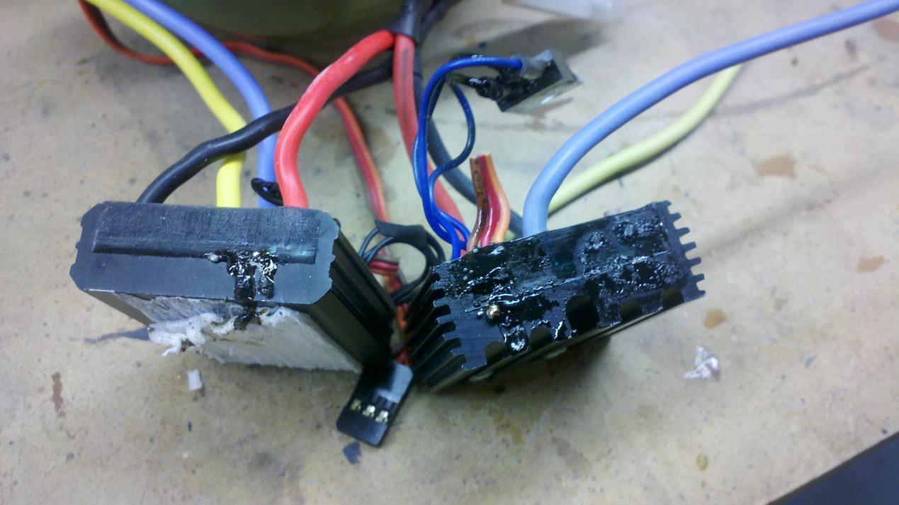

                      I just had TWO of these explode on me. One came from OTW and one was in my parts bin. They both exploded in a like manner (yes.. literally exploded). They were pulling power from the same source, however they were driving two different motors, one the main drive motor and one a little Graupner motor for a bow thruster.
                      Smoke billowed out of them and they literally spat gunk all over my shiny WTC innards. Both were working perfectly up to the time they died.
                      Weird as heck.
                        #56
                        Hmm... now that I think of it.. would it be bad that each was running a BEC circuit?

                              Bob,
                              These Nuked ESC's you pictured: are they the now infamous Viper-10's?
                              You must be madder than hell about this. They popped IN your WTC. Ouch!
                              They popped at the same time? Did they pop at power-up or after some time after power-up?
                              I know you use a lot of the Micro-Marine 10 ESC's -- ever have a problem with them?
                              Send your fried Viper-10's and unused Viper-10's to Mike for replacement -- excluding those bought from another source, of course.
