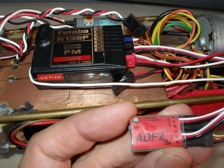

im now trying to RX suggested by Andy. It still doesnt seem to want to enter set up mode, and its not showing an rx signal. But hot plugging it does work!Next time someone points out it takes 42 muscles to frown, point out it will only take 4 muscles to b1tch slap them if they tell you how mnay muscles you need to smile:popComment
Unfortunately I've got no familiarity with the receiver Andy suggested, but if I had to guess I'd suspect that it was suffering the same problem as with your R146. As before I'm happy to correct the problem.Kevin McLeod - Oscar II driver
KMc DesignsComment
im going to video start up and email to you. the fact it hot plugs gives me some confidence its me thats doing it wrong this timeNext time someone points out it takes 42 muscles to frown, point out it will only take 4 muscles to b1tch slap them if they tell you how mnay muscles you need to smile:popComment

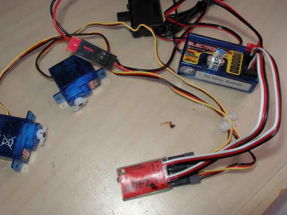

Further to earlier problems, Kevin and I had been looking into the problem, and Kevin suggested some other tests, but the standard ADF2 was definitely not working with the Futaba or Hi Tec RX’s that I had. I got hold of a Sombra labs SL8 and that worked fine with the original ADF2
Kevin has subsequently revised the ADF2, and sent me a sample to test. You can see I have written a second ‘2’, so it’s my ADF22
You can see here me playing around with one channel driving a servo as pitch, and the other another Servo as failsafe.
Using the ADF2 and tilting it, you can see the servo moving to control pitch. By adjusting the controls on the TX you can also see the servo move, and lastly when the TX is turned off, the other servo moves over to its set point, as a fail safe position, success
So clearly the updated ADF2 now is compatible with these other RX’s.
Thank you to Kevin for solving this problem, its great to have a supplier who can give feedback in this manner, and update their products to meet these other RX’s.

... And thank you Albion for your patience in getting this issue resolved!
A further clarification on this mod - All ADF2's going forward will come with this update already made, and should anyone experience this issue with a previously shipped ADF2 I'm willing to update it at no cost, just contact me and we'll make the arrangements.Kevin McLeod - Oscar II driver
