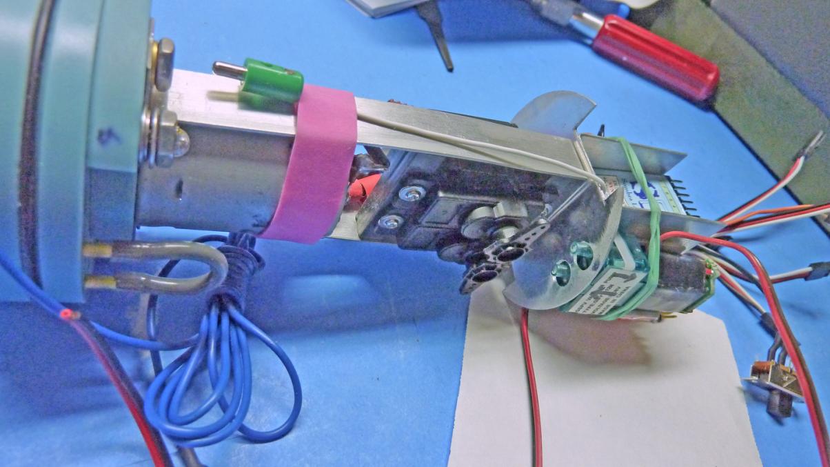

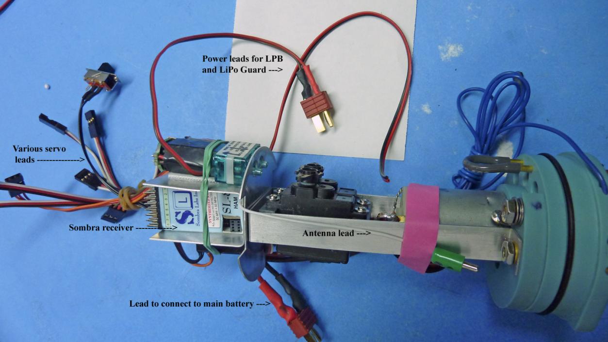

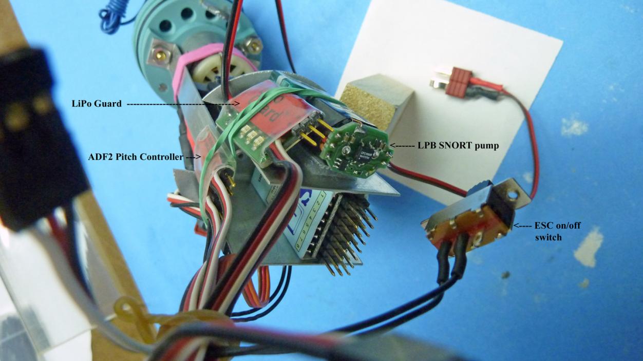

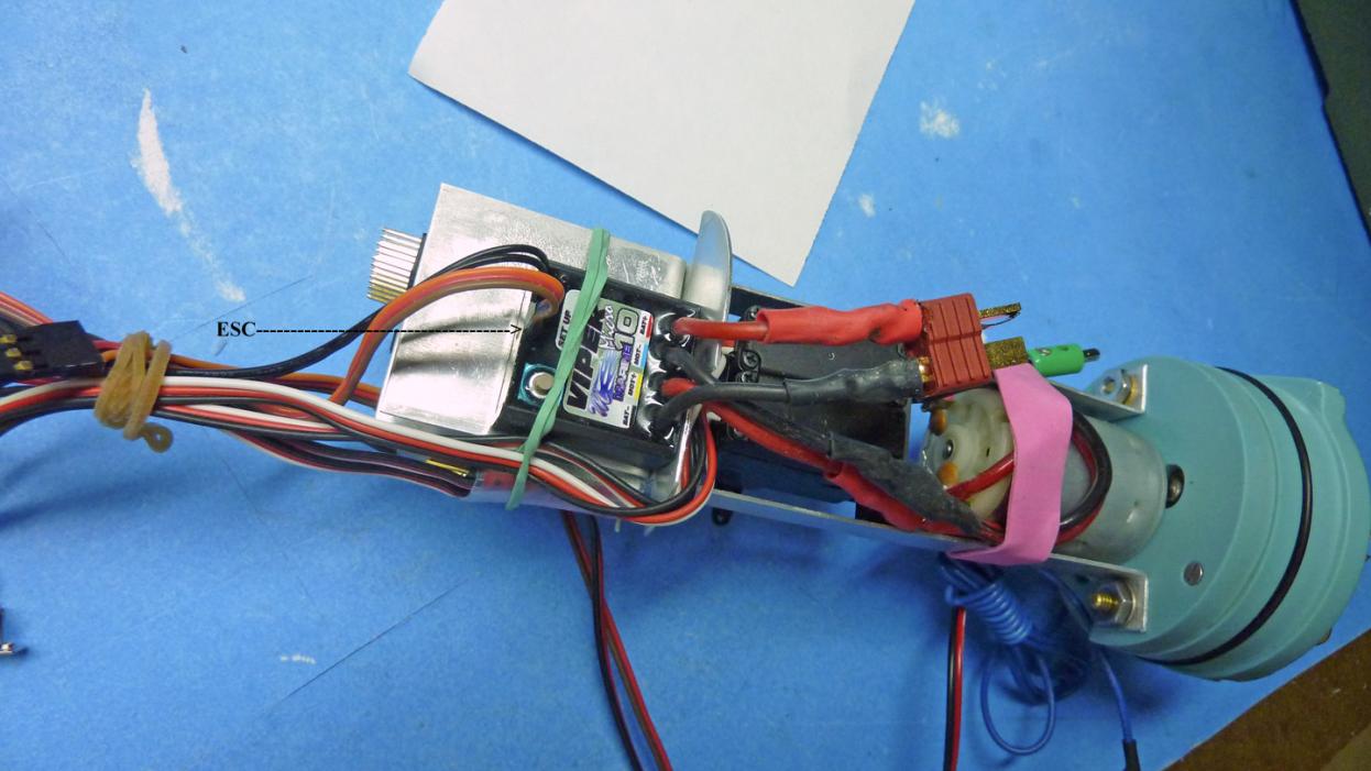

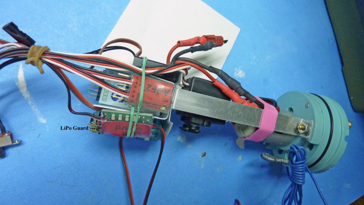

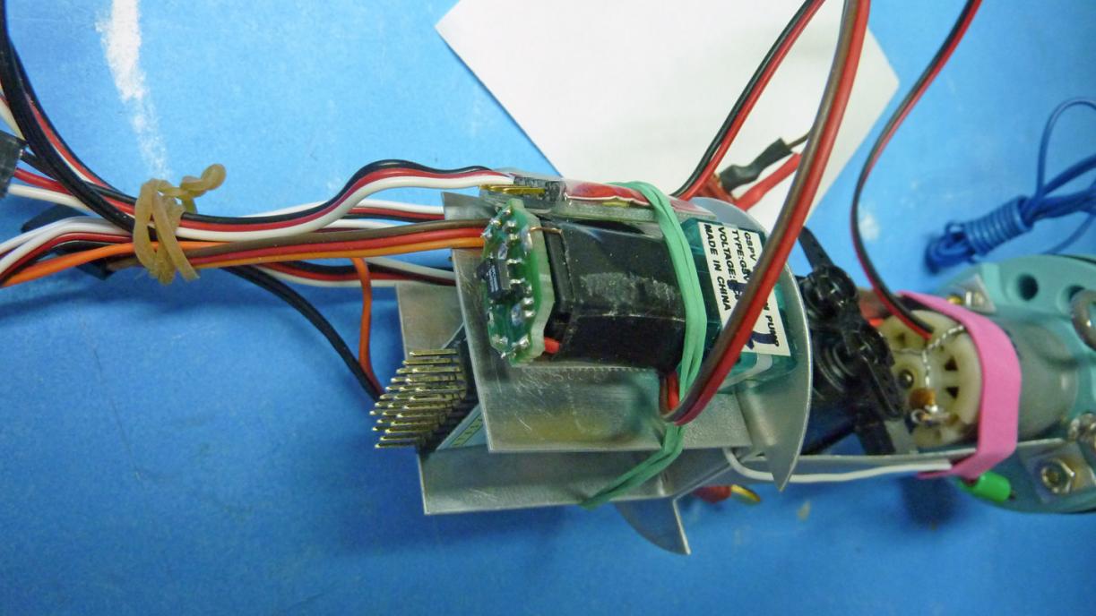

                Engine room Mark II
                OK, I shuffled the parts again and got this.
                First of all, please disregard all the rubber bands. They're only temporary (I hope).
                Secondly, I shall use some of the newly acquired styrene to build brackets for all the parts.
                Here are the photos:

                More later,
                Dan
