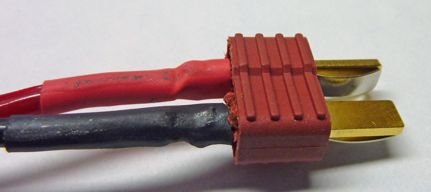

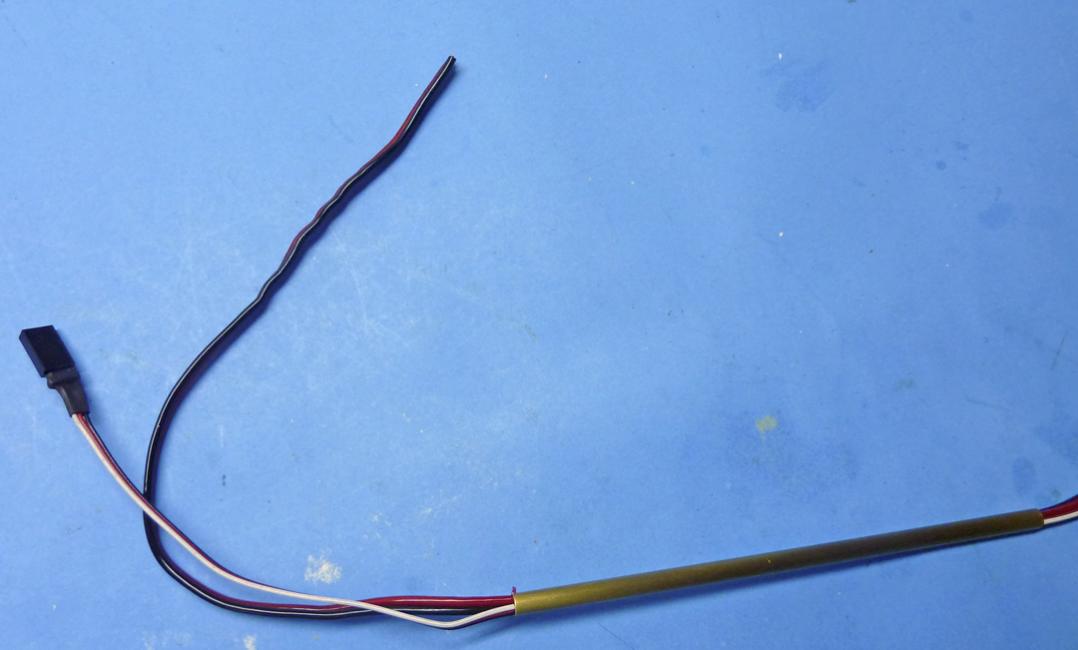

                      the connecting tube
                      I shall now prepare the connecting tube. This tube is normally used to carry battery, plus and minus, back to the "engine room". However, I shall also use it for one of two possible functions. One, to carry a servo signal back to the forward compartment if I ever decide to place a servo up front - OR - two, use an extra battery up front to just power the receiver, i.e, don't use the BEC of the ESC (don't you just love abbreviations).
                      First of all I jam the two wired through the tube...Click image for larger version
Name:	039 battery and servi leads in bronze tube.jpg

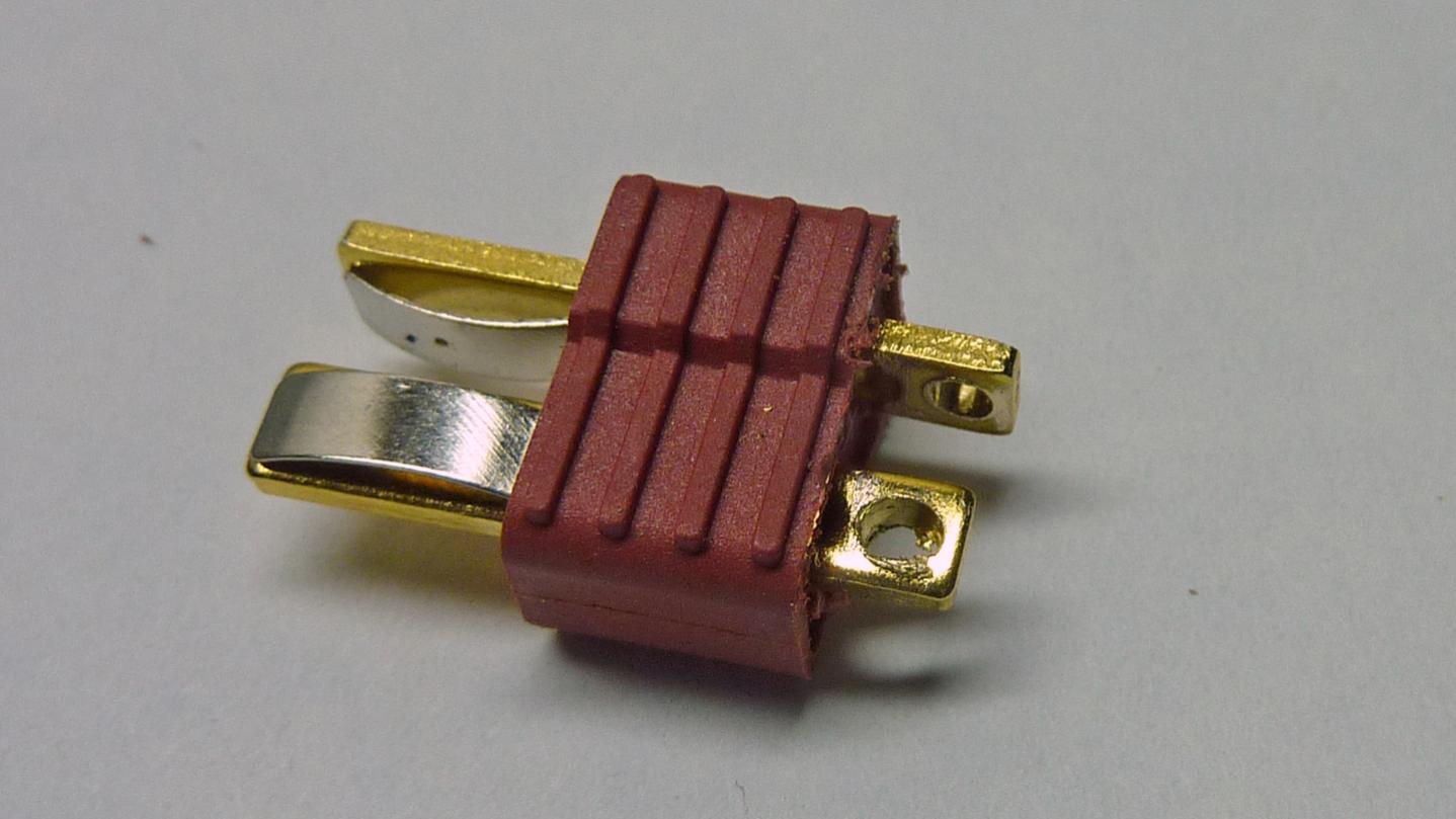

ID:	59048...then I solder a Deans like plug onto the forward end. I like Deans plugs but I don't like trying to solder to them. So I drill two small holes in the lugs so that I can better mechanically attach the wires to the lug...Click image for larger version
Name:	040 knock-off of Dean's plug showing the holes drilled for better mechanical strength.jpg
ID:	59049 At this point some of you are shaking your head saying to yourself,"The fool will get into trouble running the servo wire next to the power wire." Well, maybe. I've done this in other circumstances (surface craft) and have never had any difficulty. Maybe I've just been damn lucky. I know the risks involved - let the recriminations begin.

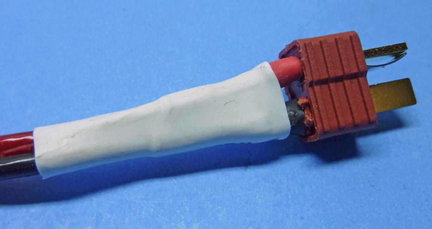

                      Next I solder the wires onto the lugs using shrink wrap for insulation and strain relief...Click image for larger version
Name:	041 wires connected to plug with shrink wrap.jpg

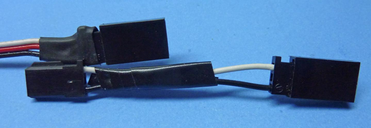

                      If I use a separate battery to power the receiver I must isolate the "battery plus" lead between the ESC and the receiver. For that purpose I have constructed a servo adapter connector without the "battery plus" wire, the red one...Click image for larger version
Name:	043 servo adaptor plug without battery plus lead.jpg

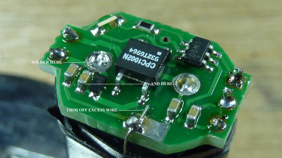

                        assembling the SNORT pump with MPC

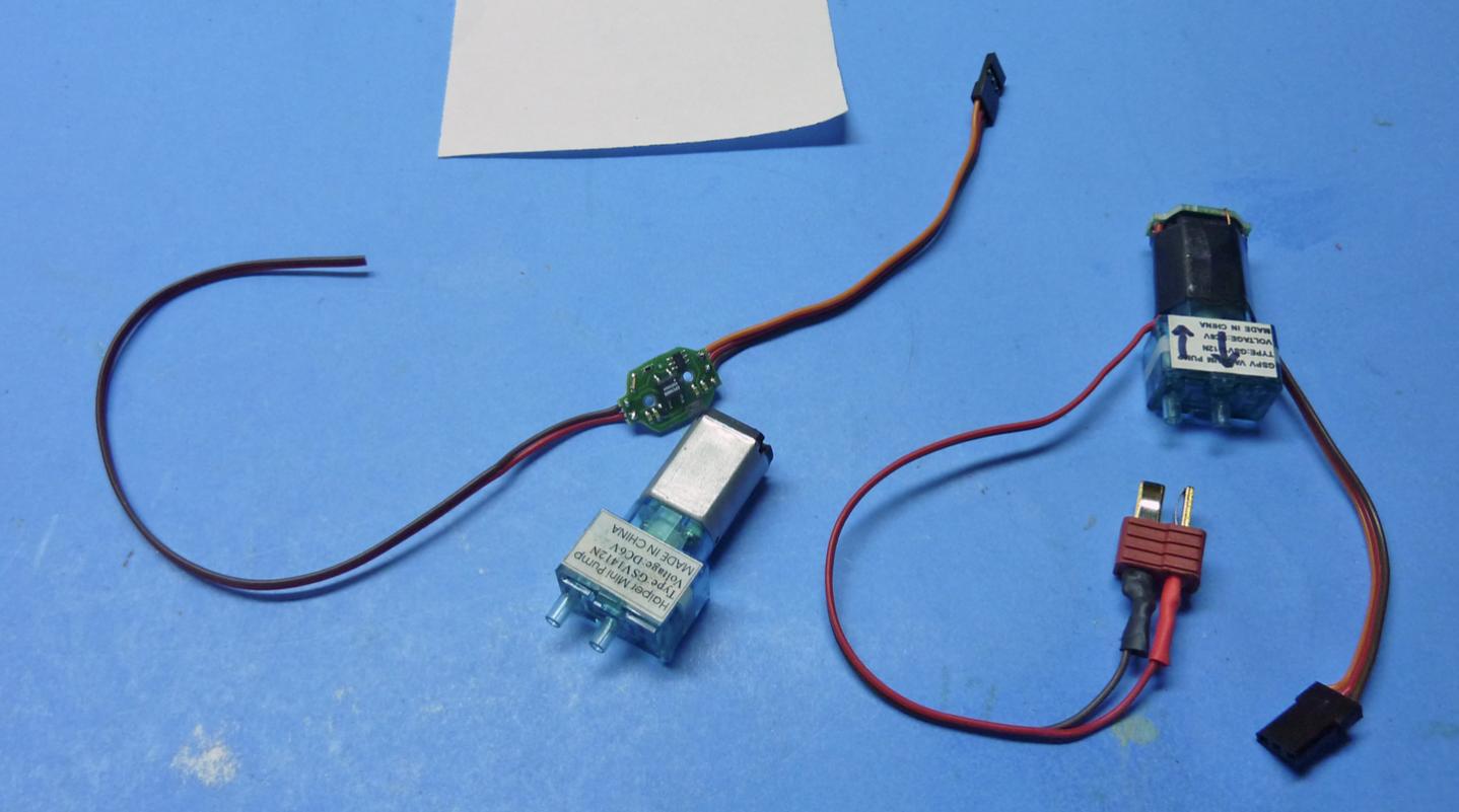

                        As I shall be using a SNORT system with this WTC, I'll now assemble the SNORT with a KMC Mini Pump Controller, MPC.
                        A picture of a completed one and an unassembled one...Click image for larger version
Name:	044 showing the small servo pump and a KMC Mini Pump Controller MPC.jpg

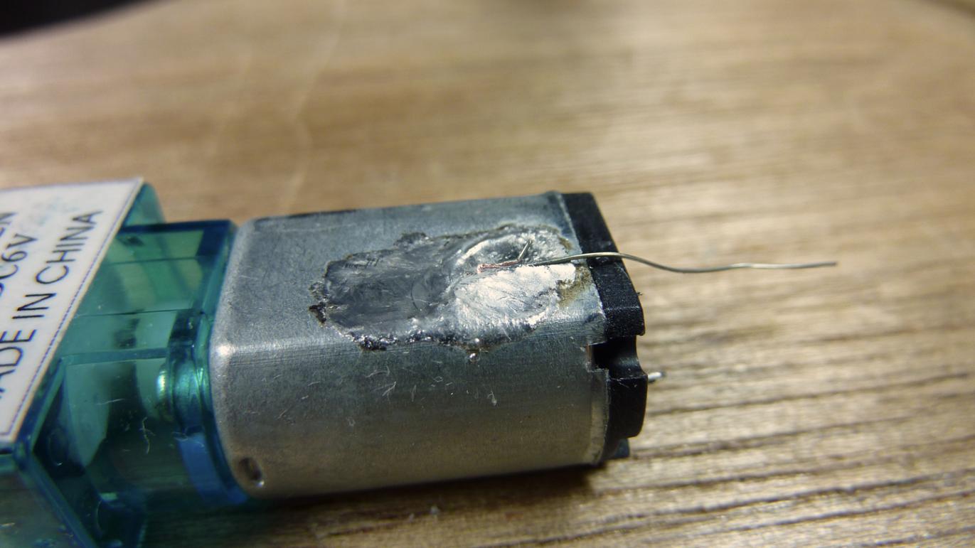

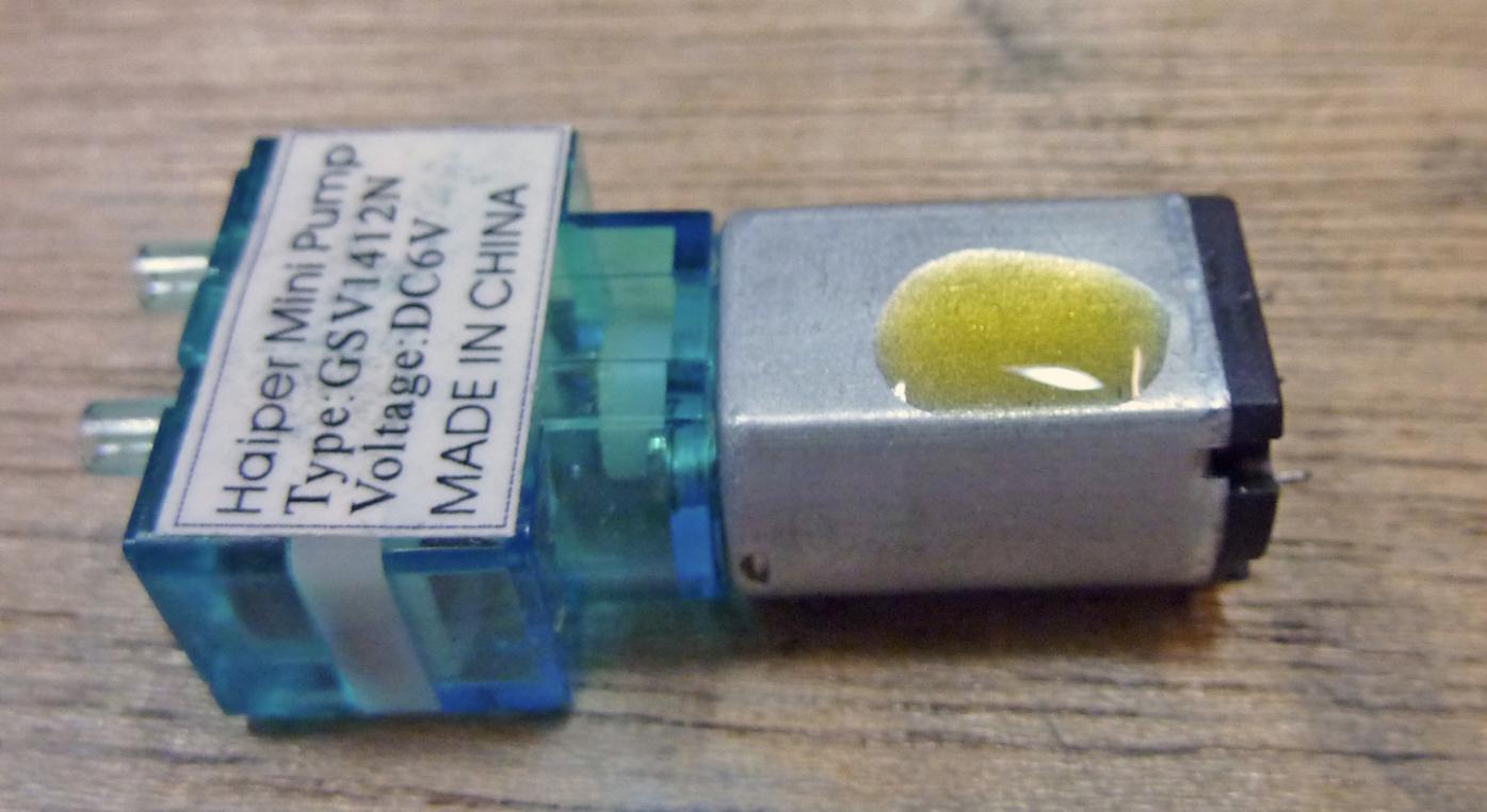

                        First a drop of solder flux on the case to make soldering easier...Click image for larger version
Name:	045a small drop of solder flux on pump case.jpg

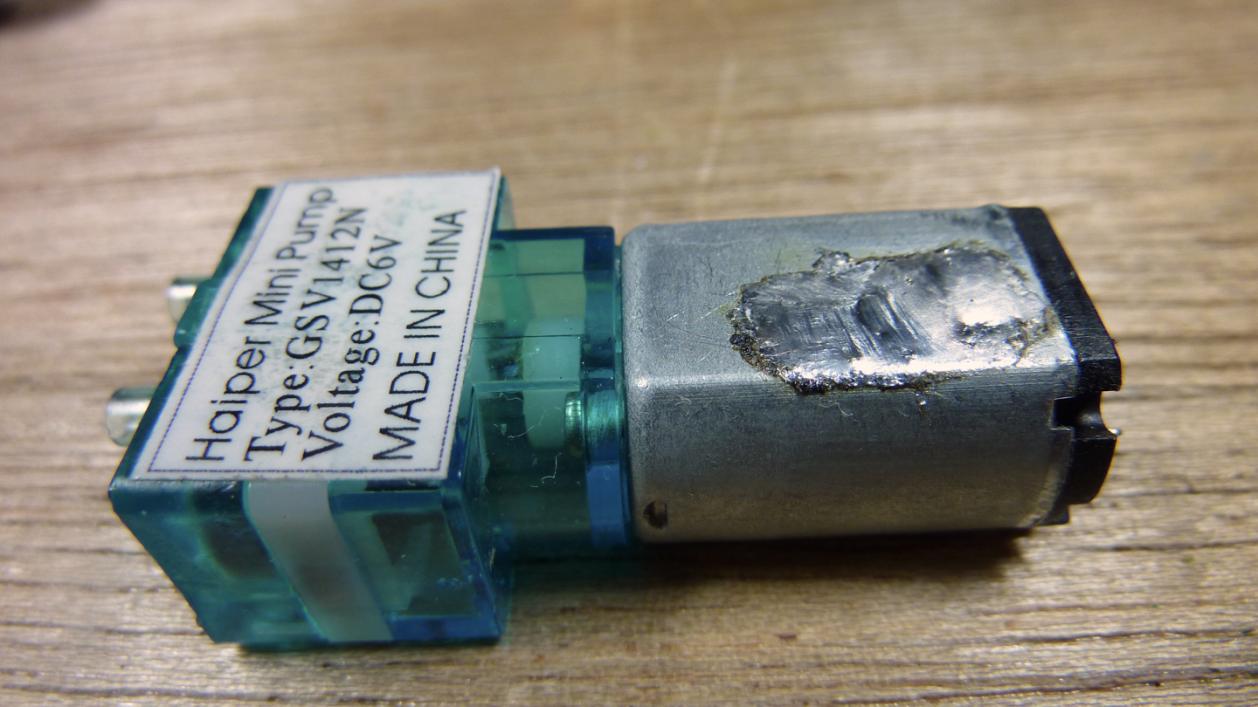

                        Secondly, put some solder on the case...Click image for larger version
Name:	045b put a little solder on the case.jpg
                        Then solder on the wire...Click image for larger version
Name:	045c solder on the grounding wire.jpg

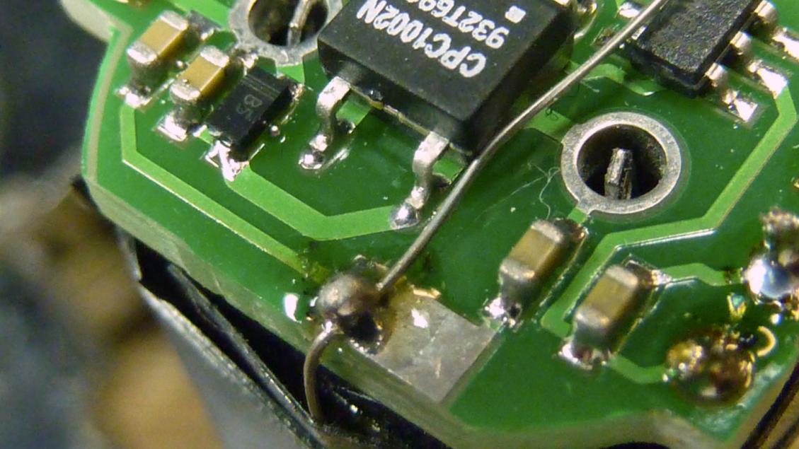

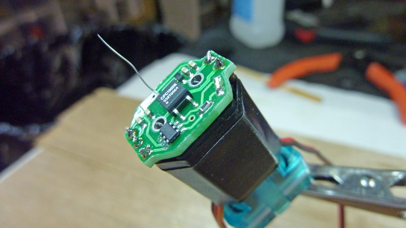

                        Then solder the grounding wire to the pad on the printed wiring board (PWB)...Click image for larger version
Name:	045e solder grounding wire to pad on PWB.jpg
                        Finish up by soldering the pump leads to the MPC and trim off any excess wire...Click image for larger version
Name:	045F solder MPC leads.jpg

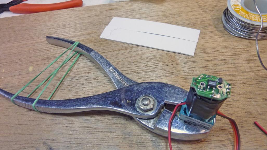

                        I did all this using the old "rubber bands around the pliers handle as a poor man's "third hand" trick...Click image for larger version
Name:	045g rubber band around pliers trick.jpg
                        Finally, attach the power plug of your choice and you're good to go (See the first pic).

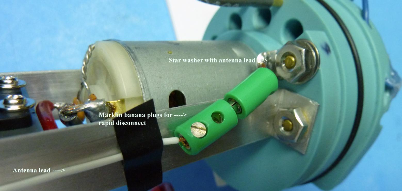

                          Antenna leads

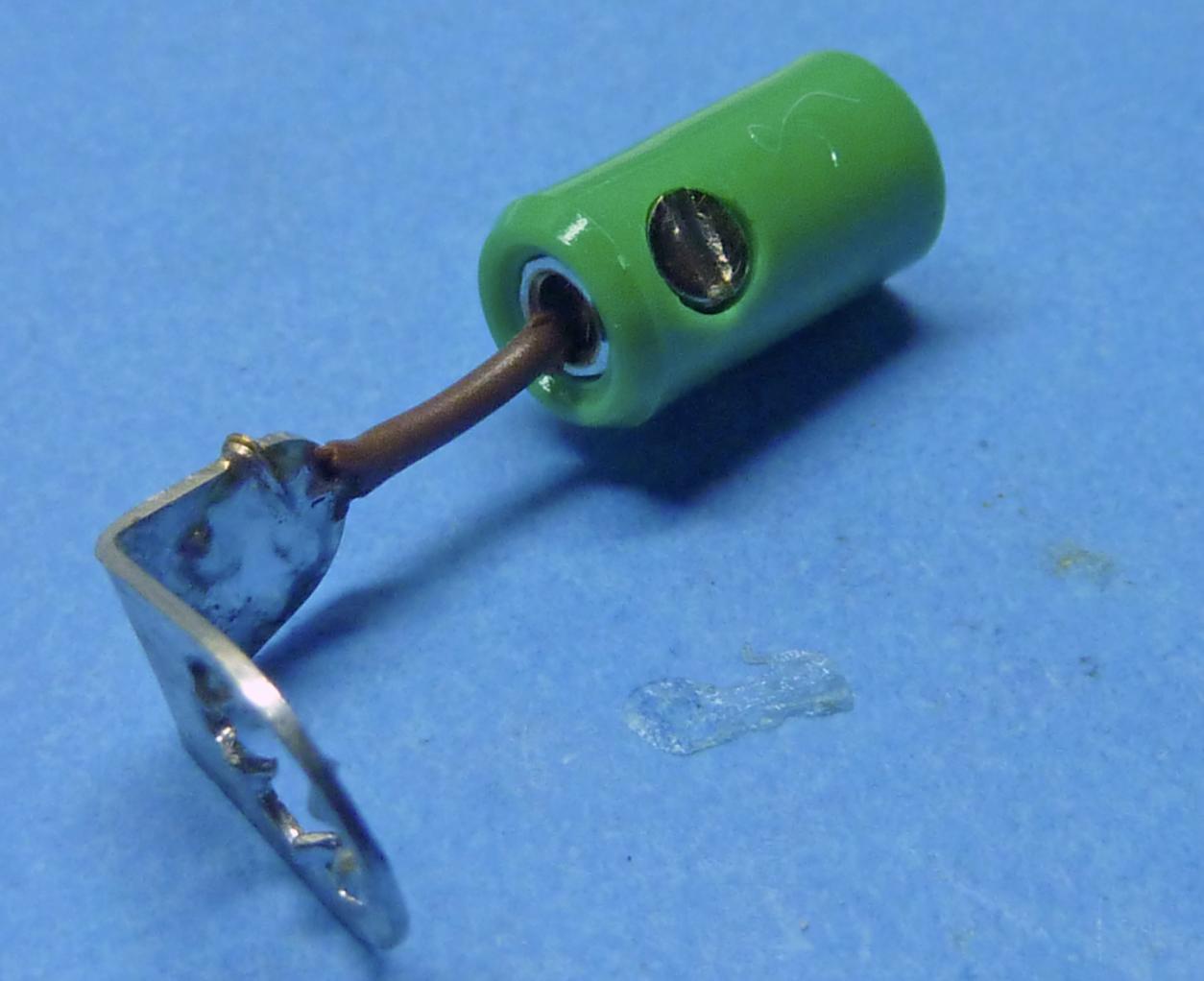

                          Now it's time to start the assembly of the "engine room". First I prepare the antenna lead. As I'm always after ease of service in the field I shall prepare a rapid disconnect for the antenna lead. I'll use Märklin (German manufacturer of model railroad equipment) banana plugs. I've used these for years in model railroads with no failures. I prepare a star washer by bending it 90 degrees and soldering a wire to it...Click image for larger version
Name:	046a wire soldered to star washer for antenna lead.jpg
                          Next, using the banana plugs I complete the circuit...Click image for larger version
Name:	046b antenna lead.jpg

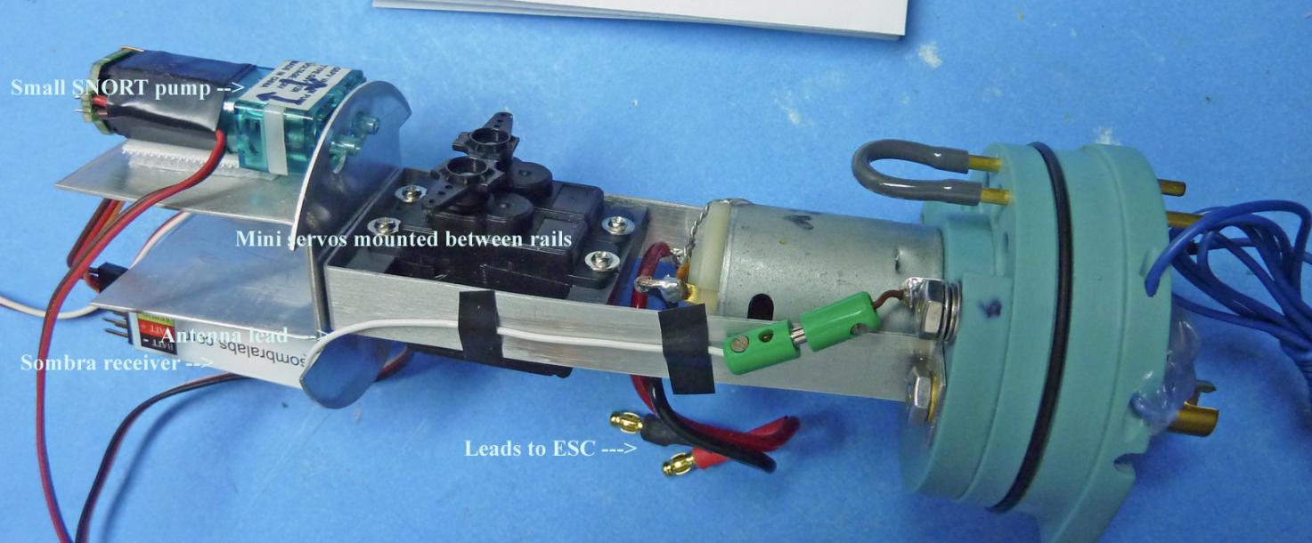

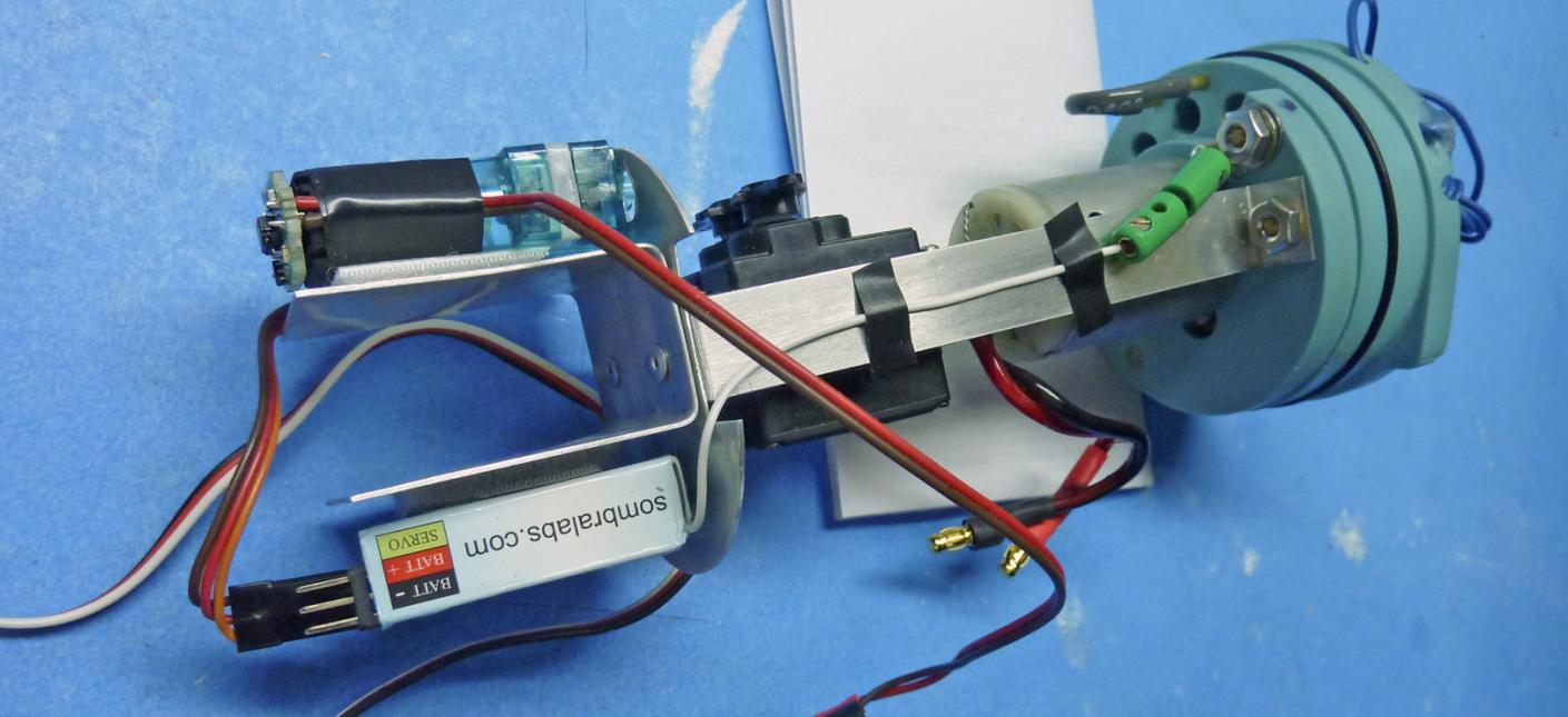

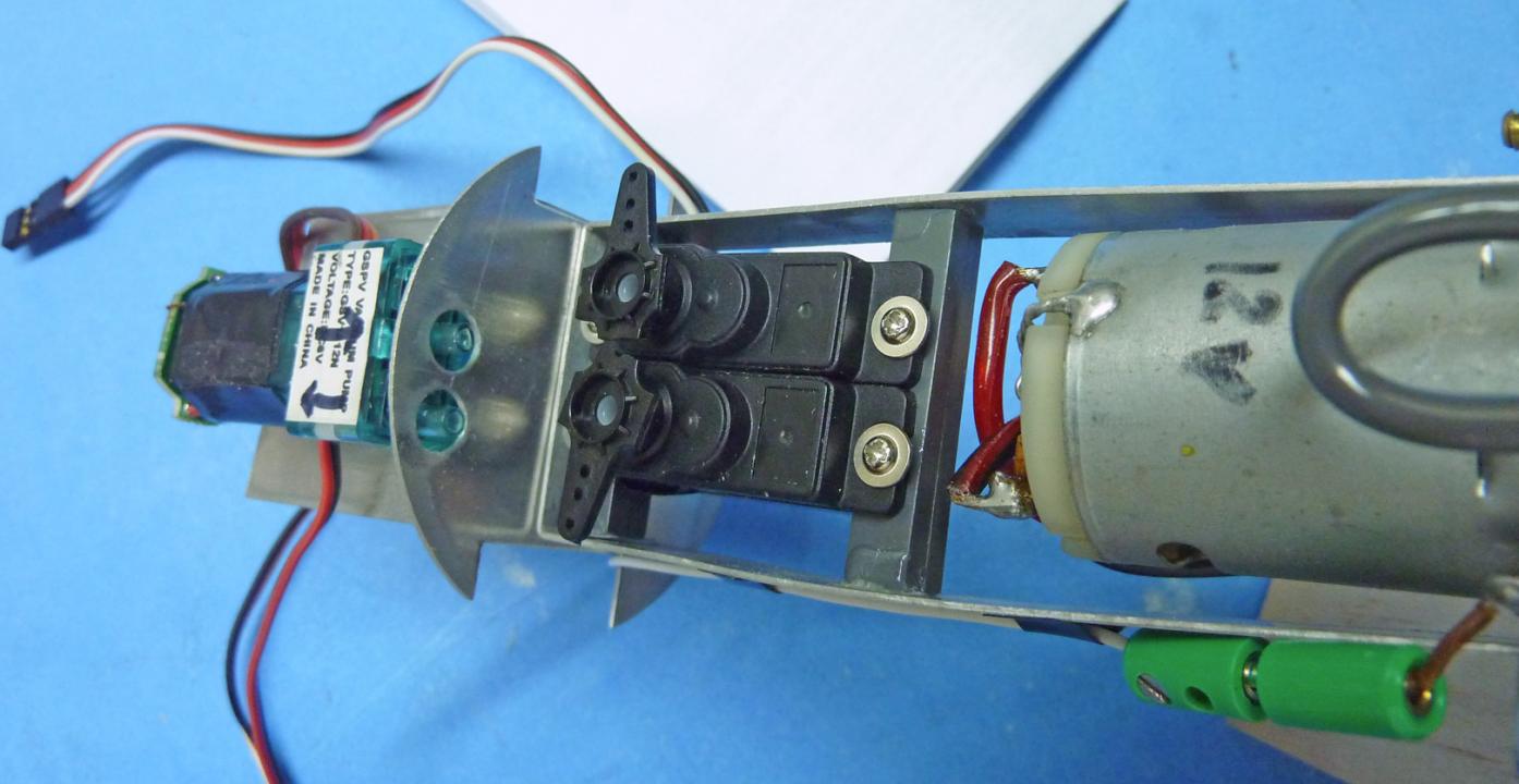

                            The "Engine Room"
                            This is just the start of this assembly. I spent some time trying to figure out where to place everything. There's not a whole lot of room in this WTC but with smaller components I think it'll all fit (I hope).
                            Here are three views of what I've done so far...Click image for larger version
Name:	047a start of engine room assembly 001.jpg
ID:	59069...Click image for larger version
Name:	047a start of engine room assembly 002.jpg
ID:	59070... and ...Click image for larger version
Name:	047a start of engine room assembly 003.jpg
                            More later,
                            Dan
                              • 13990
                              Hey, Dan:
                              Put the LPB on the bottom and the receiver on the top. When you take on water in that space, which item you want to keep in the dry?
                              • roedj
                                • Sep 2008
                                • 564
                                Ok, I see the logic in that..
                                BUT...
                                I thought that the two holes in the transverse shield were made for the leads coming out of the LPB. If I put the LPB on the bottom then I have to run the hoses from the front bottom of the equipment rack up the sides to the SNORT tubes on the back top. The way I have it now it's a straight shot from the LPB to the SNORT manifold on the back seal...
                                OR...
                                I have this whole thing completely screwed up.
                                To get the receiver off of the bottom I suppose I could mount it in the middle area of the front in between where I have the LPB and the receiver now.
                                Confused in Canton
                                P.S. What is all this bilge about "taking on water"? Are you saying the designer occasionally makes a mistake (or is just the FUBAR assembler)?
