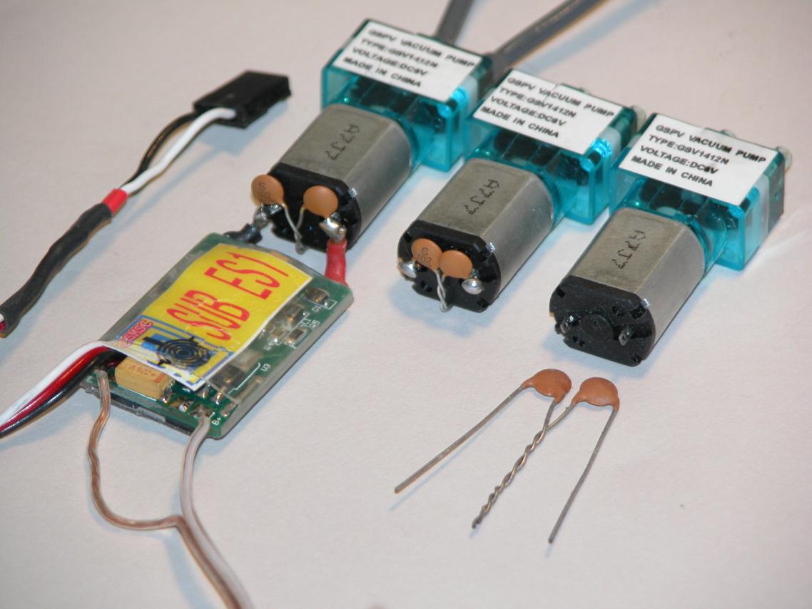

      Thank you for your quick response, Mr Merriman. But, How are they soldered in place? Is ti possible to have a picture about?

        Two capacitors, each soldered to a motor pole and to the motor case (ground).
        The picture below shows the two capacitors attached to a LPB motor. Not to worry, it's the same arrangement for the propulsion motor -- by the way, the Cap's are not needed on the LPB motor if you use Kevin McLeod's electronic switch.
