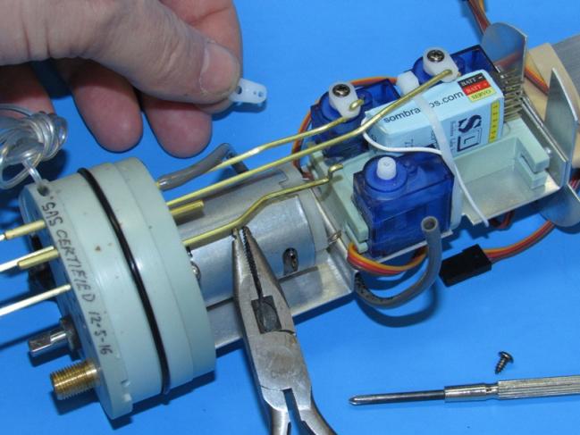

          Cut the servo horns back to retain only the three holes from the center -- you need to do this so the horn does not strike the inside of the cylinder during full-throw. Experiment with what gives at least a 30-degree throw of the control surface with full-through (end-points set at 100%-100%) of the servo. Fine tune at the transmitter -- the end-point adjustment, if you have that feature.
          I've found the second hole from the center (dirty-boy... get your mind out of the gutter you nasty old Auxilleryman, you!) to be the most useful.

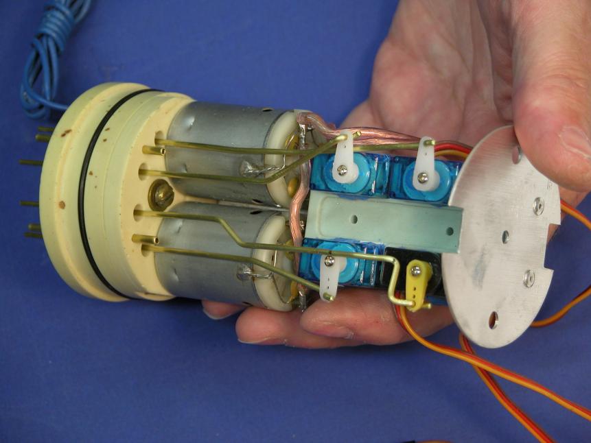

            Ok! What is the preferred assignment of servos? From left to right, looking at the shaft coupling sticking out of the end-cap. I originally was gonna go bow planes, bow planes retract, rudder, stern planes. Now, I think; rudder, bow planes, BPR, stern planes. I'm also going with servo arms facing inboard all the way around.
              • 14009
              Rudder, port; bow planes, center; stern planes, starboard.
