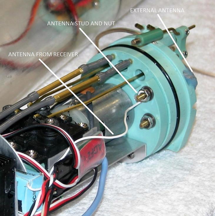

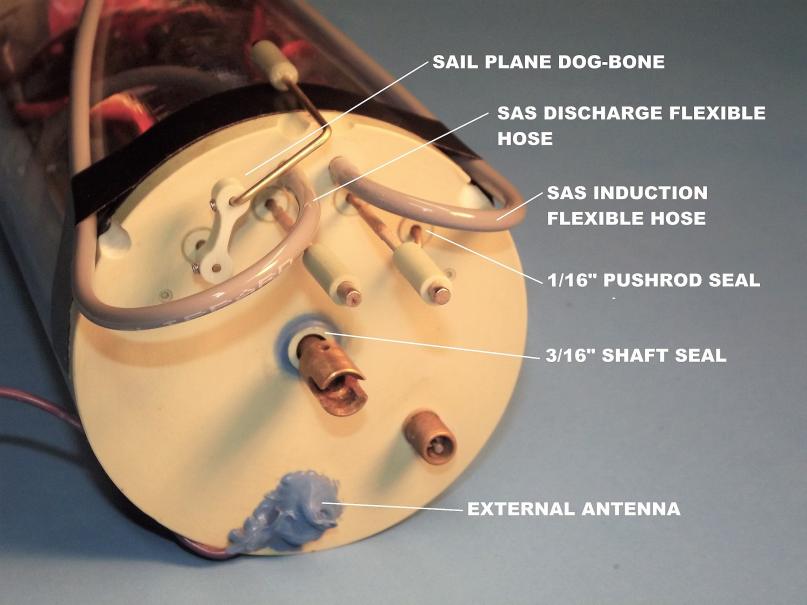

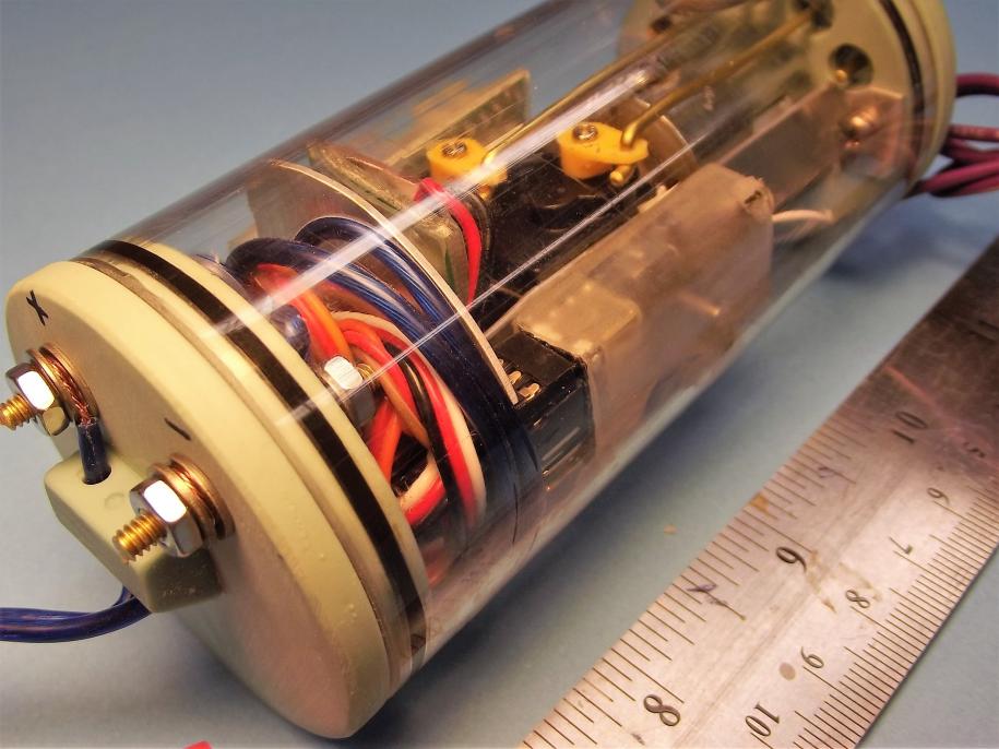

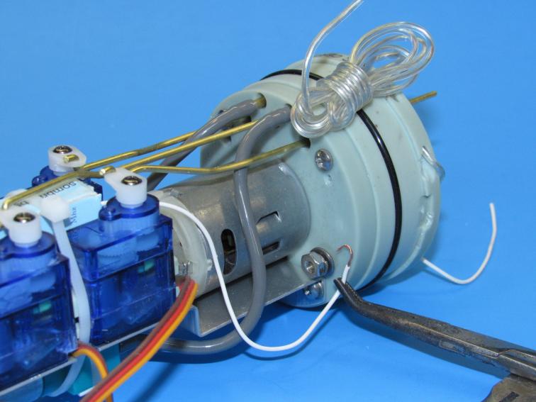

        And never pass insulated wires through the WTC bulkhead as water will work its way between conductor and insulator and will flood wherever the conductor terminates (likely the PCB of an important device, like your ESC or receiver). Use pass-through studs to conduct signal/power between external and internal wiring.
        Click image for larger version  Name:	029 (2).JPG Views:	0 Size:	59.7 KB ID:	151549Click image for larger version  Name:	033 (2).JPG Views:	0 Size:	79.0 KB ID:	151550
        One of the many things I learned as a navy Diver was that electrical devices, and particularly those exposed to the environment, will eventually get wet. No matter what you do to prevent it. Our MK1 band-mask comm's had to be replaced almost monthly as they featured 'watertight' connections between Diver umbilical and the hat. Yet, the bare fisted wiring to the old MK 5 diving dress lasted for years -- in salt water!
        I'm the idiot jumping into Naples water... yuck!

          Great info, thank you. I need to post pictures of my custom assembly, interested in your opinion. Concerning the wiring through the bulkhead, what about the antenna. With the sealed tip and the knot at the receiver end, it does not count?

            If the wet side of the antenna has no damaged insulation and the tip is indeed made watertight (heat-shrink tubing and a dab of silicon rubber does it for me), then a pass-through the bulkhead is OK.

            But why risk a wet receiver PCB when a simple pass-through stud will let you sleep better at night?
