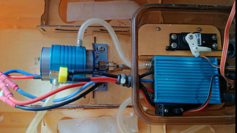

                        I have the same boat for more than a decade but it has been sitting around for 8 or so years and it's batteries are dead.
                        I am planning on buying some batteries to play with my little boy and looking for new lipos.
                        With the appropriate controller of course.
                        What is your opinion about this from Banggood?
                        XF POWER 7.4V 4000mAh 60C 2S LiPo Battery T Deans Plug https://banggood.onelink.me/zMT7/1t4mfjmu
                        I found a review on YouTube saying that they are very good for their price.
                        But also why does my boat has only one Deans connector???
                        Am I missing something?
