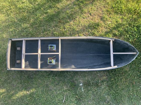

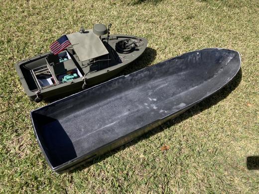

    PCF SWIFT in 1:12 scale

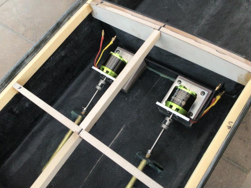

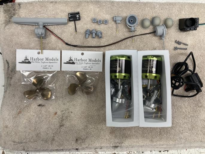

    While I wait for sub parts, I thought I would share my next surface runner. Building this to go with my PBR in the same scale. Model is 50" long and will feature a near identical build to the PBR. Scale printed Detroit diesels, weapons and fittings. I am even swapping the figures between them. Twin Tacon .32 outrunners offer plenty of quiet power.

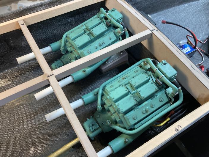

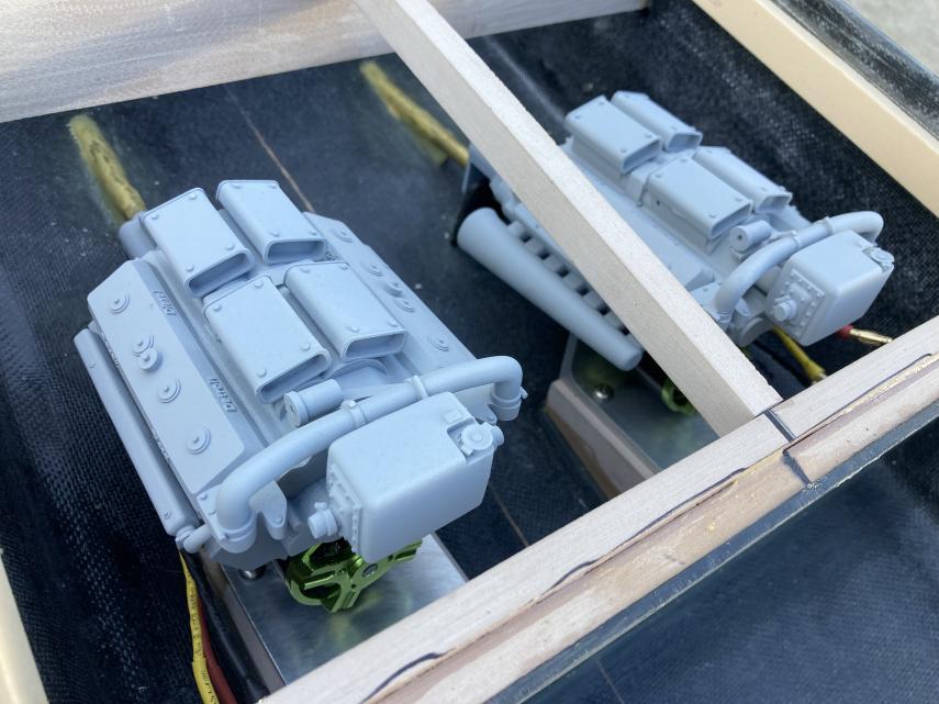

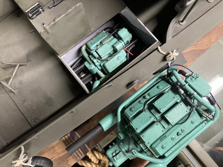

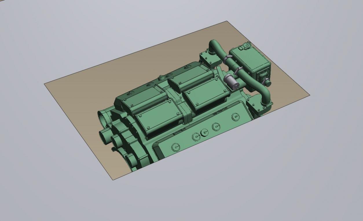

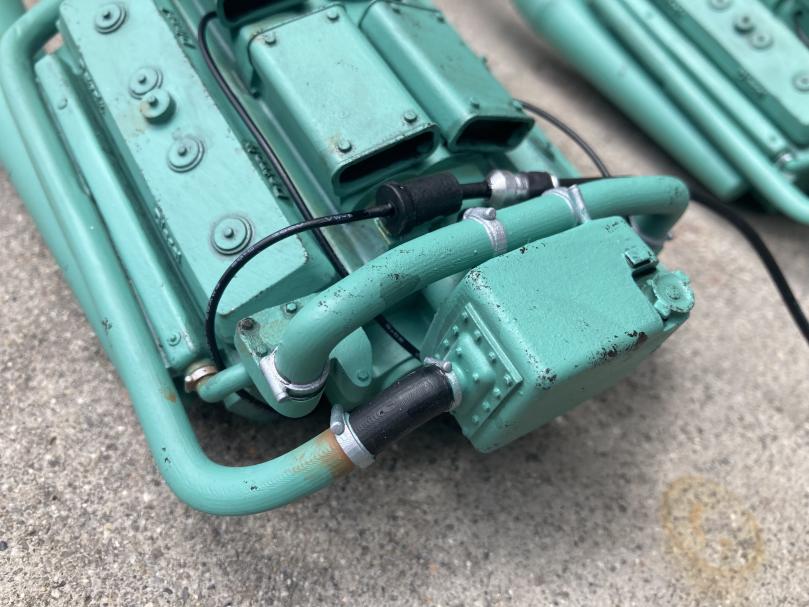

    Detroit diesels are finished and look good to me. Same methods but needed to be chopped up to fit in the resin printer.

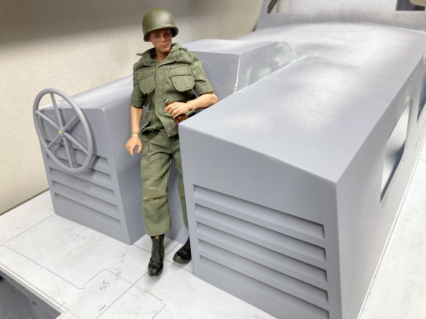

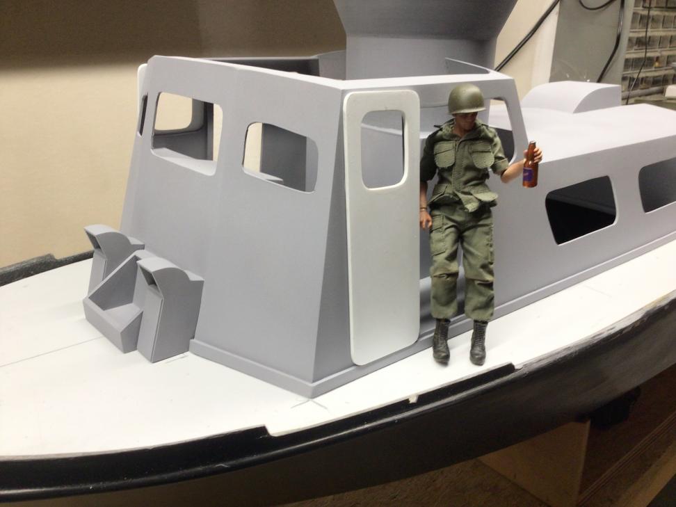

      Superstructure done entirely in styrene. Rear engine vents and details are printed and functional. Sound unit will sit behind the vents.

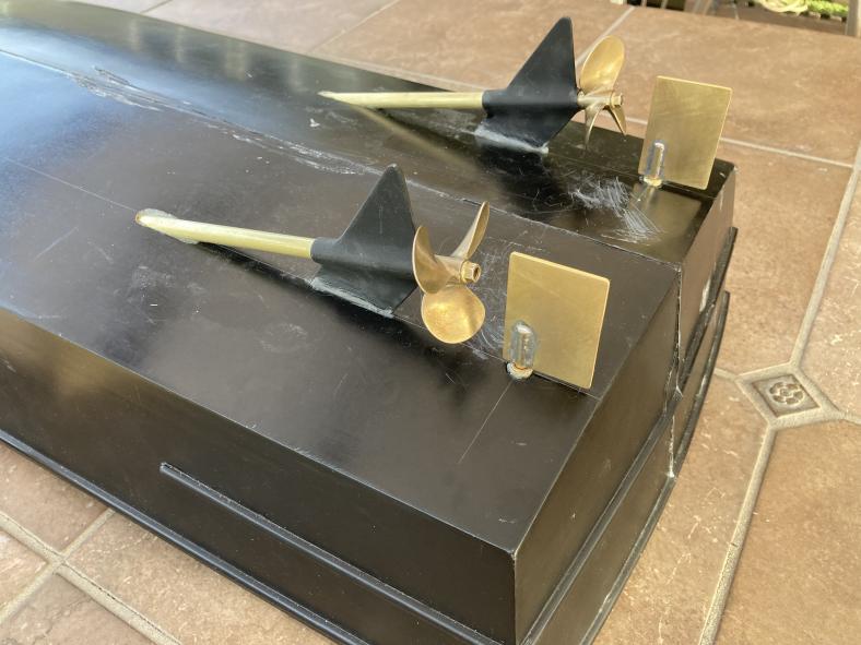

        Quick lake test with some dive weights added for future weight. Very happy with the performance and quiet driveline. Going to be a blast seeing both boats on the water.

          More work on the big boy this week. Sorting out the window frames and brass railing next.

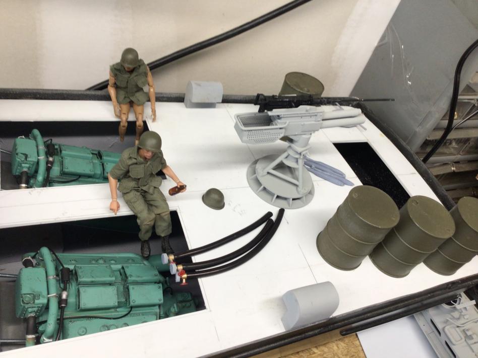

            PCF Swift is nearing completion. Just a few more details to go.
