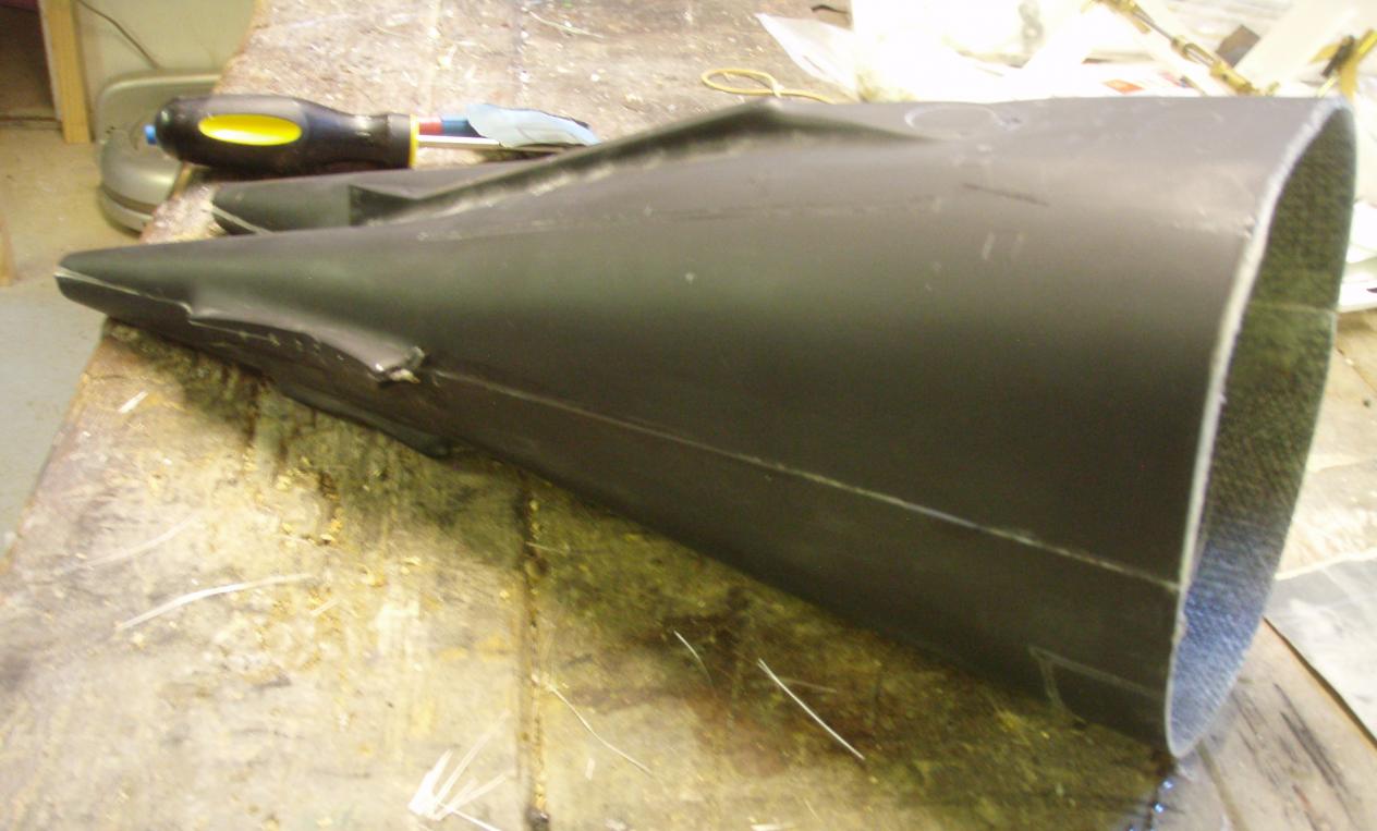

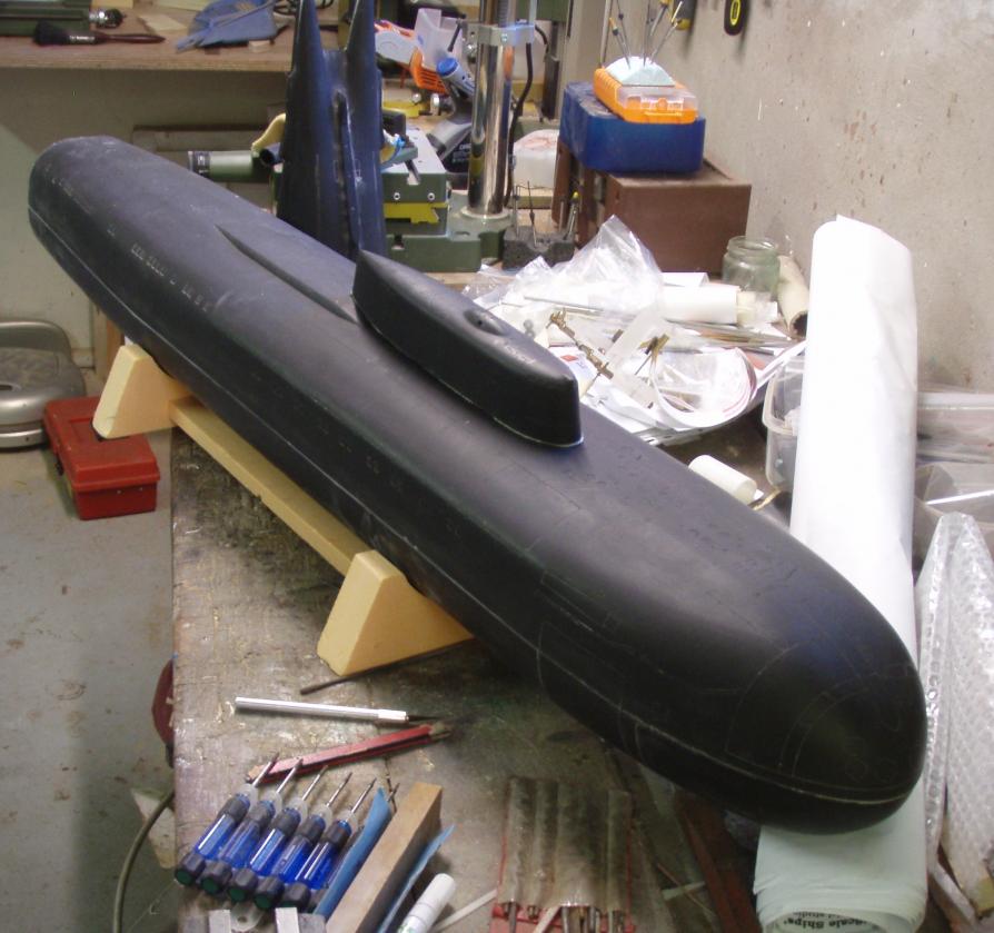

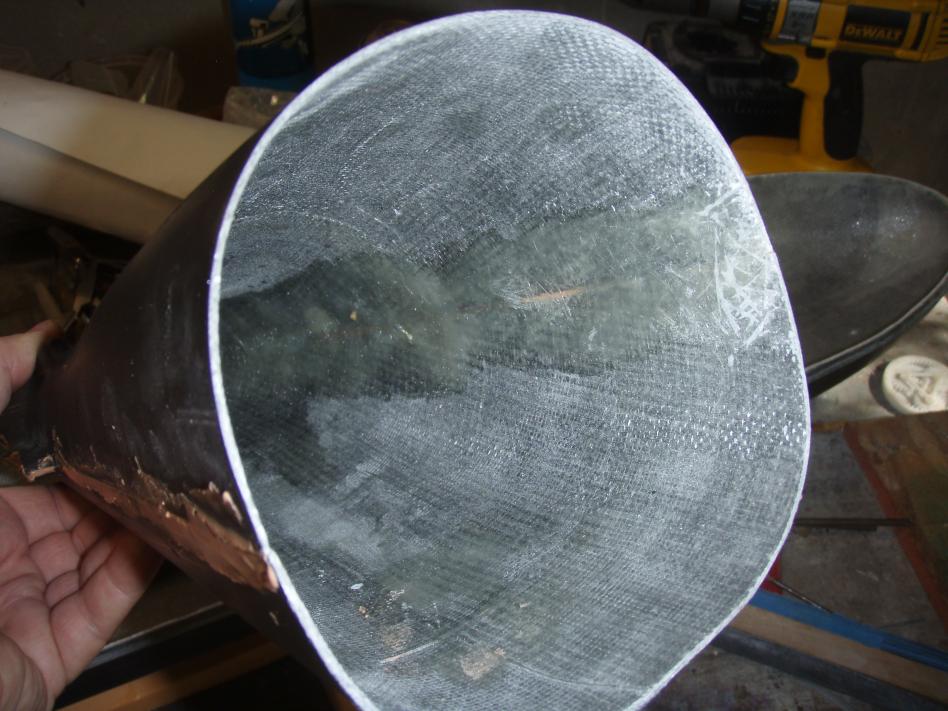

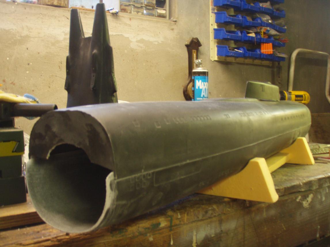

    Some photographs taken with the wife'sClick image for larger version
ID:	98240Click image for larger version
ID:	98241 ****ty camera. Mirco focus is crap but I have discovered that I need a bigger bench.Click image for larger version
ID:	98238Click image for larger version
ID:	98239 Vladimir was concerned that the Oscar matrix had deteriorated and caused a warp in the hull. I have to say that I can't find it. It all went together very well from my perspective. The hull is 3mm thick, very sturdy and beautifully scribed. Vladimir also gives good mast (just saying')

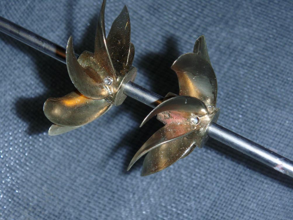

              OK> Here's my next little problem. I drilled and tapped the brass props so that I could fit a grub screw to mechanicaly fix them to the shafts. Standard M3 tap in a 2.5mm hole BUT the SS grub screws bind about half way in. An M3 bolt screws in without trouble. ?????Click image for larger version
ID:	98243 Is there more than one M3 standard pitch?
