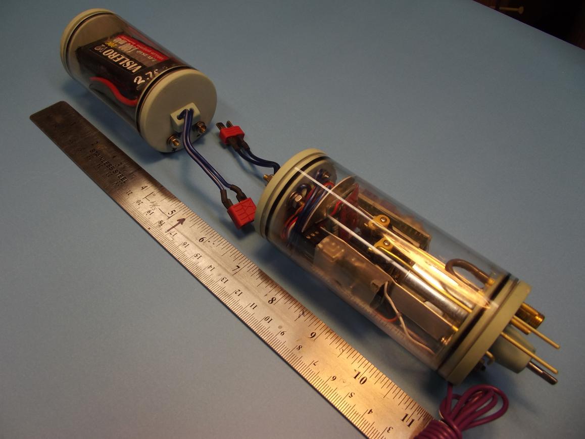

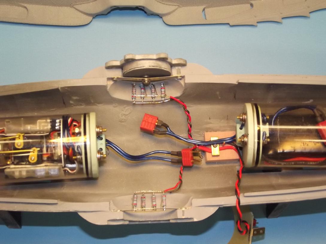

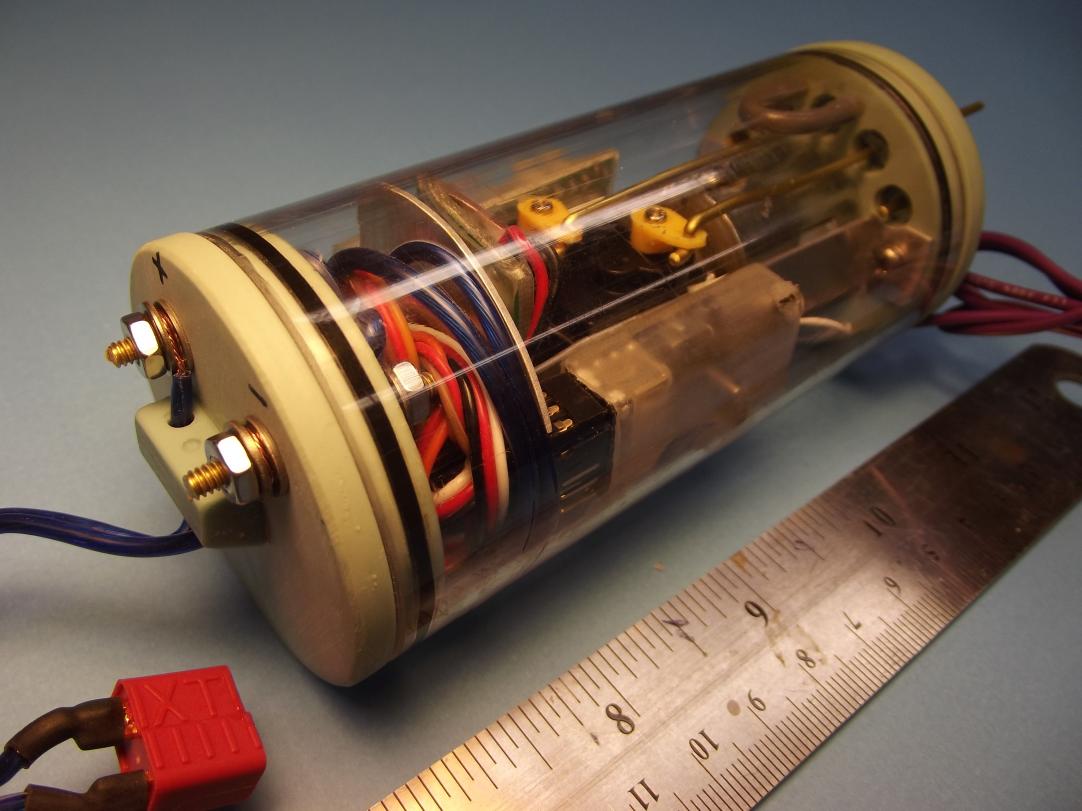

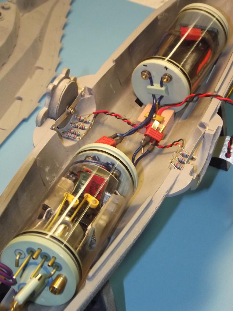

    Each wire you want to run in the wet (between WTC's, as you want) originates/terminates in a solid all-thread stud glued into the face of a cap/bulkhead. Complete isolation of the wire to the interior of the WTC. No flooding path between wire insulation and conductor -- believe me, it does happen!

        Servo leads too? if so, just run a flexible conduit (clear fish-tank hose) between WTC's and reeve the powere and servo wires through that.

              You start with 1/2" or so o.d. brass tube. Two of 'em, about 1 1/2" long. Set each into an access bulkhead and make watertight with plenty of CA. Get fish-tank flexible hose (vinal, I think) and get enough of that to serve as the conduit between the two WTC's. Run your cables and leads through that. Make the flexible hose to the brass tubes with nasty old hose-clamps.
              I learned this from Bill Hodgkins. In the ground now, but a big help to me in the 'day'.
