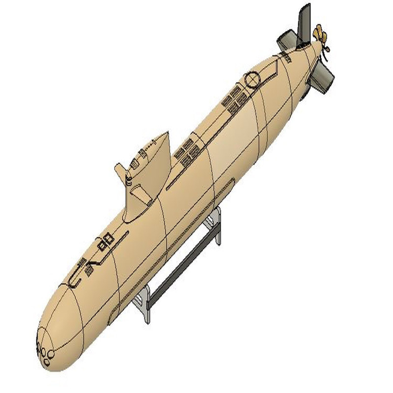

                          Pardon. I was seeing subcultures suggestion to print a S-80 the Spansh Navys new sub class. Many new interesting sub cllasses with AIP prlusion. No one is building just diesel subs any more, except maybe drug cartels. Sink those
                          The South Korean Navys new subs too...with vertical launch cruise missiles. Japan's new submarines with lithium batteries. Singapore's Navy.

                            I'll start with the S80, which seemed ideal at first. Is this project available on thingiverse complete?
                              • 2546
                              All the 3d files are on thingiverse. There is a link on that page to a website with some additional information.
                              ASA is a good alternative to ABS and a little less prone to warping. PLA is strong but sensitive to temperature. If you have an open printer just put a cardboard box perimeter around the printer to shield it from drafts.
                              To make your 3d printed hull super tough, you could add some epoxy resin and some thin glassfibre cloth on the inside of the hull, then you'll have some pretty much as tough as a GRP hull.
