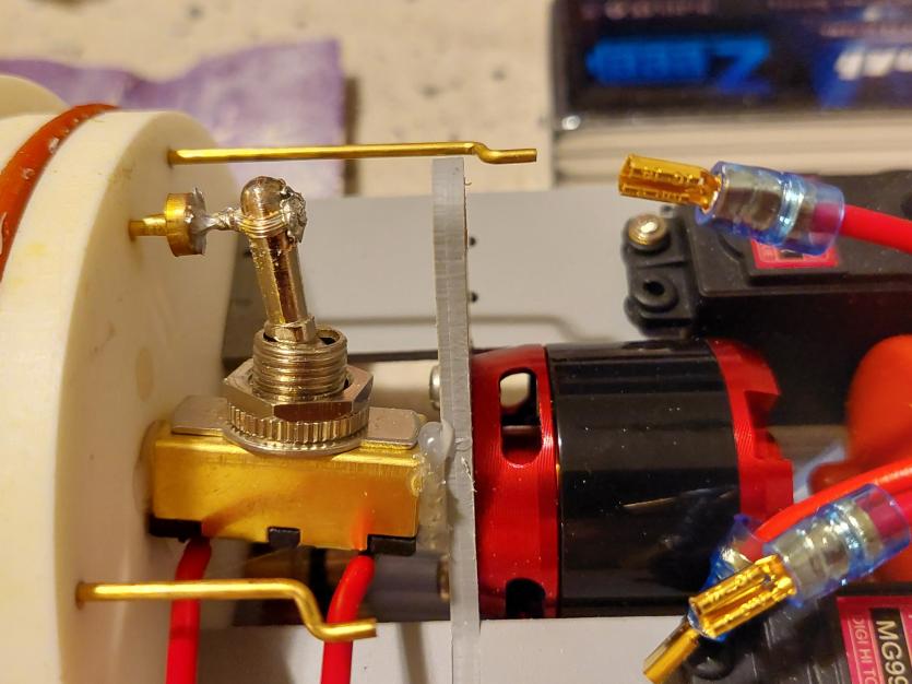

    Hey all,
    Dumb newbie here. I ordered a 100mm cylinder from R&R through the drydocks and I finally got it all wired up...almost. I went to turn it on and found that the switch was functioning as a momentary switch instead of an on/off switch as I was expecting it too, am I not using it correctly to get it to stay on, or do I need to change out the switch of an on/off switch? Looking online it is possible to convert a momentary switch into a toggle switch, but that would be way more complicated than just swapping it out. Here is a picture of the switch. Also, how the heck do you tell the ground on this thing, I blew two fuses before I realized I had ground and operating swapped, the ground is not brass as I have seen online. Looking at pictures, R&R usually does include a push button on/off switch, that is why I am thinking something is wrong on my end here.

    Yup, you're right, you need a on/ off switch, not a toggle, just order one and replace it.

      My R&R switches are push to on then push to off. This is dc so what is positive and negative depends on how you wire it. I don't think the switch is large enough to handle the full current load and should be used to replace the switch on the esc. I strongly suggest you add a circuit breaker coming off of the battery.

        I believe Ron said that he mistakenly got a batch of momentary switches instead of latching ones. Just grab a latching push button switch off of Amazon or wherever. Swapping out should take all of 30 seconds and you're off to the races.

            Swapping the switch to a push-push operation is the correct fix. I am curious about your shorting problem and why there are three connections to the switch, what does each lead do? Do you have a wiring diagram of what you're trying to accomplish?

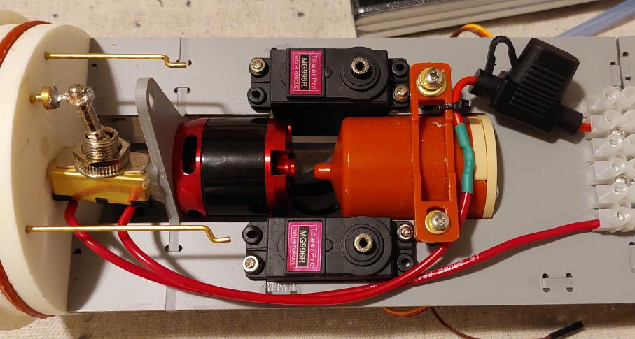

              Hey everyone, sorry for the long wait for recognition, I really appreciated all the help from everyone. In my search for a push on/off switch I found it incredibly frustrating to find one that either wasn't momentary or wasn't ridiculously small for my application. Here is the solution I went with, a 20A rated switch / breaker from autozone, no it is not pretty, yes it is probably overkill, but it gets the job done. It is interrupting mainline power to the components with a 10A fuse in series to hopefully prevent any component damage from shorts or over draw. if anyone has any feedback on why this wouldn't be a good idea, I am more than open to hear suggestions.
              Out of curiosity, how would I use a lower rated switch in the application of an RC submarine if not to interrupt power supply to all components, based on the size of the momentary switch I would have had a hard time believing it was large enough had it been an off/on switch, granted I have no idea what current draw will be like or if I just have no idea how this smaller circuits work, used to large MW 450VAC distribution, still adjusting to smaller circuitry. Click image for larger version

                A small switch just replaces the switch on the esc effectively turning the power on and off.

                  Looks like another place for a leak. Get a 15 a magnetic mission on/off switch. Bob sells them.

                    The placement of the R&R switch is a pain, as the battery is on the other side of the cylinder. What they offer works fine, it's just not idea. Remote or magnetic switch is a nice upgrade. Typical current draw on a sub wouldn't exceed 8A if you're running flank speed and cycling the pump.

                      Use a Magnetic Mission Switch!!! Get away from the over-sized, bulky and parasitic remote goober thing!!!!! :)
