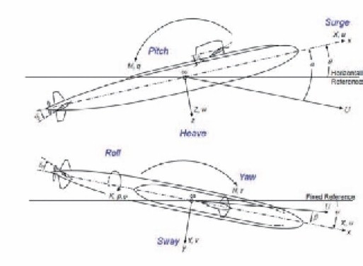

        Click image for larger version  Name:	skip-ack-snap-roll.jpg Views:	0 Size:	30.4 KB ID:	184086
        Both types of subs - surface optimized and underwater optimized will and both have the same dynamic stability if balanced and trimmed correctly. As all vessels everywhere do regardless of hull shape
        The modern sub models, higher underwater speeds and their resulting shapes, more dynamic forces then come into play in both the real and the models. Aircraft like maneuvering is now possible.
        Also, issues on some models of snap roll. But if the boat again is balanced and stable dynamically, easing off the speed or the turn rate will bring the model back to correct and be managed, as it is in the real boats. Science in action.
        Both 'WW2' 'and 'Modern' types the stability should be the same, but because of the operational speeds possible or not possible inherent in each type, one is very stable 'as a tractor', and the other very stable as a 'sports car' dynamically. Snap rolls should occur in extreme maneuvers only hopefully.
        Both types roll badly in heavy seas, just the nature of subs on the surface. Underwater, the differences are dramatic and fun. I doubt you will face such heavy seas issue with your models, if you are concerned about surface conditions. It you do, i'd be worried more about your radio transmitter then becoming a fatal lightening rod at that point. lol. As Merriman might say, pick a sub that gives you a hard on, and just build the damn thing, don't over think projecting ahead. The thinking will come building it
        Fun!
