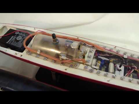

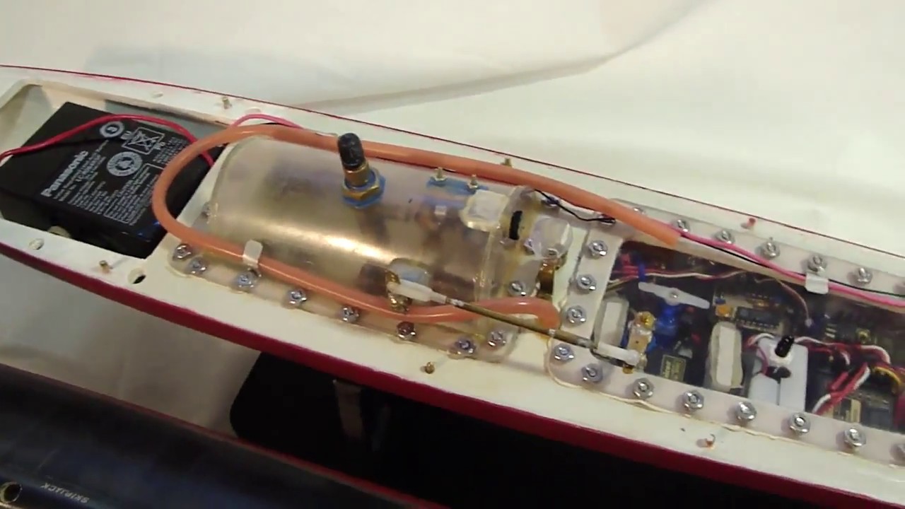

    Having met He Who Shall Not Be Named at Subex24 I will submit to the hide beating LOL. I see, by the way, from these photos how the sail plane linkage is set up now.
    So here is a question that will likely cause more of my hide to be shredded but what the heck, pain is pain: is the original conversion set of fittings and wtc gone forever or might someone lurking here have one that could be pried free? Otherwise the options seem to be R&R or making my own fittings etc and using a Bob Martin dive system. Again, my thanks.
    I sent the masters, tools, and parts to Nautilus Drydocks a few years back. Ask Bob if and when he's going to put those fittings kits back into production. I don't have any parts here, so can't help in that regard. But I'm available here for advice and 'encouragement' should you require.

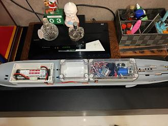

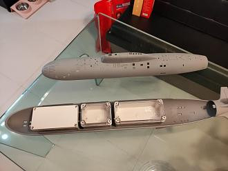

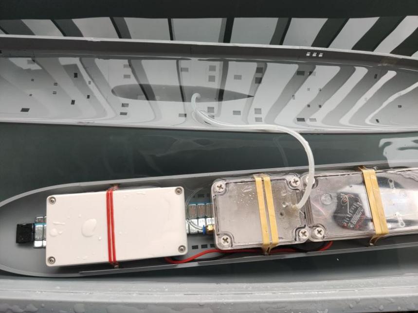

                Dan Kachur's scratchbuilt 1/72 Skipjack with semi-dry hull.
ID:	183246 Click image for larger version
ID:	183247 Click image for larger version
ID:	183248 Modular Watertight containers from waterproof junction boxes

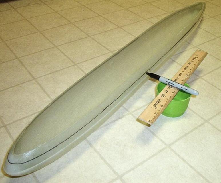

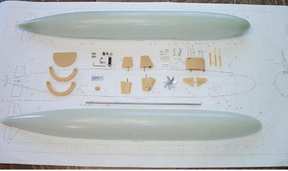

                        The PERMIT will be much easier to assemble and outfit with linkages and running gear. And making the Z-break on a perfect cylinder, capped by cones, will present less of a challendge than the fit of the 1/72 SKIPJACK kit. Here are some pictures to sell my points:
                        • Timothy L
                          • Sep 2024
                          • 249
                          Understood.and thank you. The photos illustrate a different upper/lower hull joining approach than appears in on-line instructions for the Permit. There’s still hide left lol - was that builders’s choice or different iteration? Haven’t located a Cabal report or Secret Projects report on the Permit Class.
                            • 14011
                            The pictures I produced were of a 1/96 PERMIT kit I originated for a guy who will, in a few years, go commercial with kit sales. But, it illustrates the basics. Mr. Thor's kit provides a substantial raised equatorial running seating flange which makes assembly of his kit all the easier. The pictures you provided shows this to be an ideal 'starters' kit. I assume you have previous r/c vehicle assembly, maintenance, and driving experience.
