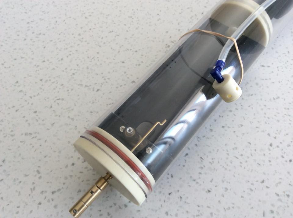

    R&R cylinder is a Static system.
    Tube is NOT a snorkel but a vacuum break to relieve negative pressure inside the ballast tank.
    Operates similar to this https://youtu.be/RqnxuMlmhkA?si=Tek8LCcum06BjZ1N .
    Instead of a restrictor or solenoid valve, R&R uses a simple float valve. Click image for larger version

      Thank you very much for your help and the videos. I am not 100% clear as to what use of a valve accomplishes. If, I am following the video correctly, the valve prevents water from re-entering the chamber while the snorkel tip is still underwater. Correct? Is the solenoid possibly just a bit more reliable than a float valve? And if that is correct and one does not know how to program Arduino circuits, where might one purchase the Arduino Control circuit and solenoid? And finally, Is there another system that might be better suited for the Skipjack Or should this system make a perfectly fine operating sub? Again thank you so much for your help.

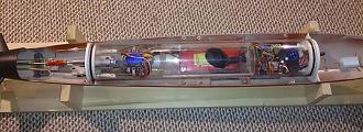

          This is Nate He's Skipjack with vented tank with servo operated switches/pinch valve.
            3D printed conversion kit from Maximus modellbau
            https://cults3d.com/en/3d-model/gadg...imus-modellbau
              Click image for larger version  Name:	DSC_0071.jpg Views:	0 Size:	82.2 KB ID:	183162 Tim Senecal made his own WTC with pump and bladder ballast system using the pump from the Thundertiger Neptune and a balloon.

                  The float valve partially (not fully) seals off the vent, consequently the pump is able to empty the tank faster then any additional water can enter, permitting the tank to be emptied whilst still submerged. Once above water the float will drop away exposing a full vent and allowing the tank to return to atmospheric pressure.
                  It's a simple system that's been around for decades.
