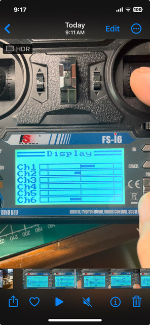

    Servo issue
    Click image for larger version  Name:	8C2F1203-15DC-43C8-9C8E-D446571DB776.jpg Views:	0 Size:	79.4 KB ID:	180790
    Channel 2 input causing channel 2 movement, no mixing on, it seems to be the TX as the display shows

    Not sure what the issue is you're unhappy about.
      • 1959
      So... it's not mixing when it should be?
        Its mixing when it should not be, channel 2 input also sends a signal to channel 1, I said earlier incorrectly, sorry!

          Okay that makes some sense now.
          looking through the manual for this TX, it looks like the channels are preassigned by the manufacturer. Channels one and two have an elevon mixer, and although you say you have no mixing I’d be inclined to check that isn’t active.

            Thanks, I had mixes on, then turned off, re powered the TX and it shows no mixes on. Cheap TX. I may rebind using a new model selection and see. I will look again at the fact that you found regarding the elevon mixer. Thanks for trying to help as always!
