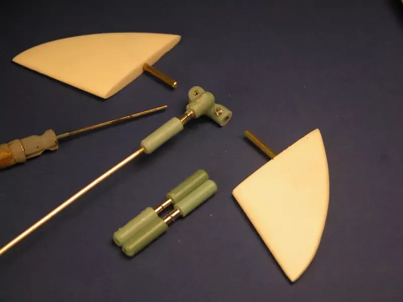

    I'm speculating of drilling and tapping one of David's resin fittings kit to accept a set screw, drill and tap the same way as plastic?

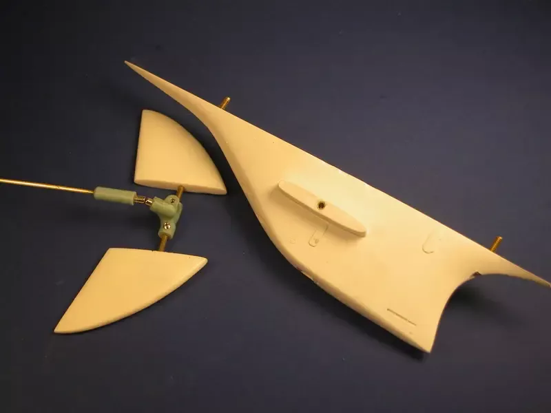

        want to split the sail plane shaft of the Moebius Seaview like this. Click image for larger version  Name:	saKutz.webp Views:	0 Size:	10.1 KB ID:	174635 Click image for larger version  Name:	A0f5nB.webp Views:	0 Size:	13.5 KB ID:	174634
        Is that an M2 x 2mm stainless set screw?
        What size drill and tap?
          Metric is the Devils tool.
          3/32" drill hole, tapped with a 4-40 thread. Speak Imperial or don't speak at all!
