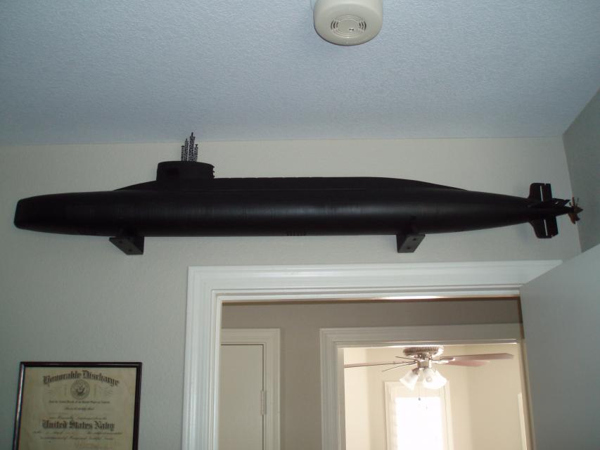

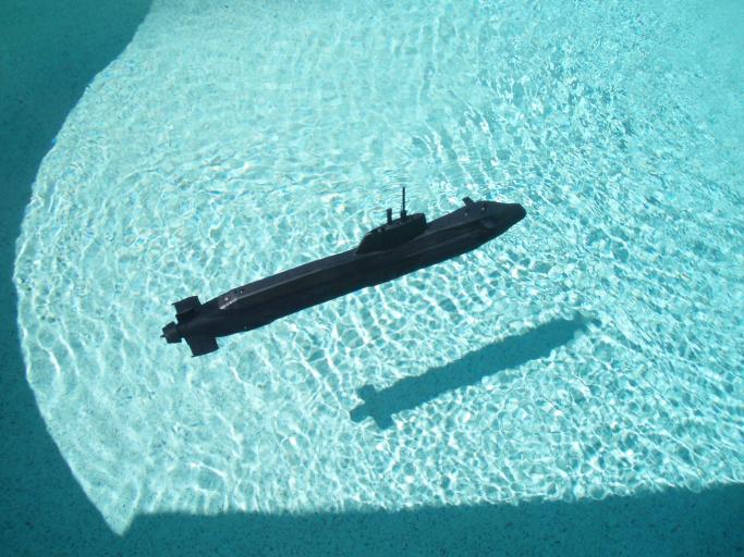

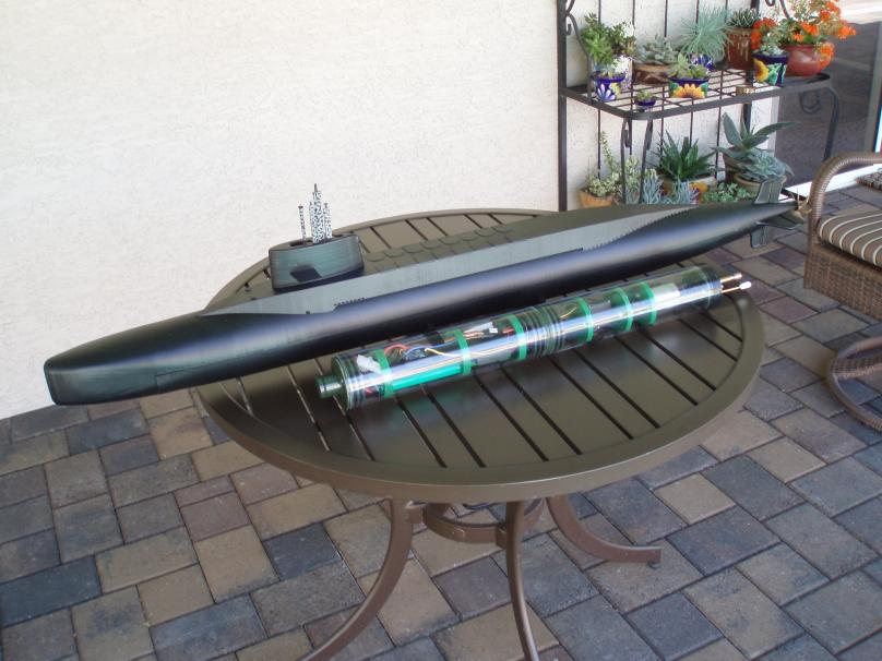

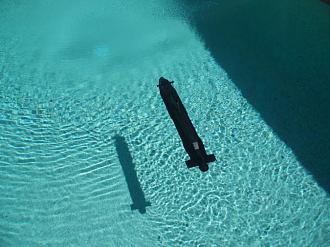

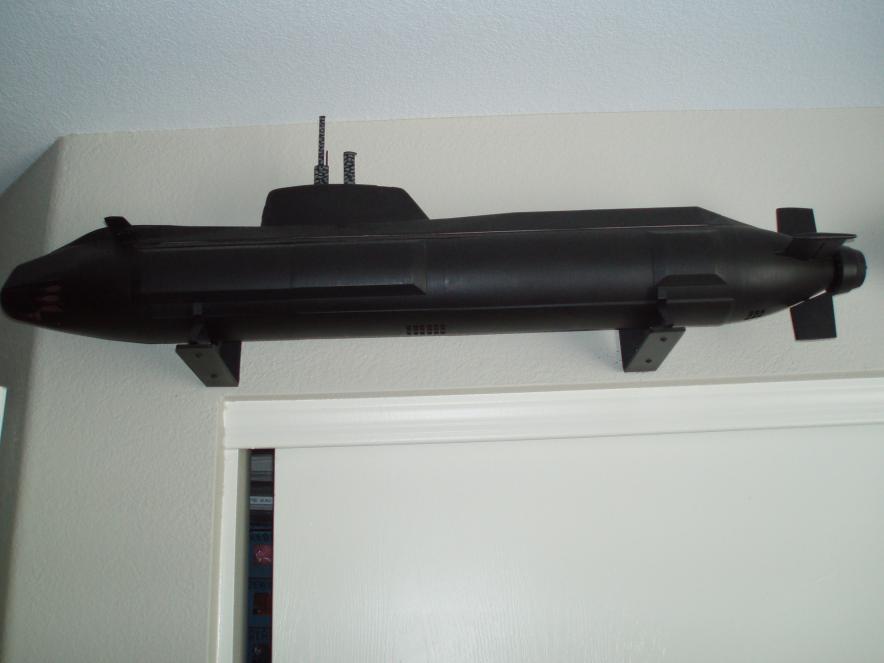

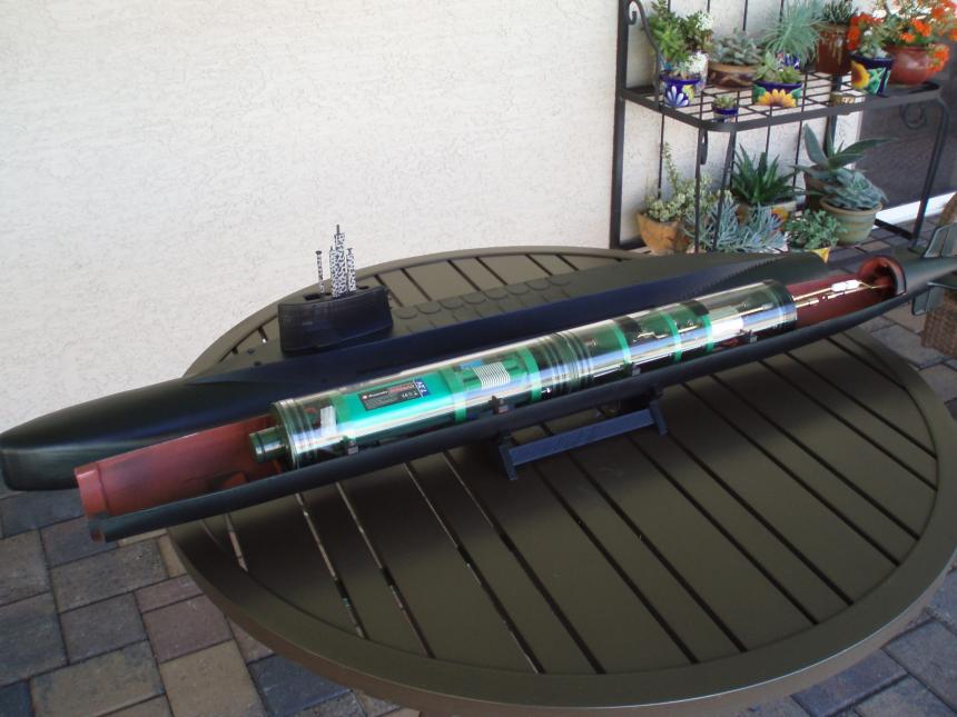

    The photos below are two boats (1:96 Scale British Astute and the 1:96 Scale French Redoutable) 3D printed PLA Are both about 3.5 years old.

    My boats only get run in our pool and only the Fall and Winter time here in Arizona. Summers are just way to hot for PLA boats. They both have been in the pool (chlorinated) 12 to 15 times over that 3.5 years time.

      Rob,
      No cracking, delamination or sagging? That's good to hear.
