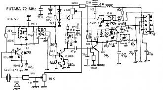

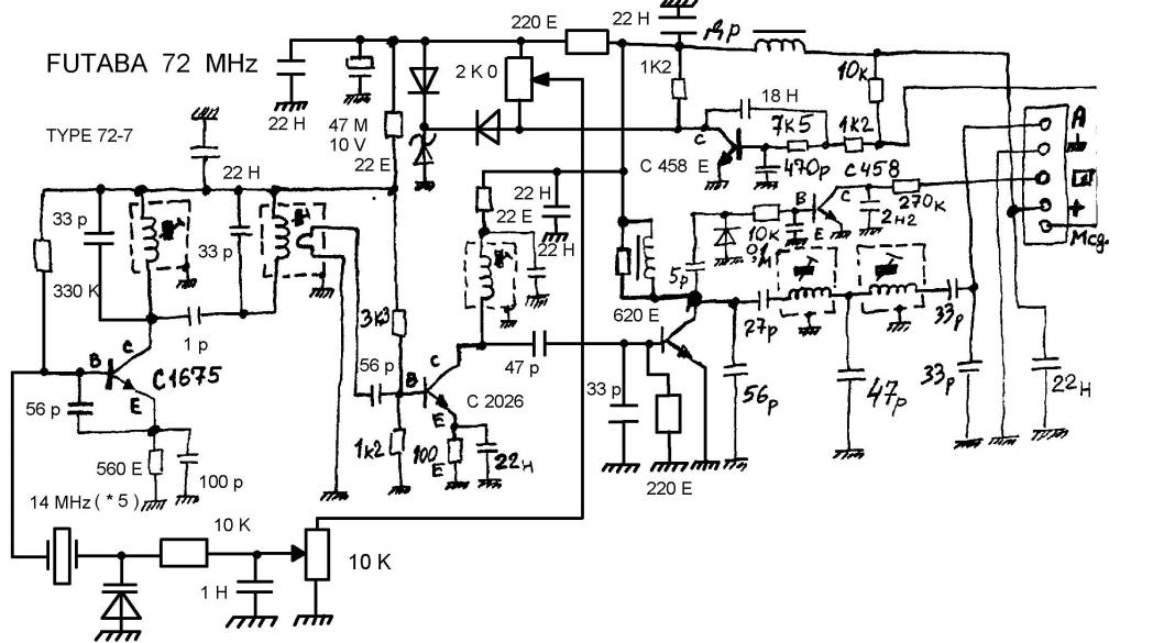

    Of course you can use Arduino, as it is a micro control module. For any frequency that's your choice as long as it is legal for the surface frequency in your country. For your another question, why can't we use 27 mhz toy transmitter, it is just because they just use infrared remote control.The drawbacks are also obvious: the remote control range is too short, and the fact that you have to point the antenna at your remote control toy. Traditional RC model plane transmitters have a high frequency circuit section where the ppm or pcm signals are sent out at high power to increase the RC distance.
    RF circuit for futaba FM radios:
Name:	Futaba 72mhz 高频头电路.jpg

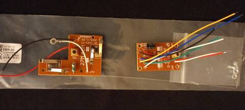

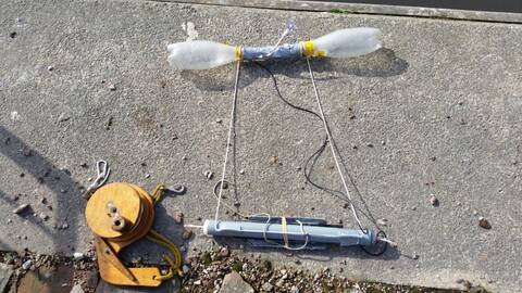

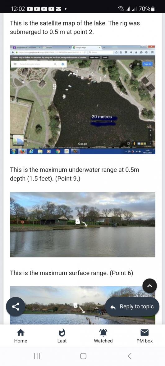

          Someone over at the AMS range tested one of these radio submerged at 0.5m (1.5ft) Click image for larger version
ID:	172596Click image for larger version
ID:	172597Click image for larger version
