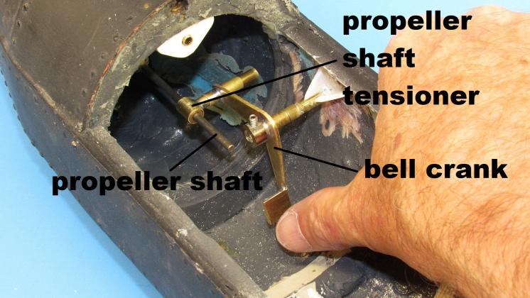

    Since the surfaced HUNLEY had so little freeboard (surfaces above waterline) you only need about five ounces of ballast water. Have Bob assemble your SubDriver that way. The rest is on you. I'm assuming a model length of about three to four feet. and a nominal wall thickness of about .093". Also assuming the density of your printed material to be close to one.
    It'll work submerged, without cheats, just fine if you keep the speed below that which produces forces that overcome the models static stability about the pitch axis. That's because you have no stern planes to manage the bubble and can only rely on static stability (low c.g. coupled to a very high c.b.) to keep the boat from porpoiseing uncontrollably.

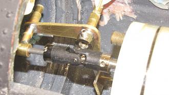

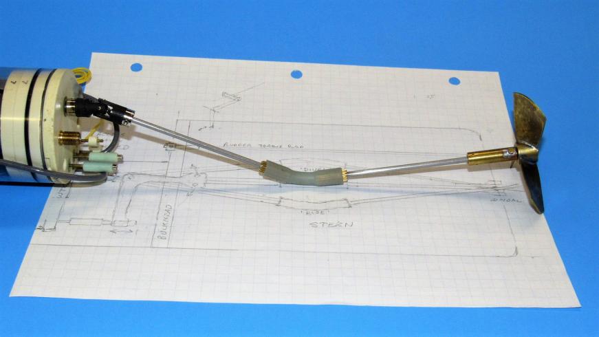

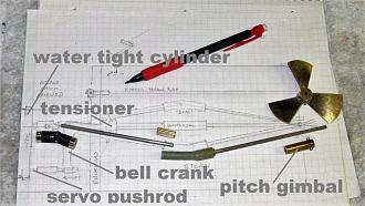

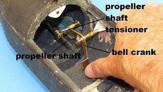

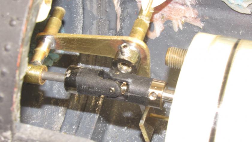

    But, if you want the boat to be more manageable underwater, gimbal the propeller in the pitch axis and us it as a 'propulsive set of stern planes'. Works for me.

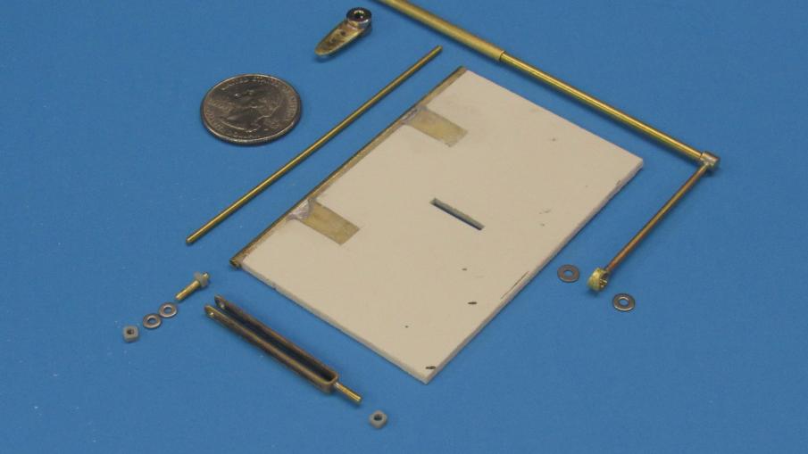

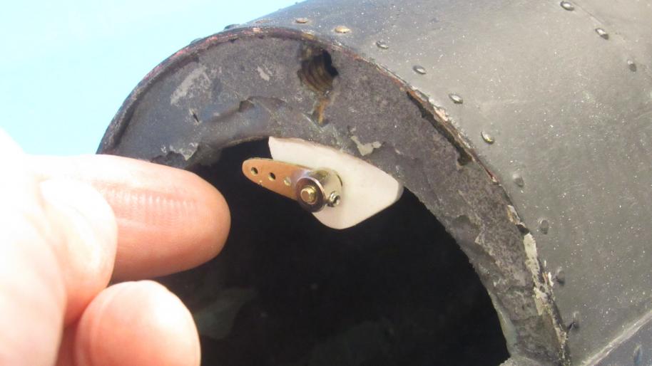

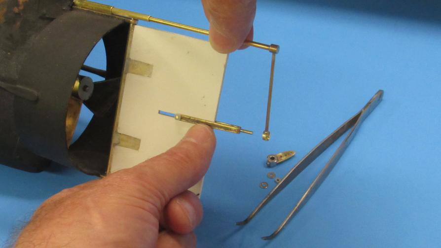

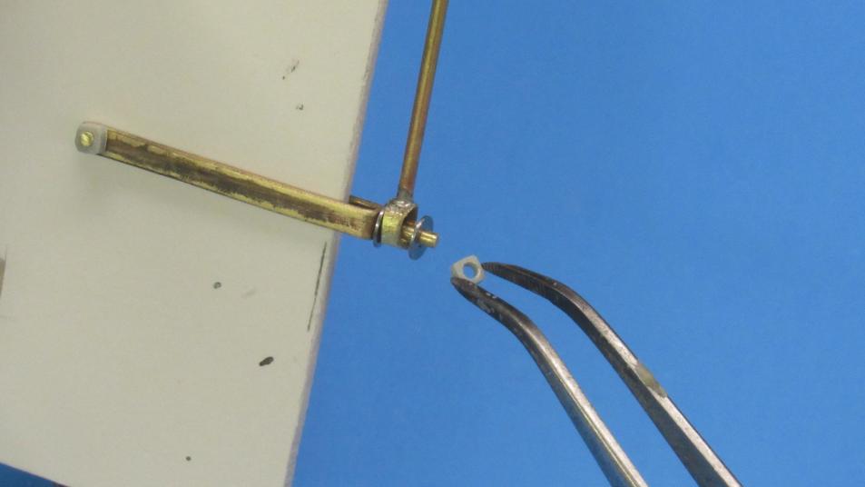

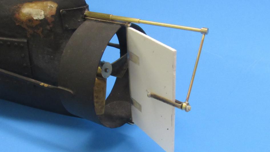

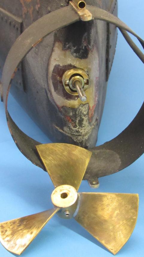

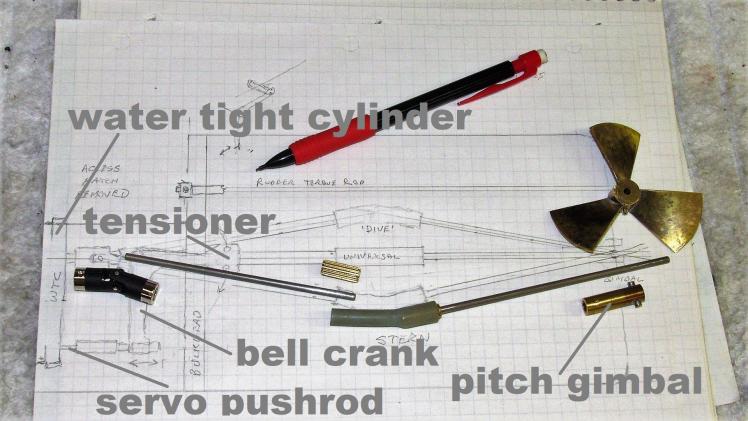

    And here's how to work out a scale rudder linkage:

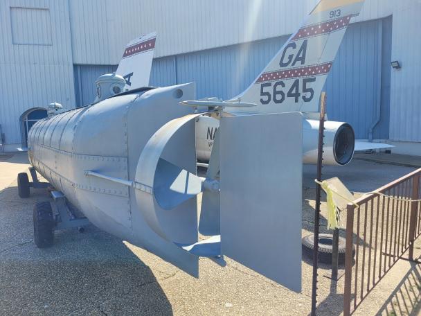

            If interested there is a Hunley at Mobile AL, i was there this past weekend to photograph the USS Drum and saw this by chance. (note I have more photos if interested), Khim

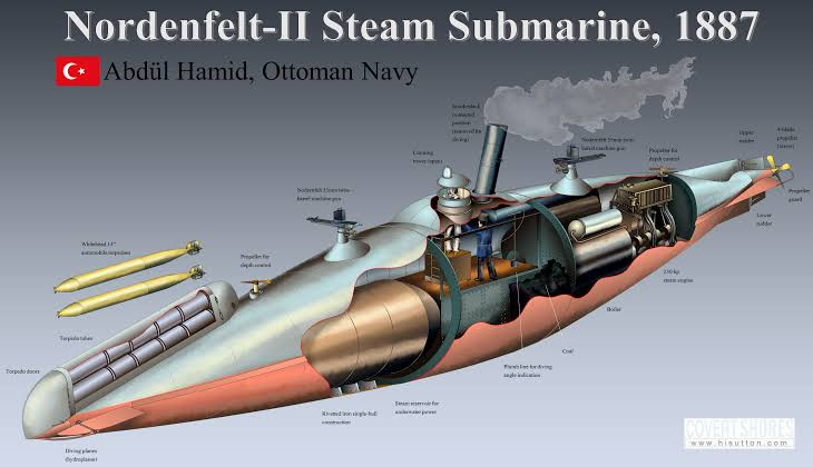

              How about this steam powered submarine? Click image for larger version

                  What's complicated about the Nordenfelt boat? I'm just suggesting the design NOT make an ACTUAL steam powered submarine.
