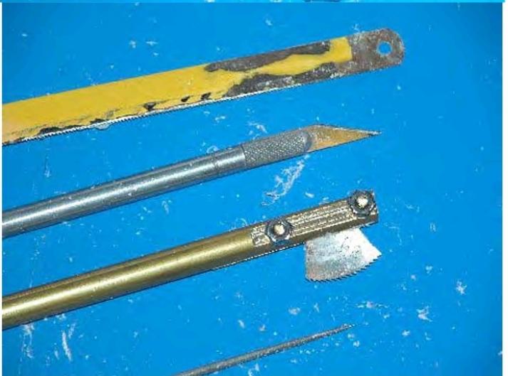

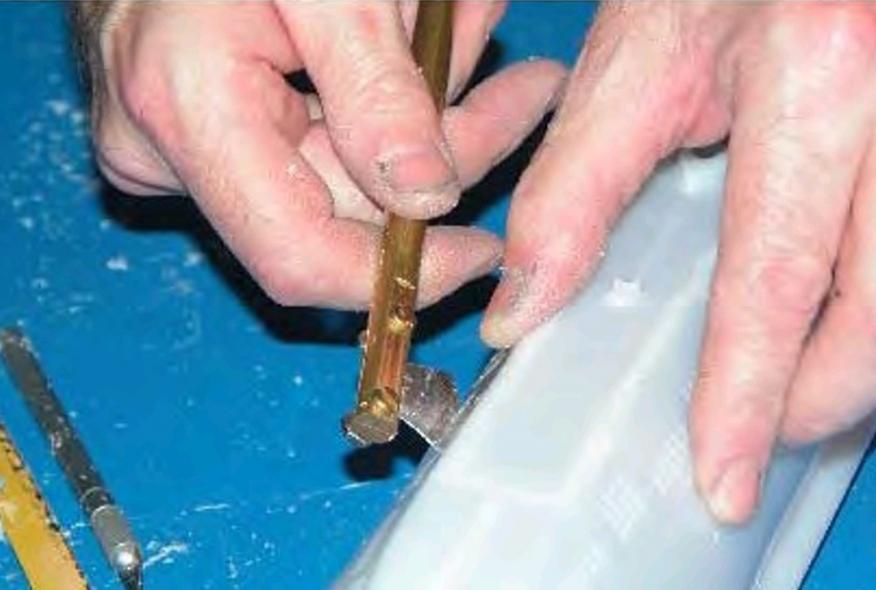

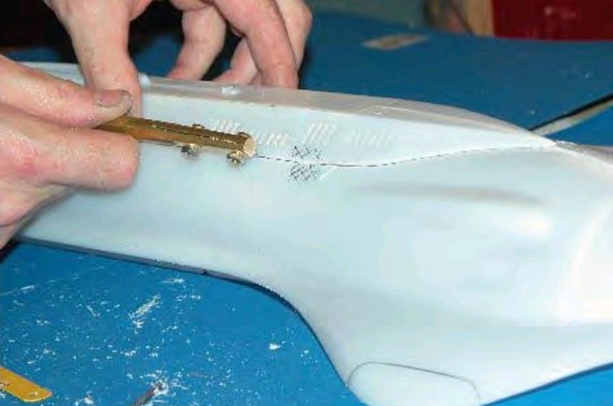

    What is the axe shaped tool, how did you make it and when do you use it? Click image for larger version  Name:	Screenshot_20221213_231424.jpg Views:	0 Size:	44.4 KB ID:	167749Click image for larger version  Name:	Screenshot_20221213_231346.jpg Views:	0 Size:	44.0 KB ID:	167750Click image for larger version  Name:	Screenshot_20221213_231213.jpg Views:	0 Size:	47.2 KB ID:	167751

    Yup. I made it from a three-inch diameter disc saw. Cut a groove into a length of 3/8-inch brass round stock and inserted the section of blade into the groove and used two machine screws to compress the rod to hold the blade securely in the brass handle.
    Used to achiever very low kerf cuts in curved sections. Such as the leading and trailing portions of the SEAVIEW's superstructure.
