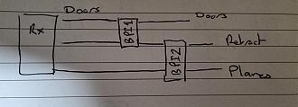

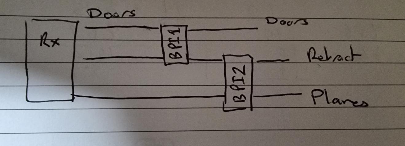

    Hi All.
    As I have both bow plane doors and retracting planes, is it possible to run two bow plane interlocks to lock out the retract as well as the planes?
    Thanks in advance.
    If the doors are on a separate channel, I'd say that would work, but it would be simpler if you put the retracts and doors on the same channel, though it might be more problematic to time (IE: doors open and THEN the planes extend).
    But back to your original query, I haven't seen it done yet, but I think it should work!
            Bob
            Thanks all.
            The Futaba manual was a struggle but I finally got this working. A mix with both channels on the same switch, with a delay on for one function and a delay off for the other.
            Thanks, Colin.
