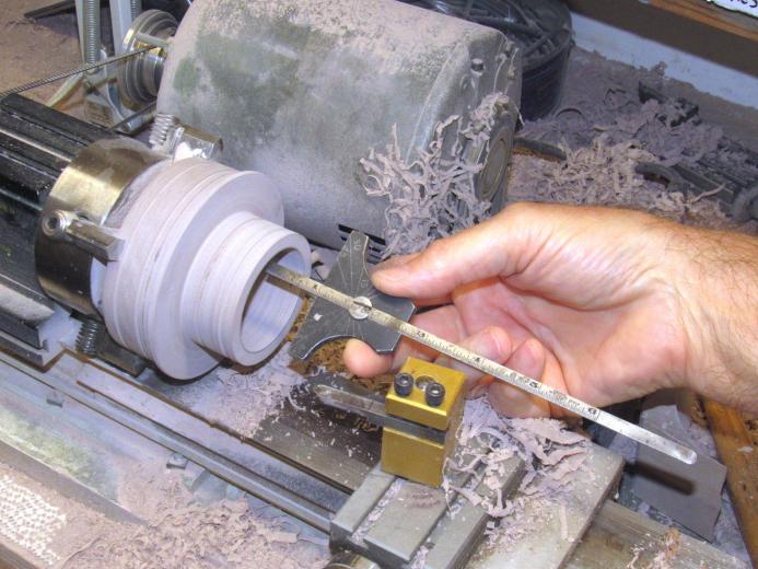

            • 13997
            Originally posted by Titan II
            Nope.
            Not suitable for lathe or mill work. Foamy center, hard surfaces; like hard candy with a chewy center. Also marketed as 'Sentra'.
            Find a piece of 40 lbs. per cubic foot RenShape and you're golden.

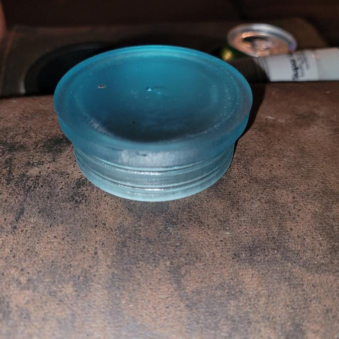

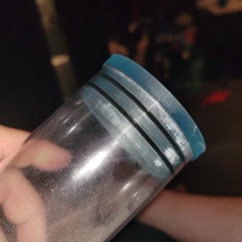

                • SubICman
                  • Jun 2022
                  • 87
                  I've started 3d printing my own end caps. Tube is 1/16 Pollycarbonate, and the endcaps are printed using clear blue elegoo resin. They were modeled in solidworks using the o-ring groove tool. Each print takes about an hour and a half.
