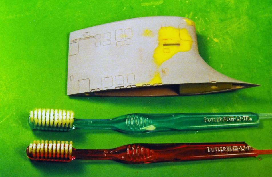

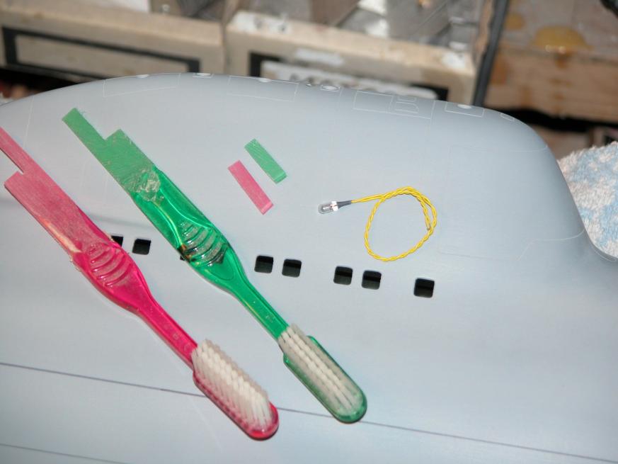

            Continuing my build modeling the San Juan .... I'm trying to get the lighting correct.
            I assume there is a RED light on the port side of the sail and a GREEN light on the starboard side of the sail, are these lights under the clear covers as per the arrows ?
            I assume there is a yellow light on top of the snorkle 1 flash/sec for 3 seconds then off for 3 seconds and a white stern light on top of the rudder ?
            Is there a white mast head light ? located where ?
            Thx for your help, Khim

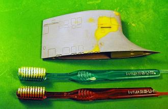

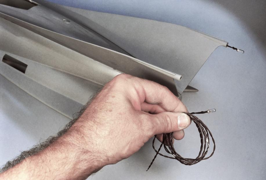

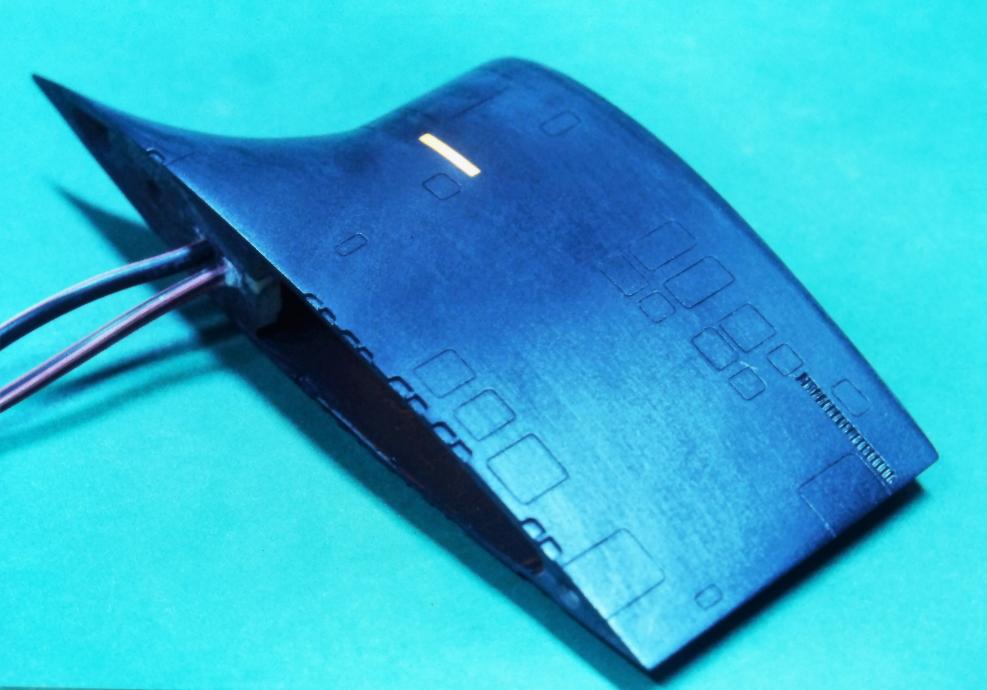

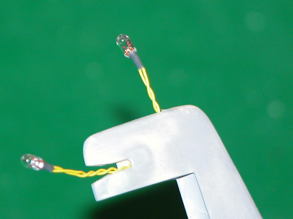

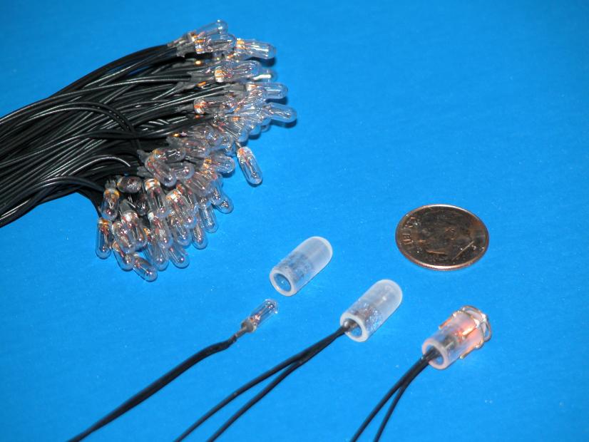

              The port and starboard running lights: The lens (covers you call them) are tinted, the bulbs are white.
              The 'submarine identification light', atop the snorkel, has an amber lens.
              The anchor/stern light is white.
              The mast head light is portable.
