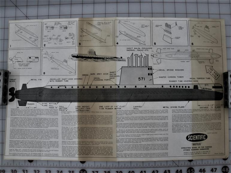

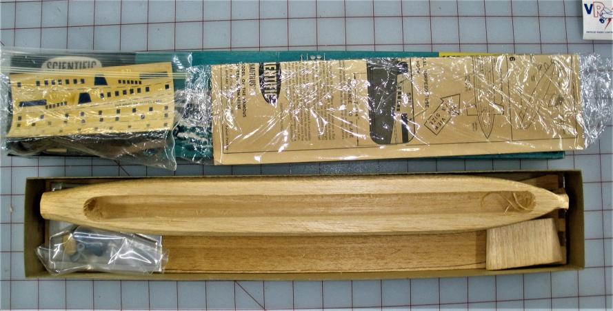

                  I have been flying R/C since 1960, gliders, free flight and u-control since I was 6 or 7. I think I remember also seeing the photo of the sub you describe. No it was not mine. The sub I built came from a Scientific Models kit. It was one of the first models that I built by myself without my Dad's assistance.That was around 1954. I recently found one of the kits. Here are some photos.
ID:	159169Click image for larger version
ID:	159170Click image for larger version
                  The sub kit was designed by Walter Musciano and worked amazingly well.
                  John
                  "Now here's another fine mess you've gotten me into."
