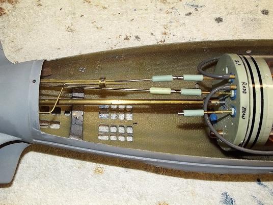

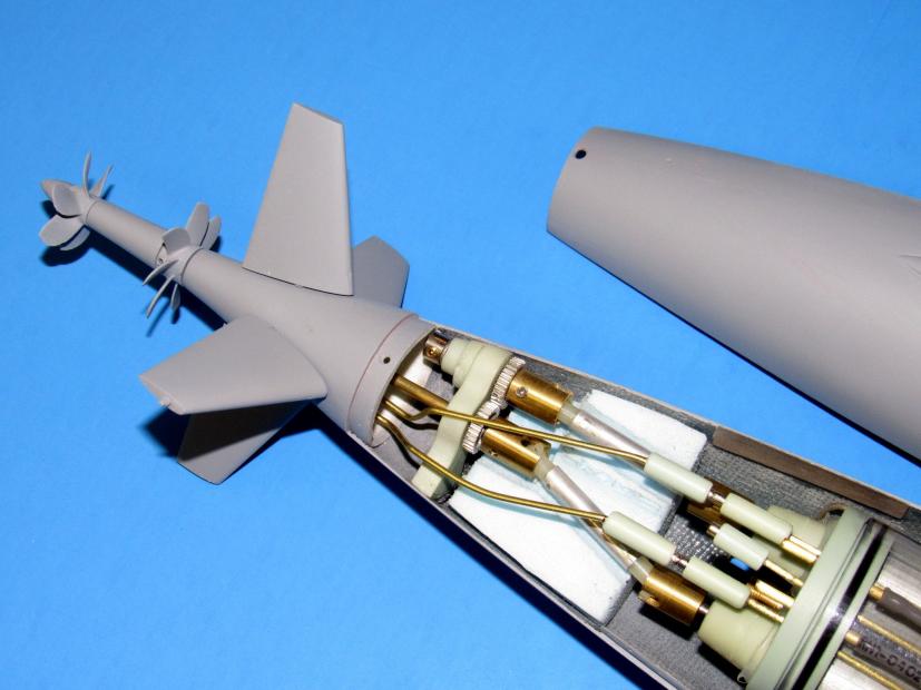

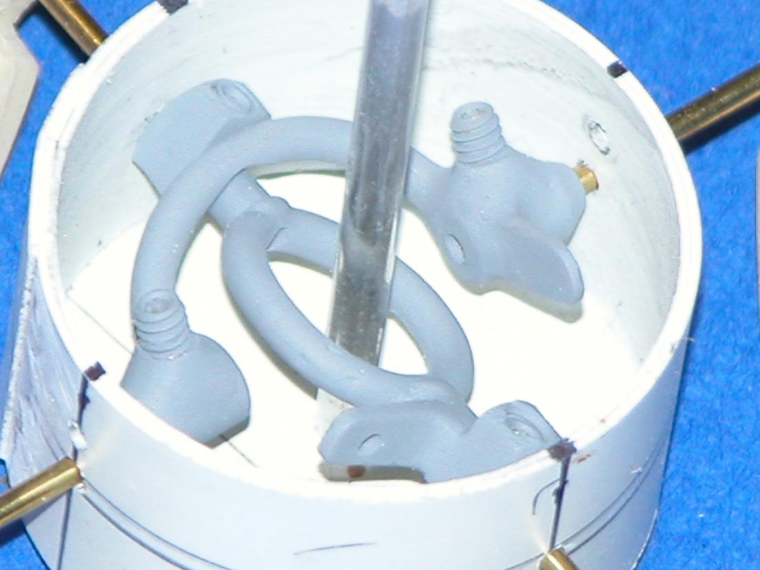

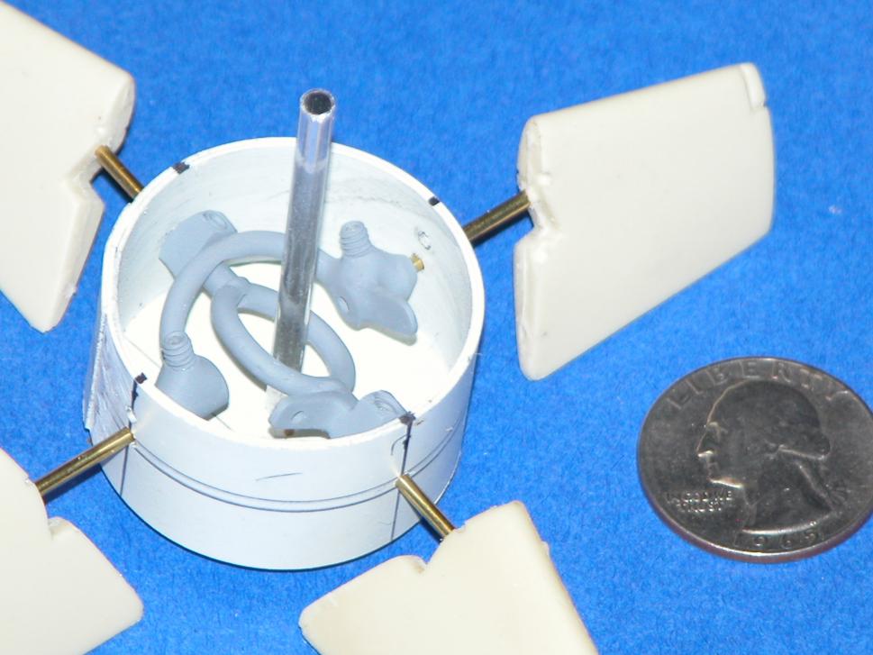

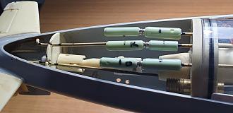

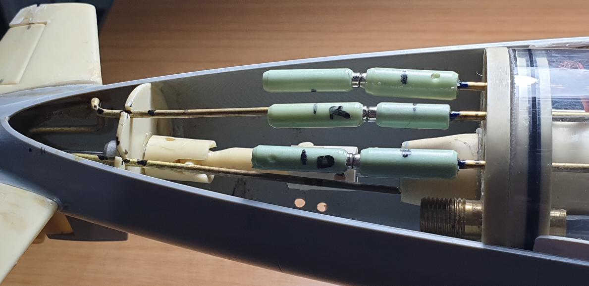

    Looking for photos of the control yokes for the 1/96 Type 212 or Albacore. I know downloaded them years ago but can seem to find it on my phone or laptop. Need it for reference for a 1/144 Soryu I got. Thanks.
    • 14014
    Here you go:

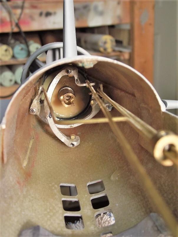

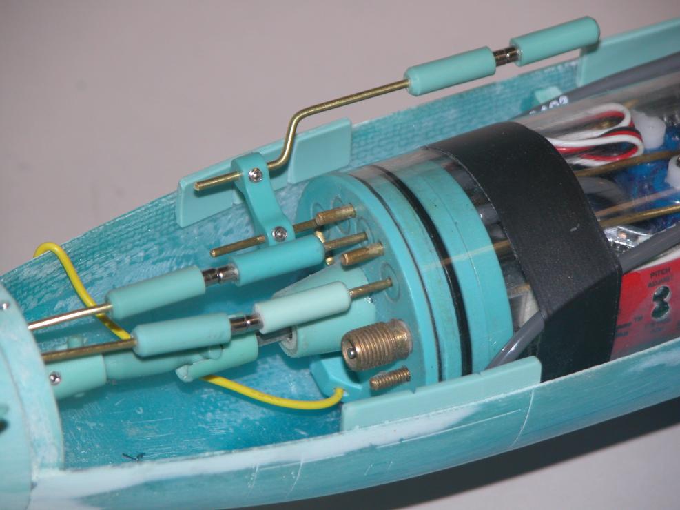

      Also found something else very useful for the Kilo front dive plane.

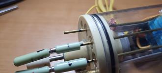

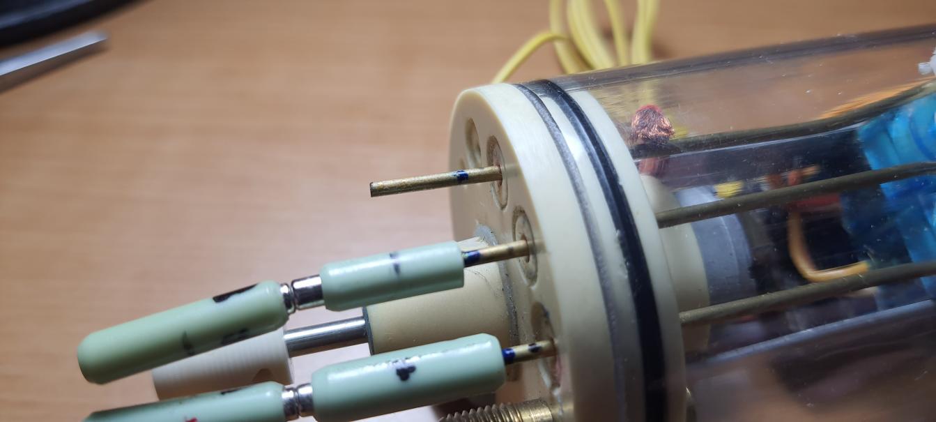

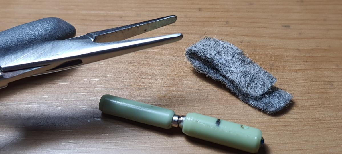

      Any tips how to remove a CAed Klik-on from the port side output shaft?

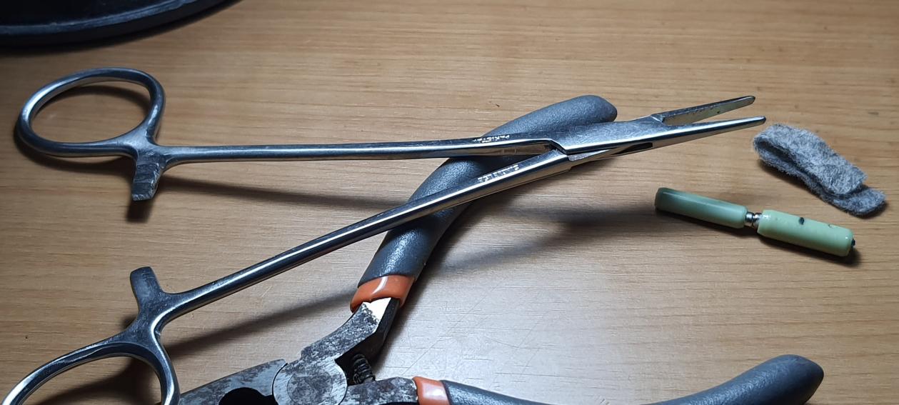

        Grab the brass pushrod with soft-jaw needle-nose pliers, grab the magnetic coupler with your twinkies, and twist it. Hard hard is that?!...
        You people!
          Didn't have a soft-jawed needle nose pliers, so I used one of my needle holders.Click image for larger version
          It looks just like a hemostat but has some jaws. It's used to hold suturing needles during surgeries. High end ones even have titanium inserts. This is just a cheap Pakistani one.
          Close up of the jaw. I used a piece of felt to further protect the control rod surface. Click image for larger version
          Success. Click image for larger version

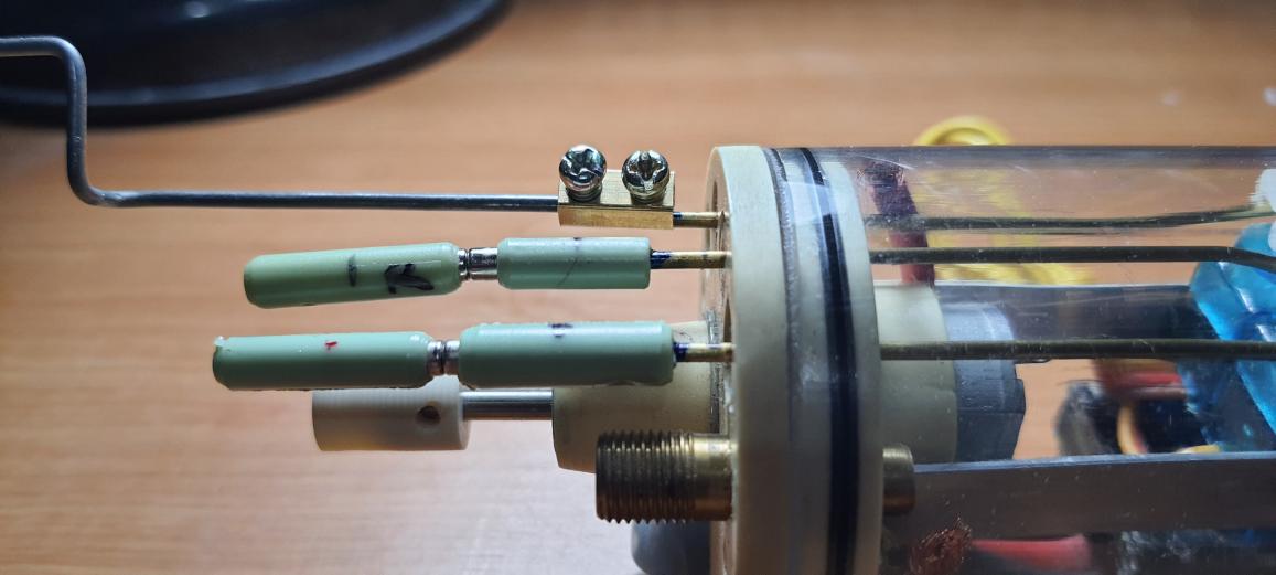

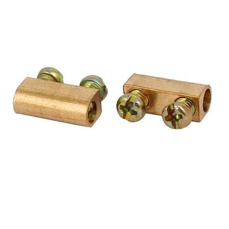

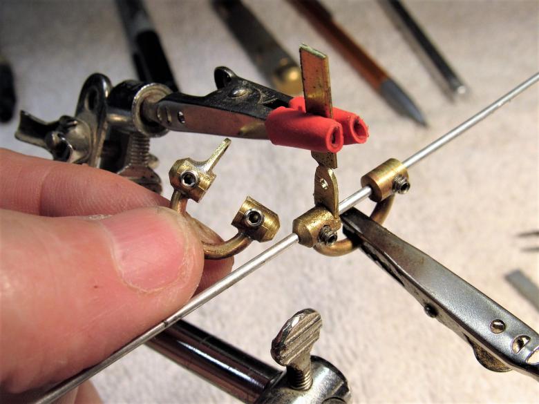

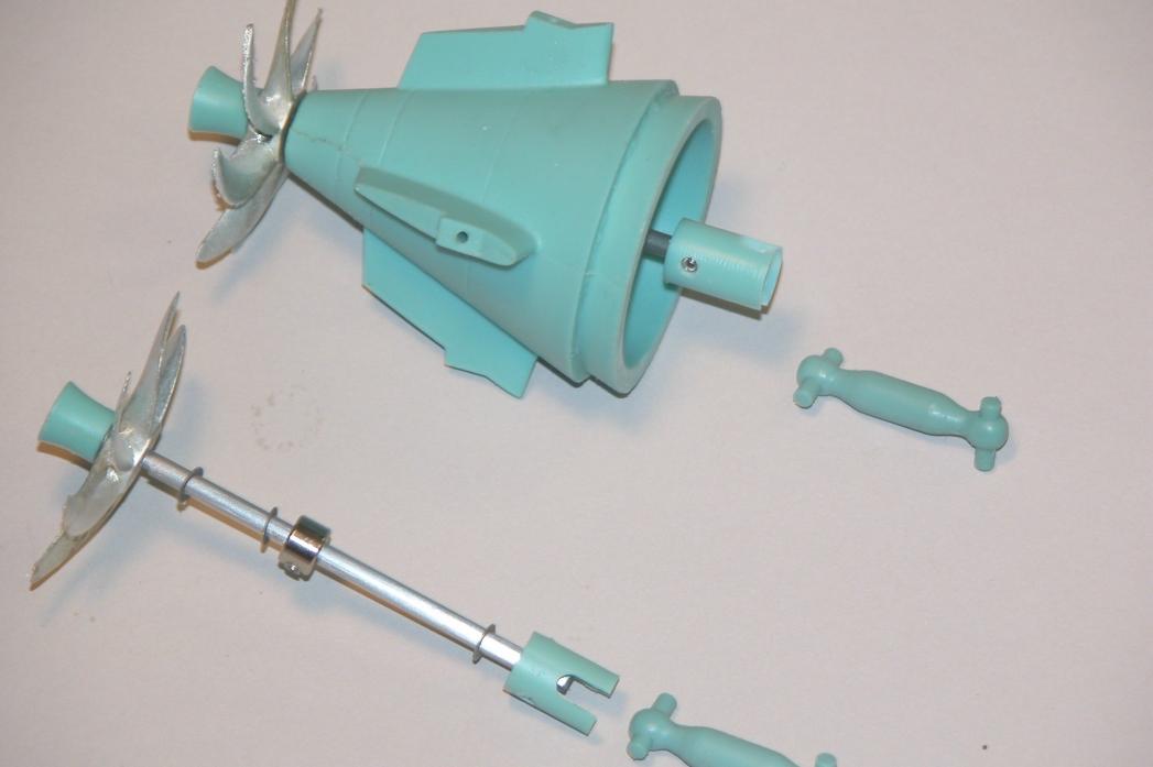

                    I still haven't check mine yet but isn't that dumbbell connector for the bow plane servo included in the standard 1/144 Seawolf fittings kit? If not, I'll just fab one from some brass connector block. Click image for larger version
Name:	images (20).jpeg
                      Turns out the hole that runs through the connector block can accomodate 2 of the 1.6mm servo output control shaft side by side. The 2 screw locks them down tight.
                      Saves me the effort of soldering.
                        • 14014
                        Like so. And also gives you maximum ability to make adjustments on the fly:
