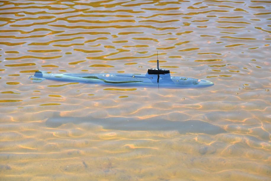

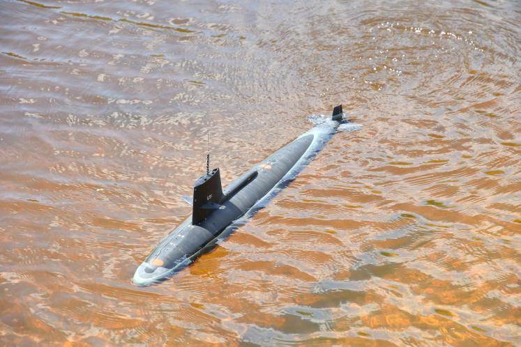

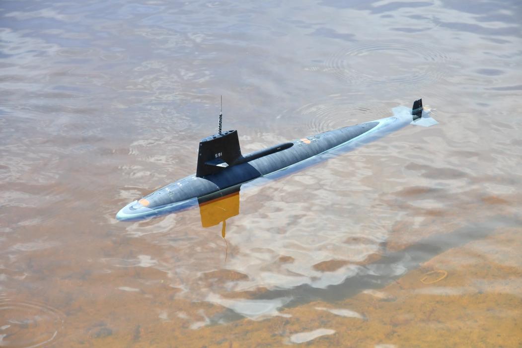

          • 14014
          Beautiful video David, yeah seems like you might know what ur doing! Hahahahahah
          Once you establish underwater trim (the boat just light enough to stick one-inch of sail into the air with the boat on a zero bubble-angle) then it's a never-ending ****-show of moving selected pieces of foam above/below waterline till, magically, and to your astonishment, the boat will trim out properly in surfaced trim. Stick with it, you'll get there, pal.
