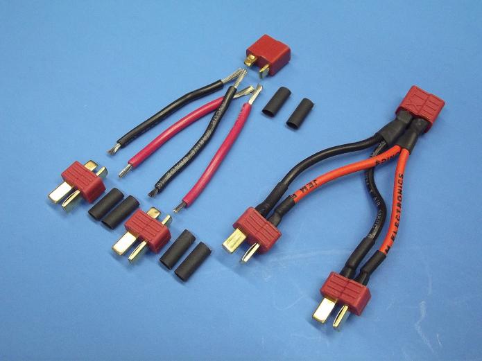

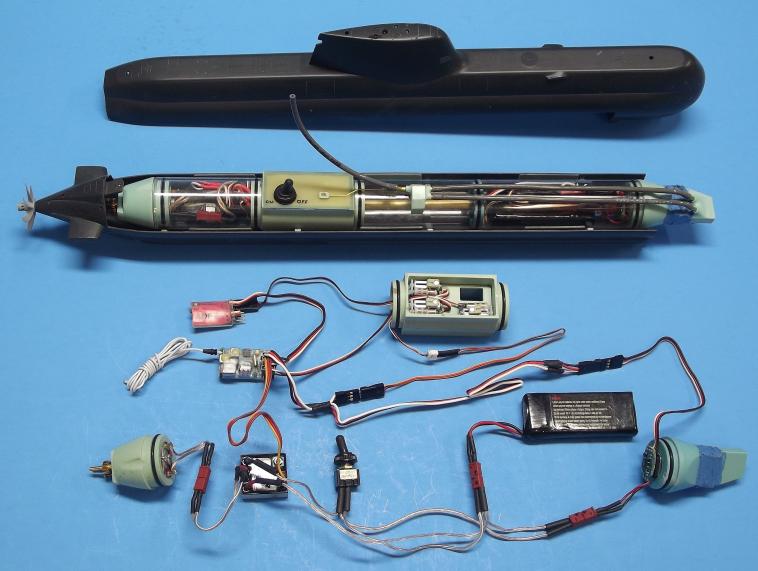

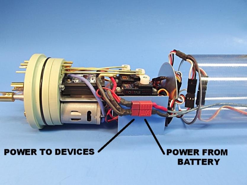

    Depends on the load. Pretty much the maximum current drawn by the motor. Hotel surfaces typically yank no more than an Ampere. If it's a big boat pulling up to 40 Ampere's I'll go with 16 or 18-gauge (I prefer flexible 'silicon' cables, but will use cheap-ass zip-cord if cable flexibility is not a prerequisite.

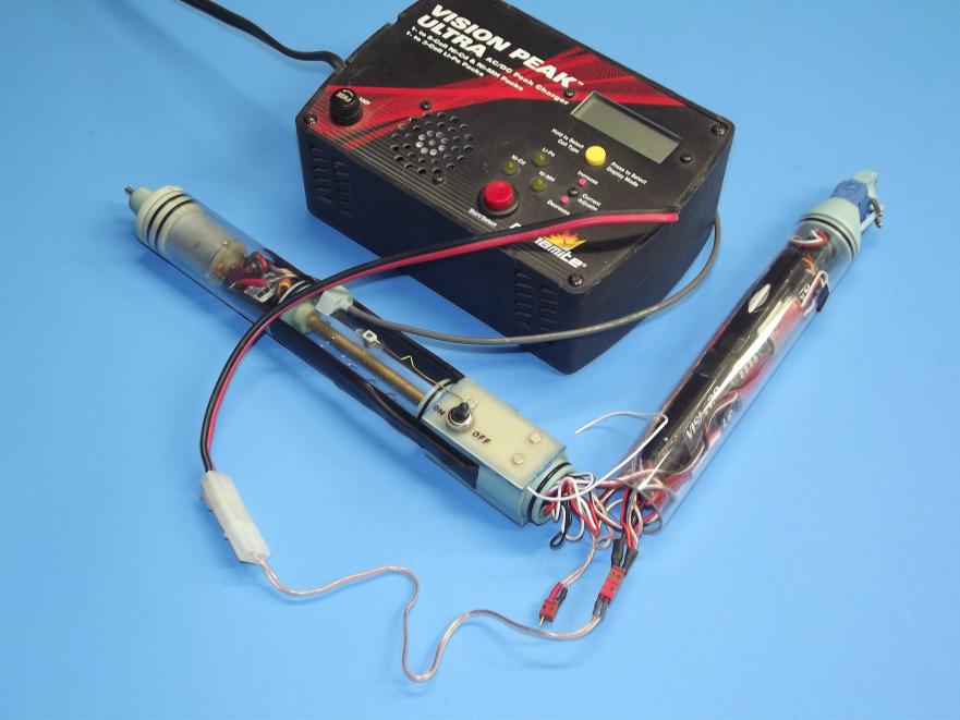

    I've used 22-gauge for small SD's that don't draw more than an Ampere or two.
