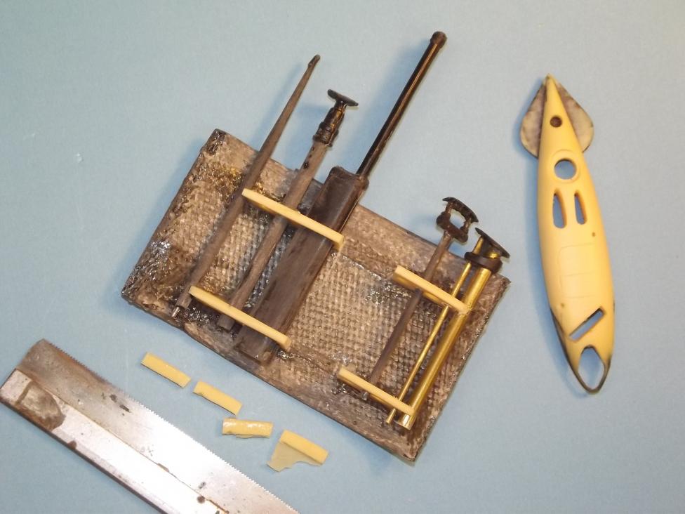

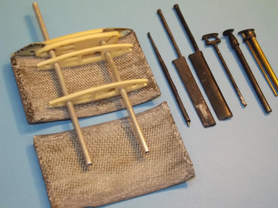

    Incorporate something like this:
ID:	146741Click image for larger version

        If I'm not mistaken the photo is of the sail is of a Thresher class submarine which is relatively small. Is is this a functional mast arrangement? (ie. can be raised or retracted)
          • 13711
          Originally posted by jphatton
          Thanks for the recommendations, much appreciated.
          No. Not that one. But the arrangement is a precursor to a practical retractable mast array. Just one way to skin the cat. There are others.
