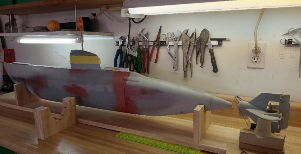

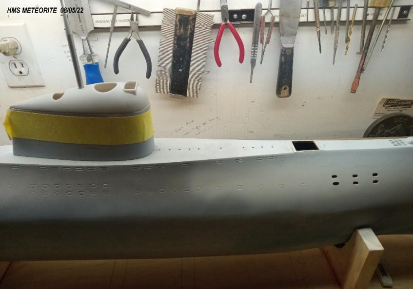

    Todays work above.... Mahogany decking CA glued to under frame. Wood painted and sealed. I saw a little cap on a primaer paint can nozzle about 2 mm square that will make a nice little bridge crew urinal - you peed into the funnel and it washed away under the casing into the sea. A gimballed compass and some gages, cable conduits and all ready to slide the fair water (pre painted inside) over the deck. The periscope will be fixed (not raising or lowering) but it has a metal thread I added to screw the periscope mast inti the hull and remove for transport.
    The fair water needs a cable track for a tow line release, the side railings and arriving soon, the new brass 3 d printed side name plates for the boat to be added after the boat is near done.

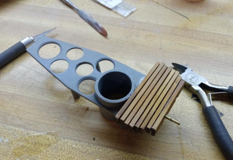

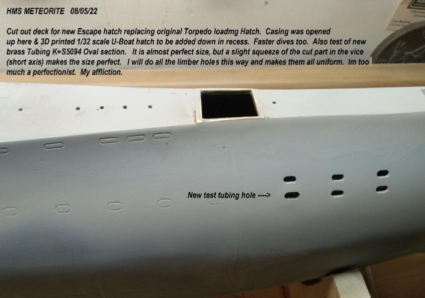

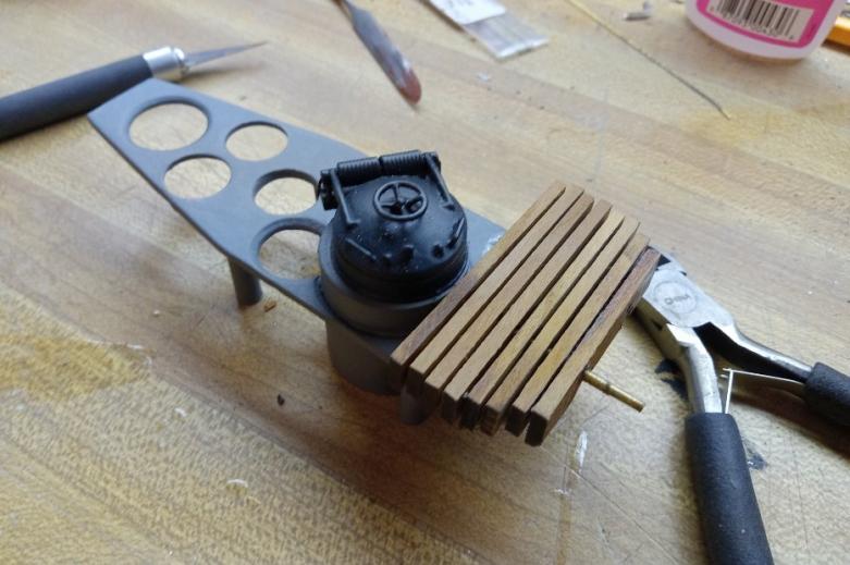

    Mahogany decking laid down in sections after set and glued in my fixture first. Laid athwartships per plans. A 3D Printed 1/32 scale hinged U-Boat hatch placed on top from Shapeways.

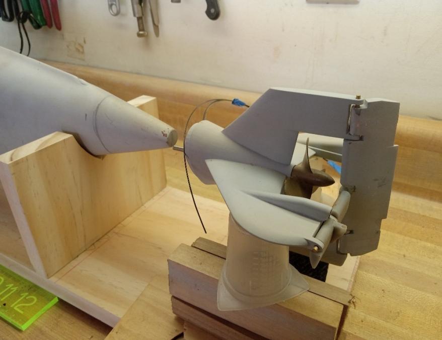

    replied
    Steve,
    Thanks for the info about the decking and the props, i'll leave my decking as it is, will adress some attention to my prop the get the steel look.

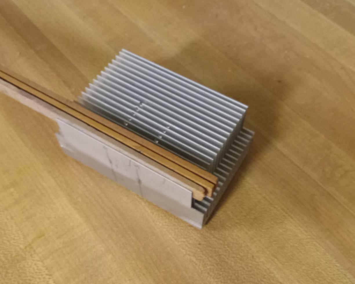

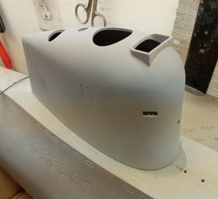

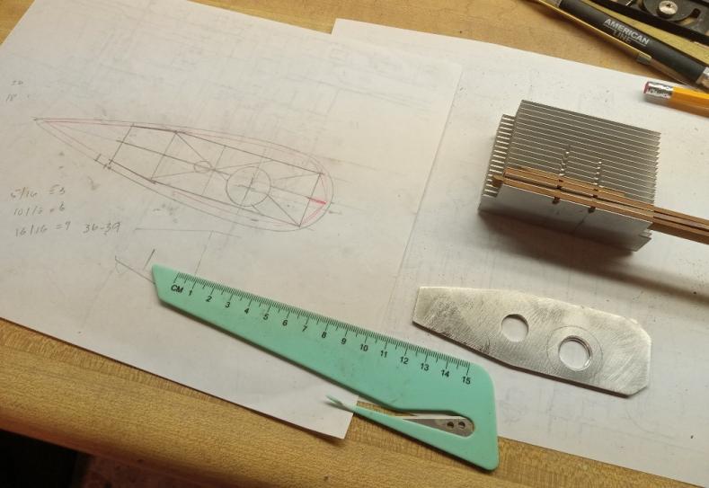

    Added the new 3 D printed fairwater top. Epoxied puttied, sanded primed. Added boats horn, flag jack staff, and battery ventilation vent. I struck on a idea from 'stuff' just around the shop. Using a computer radiator as a fixture to hold 2 mm thick mahogany wood strips in place for the new athwartships fairwater bridge planking. I drilled holes and a slot perpendicular to the slots to drill in pins and spacers. Will see if this works. Looks like it will work good so far. Sometimes a lot is just making up stuff on the spot. I dug through my old correspondence from the early 2000's or ninety's & found a letter (remember letters?) regarding the decking from U-boot expert Walter Cloots. He confirms then the Prop on the Type XVIIB and meteorite was steel, and the decking was indeed oriented athwartships. So there we have it.
    Building slowly proceeding each day.

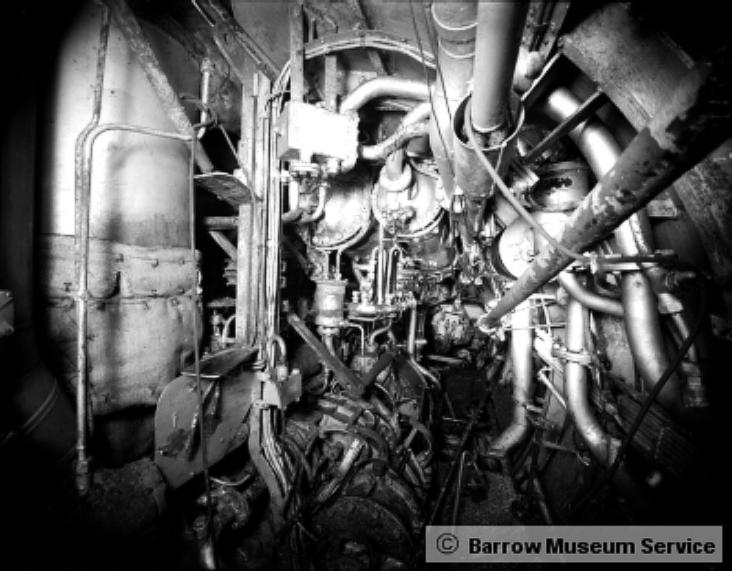

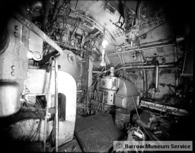

    This is interior survey photos from the Barrow Museum Barrow In Furness Of U-1407 at Barrow after the war before being cleaned up and altered.
    Top photo shows the forward facing helm controls suspended from above. Second from top photo is of the engine spaces. Third photo is after most part of the control space showing the bulk head to the aft engine spaces. Fourth photo shows the torpedo tubes forward. The bottom is the open space from forward looking aft. The hanging suspended fixture in s center right is the boats helm controls.
