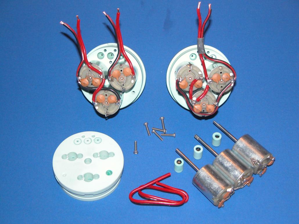

      • 13967
      A minimum of two cap's per motor, each made up to a motor pole and motor can (ground).
      Between 0.01 - 0.1 micro-Farad. Ceramic type.
