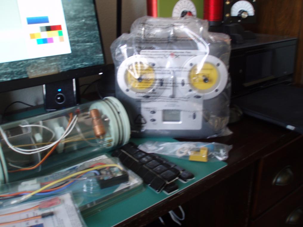

    Hi Leaky,
    My opinion is to check out Nautilus Drydocks! Look at the vEx 6channel FM transmitter and 6 channel receiver. I have the vex system and it is working great for me. Also it is priced very reasonably! Give it a look on Nautilus Drydocks.com (Bob Martin) is the man if you have any questions. Very honest and helpful!!

      Can that be changed to 40mhz? 75mhz is illegal in Britain.
        Dave,
        I am not sure on that! Perhaps someone here could pop-up with the correct information on your question.

          No you cant change the Vex to 40mhz. I thought 35 and 40 mhz was legal in the UK? You will have to buy a older 6 or 8 channel 40mhz radio on ebay. they pop on ebay UK from time to time
            • 2642
            35mhz reserved for model aircraft in the UK. 27, 40 and 458/459mhz is legal for use in the UK. 40mhz transmitters only really available secondhand now or NOS, if you can find one. 458mhz open Lrs equipment cheap from Hobbyking. A JR module with receiver costs under twenty quid. you can use these with nice up-to-date transmitters like Frsky Taranis or Jumper 16 sets. Unlike in the US you don't need a HAM license to run this frequency. Doesn't penetrate as far as 40mhz, but unlikely to be a problem unless you habitually like to explore the deep end of swimming pools. Has sufficient bandwidth to permit frequency hopping, so you don't have to worry about a frequency slot.
