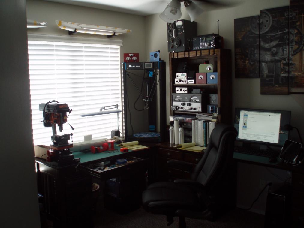

        Air brushing equipment? Here is my indoor small shop situation. There are times an airbrush would have done a much better job of finish trim work than using a brush. I am looking for a system that will be somewhat quite (my wife's office is right next to my 200 square foot hobby room)

        I will NOT be using any solvent base paints, only water base! As a Firefighter (many years ago) we had day's off, so we where able to start up a small wood working business on the side. I did all custom builds (entertainment centers, book cases, & custom furniture) I had a full size commercial spray booth and complete compressor driven spray equipment. So I do know the in's and out's of finishing fine woods. That all being said! I have never had nor used an airbrush system!
        Seeking advice here on a QUITE compressor with reserve air tank and the type of airbrush you would recommend, and along with that if any of you are using a small desk top spray booth?

          I'm sorry, but You'll have to use a solvent based paint system. The current chemistry, the one in vogue today -- even in the automotive coatings industry -- employs this planets most reactive, universal solvent. Water!
          You want quiet? I got your quiet! Go to the fire-house and have them bang up a fire-extinguisher bottle with 15 lbs. of CO2. Buy a single-stage Williams regulator, get the associated fittings, and slap it all together and presto-chango: you have your super-quiet gas source to drive your air brush/gun. That charge should last you a good year of heavy-duty model painting. No compressor, no volume tank, no water-particulate trap. Dirt simple, quiet, handy, and minimal foot-print in the shop.
          Only air-brush you'll ever need is the Paasche H-model with the #1, #2, and #3 tip.

                  I worked in a FX house with many artists using Air Brushes all day long that were made a little bit more silent by moving the compressor under their desks. with a FoamCore boix built around them, they also had a small tank inline, so the compressor was not constantly running. Its impossible to find a small compressor that is quiet I believe, but the higher quality ones designed for Artists are probibly a bit quieter than most.
