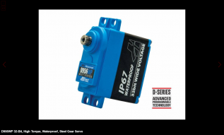

          Here is the industries first IP 67 rated servo by Hitec (and many have followed) ...as they say "Waterproof, not water resistant" priced at just under $50 everywhere. An IP 68 servo will cost hundreds...this servo (or any of its brothers) If mounted upside down, it will hold trapped air and perform just as well as an IP 68 for those "sit on the bottom excursions"
          Click image for larger version  Name:	Screenshot (132).png Views:	0 Size:	37.3 KB ID:	136272

            Thanks guys. I purchased an IP67 HiTek, altho god only knows if its an original, or a Clone. It ended up being $52.00 with Conversion from Canadian....we shall see, but I will be mounting it upside-down, like suggested by more skilled Mariners than myself.
