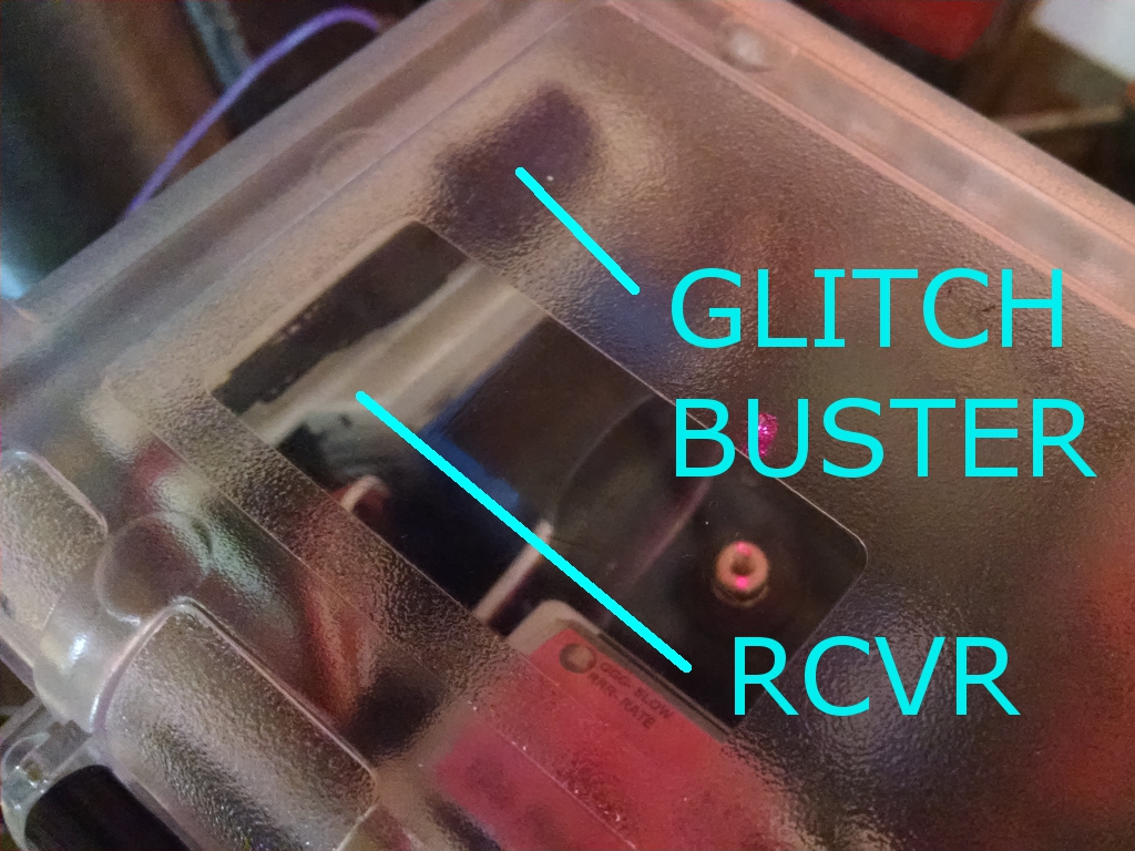

              I made my own for my Teskey PROTEUS WTC (WIP). Went with a 2200uf 6.3V Electrolytic Cap (Mfr P/N ECA-0JM222) after I found out what was actually being used in the NOVAK .
              I plug it in the old RX Battery Port since I get power from my ESC's. If that's not available either any unused channel, OR piggy back it onto a servo connector.
              Here it is in the closed Water Tight Compartment: Click image for larger version  Name:	GB01.jpg Views:	1 Size:	493.1 KB ID:	122919

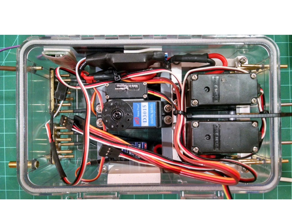

              As you can see from this earlier picture of the WTC partially assembled, it is quite congested already in order to have all the functions I wanted.
              With all that going on, a "Glitch Buster" was warranted. Click image for larger version  Name:	GB02.jpg Views:	1 Size:	447.2 KB ID:	122920
