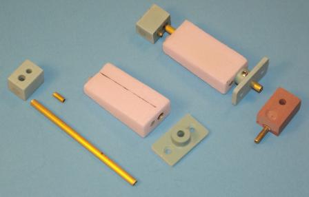

    I wonder if pultruded carbon fibre tubing would provide a maintenance free solution- carbon is fairly slippery. Plus lighter than brass- win, win?
      One important property of the brass tube is its weight (I'm talking the tube in the float), the float has to be heavy enough to break the vacuum between snorkel induction head and the sealing rubber element atop the float when the sail broaches the surface after starting the blow completely submerged.
      Part of the production process here it to lap the snorkel induction tube and float liner tube to insure a sloppy non-interference fit.
